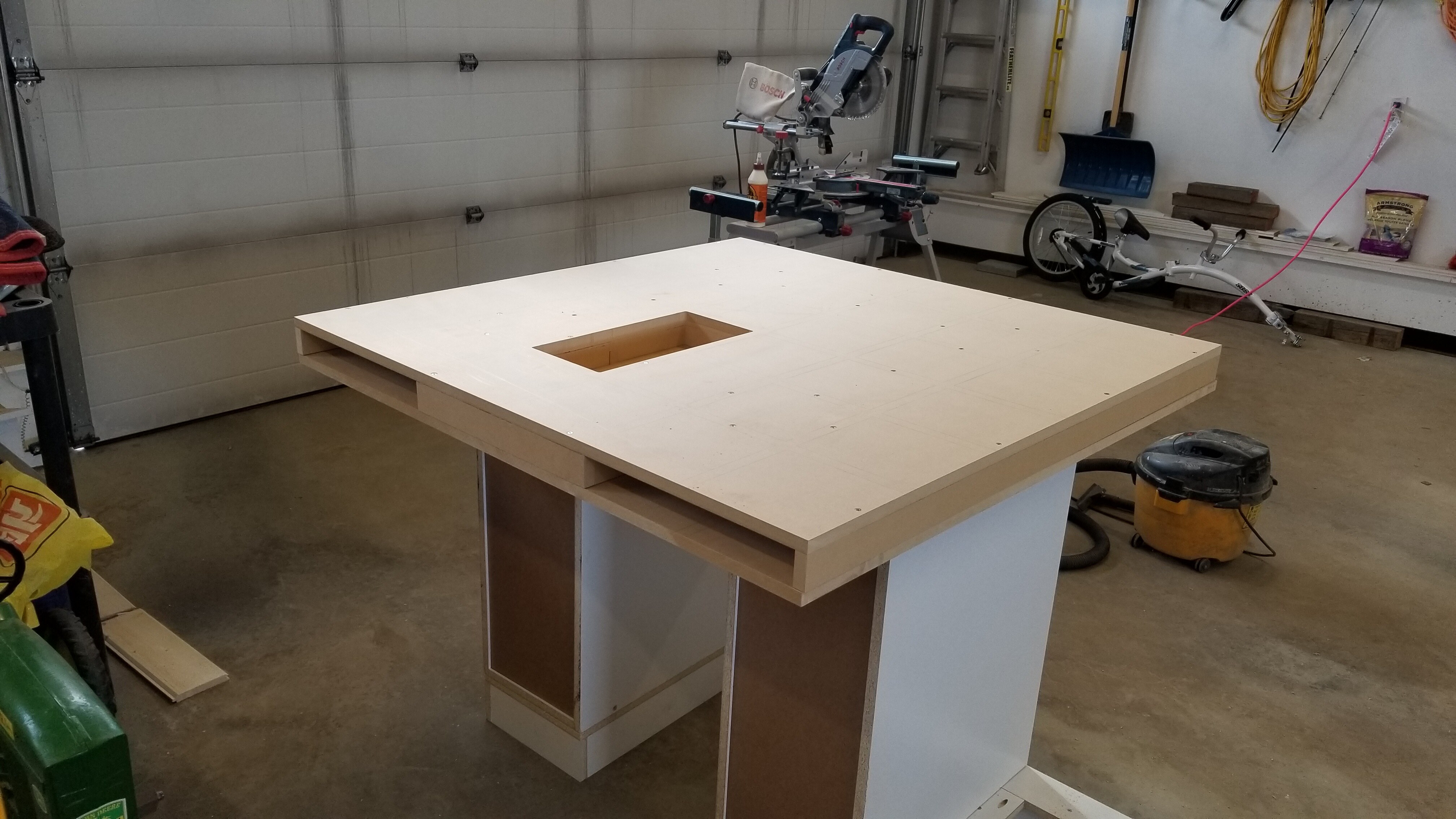

What are your plans for a table?
You now got me thinking about the bottom shelf where I was also thinking of using MDF. While I have the torsion box for the top, I don’t have anything really supporting the bottom shelf. At a little under 5’ that is most likely to start sagging. Now I need to rethink the bottom…
Just to add my 2 cents…
Get the bottom shelf up if of the floor 10 to 12 inches. This gives space to store a few items underneath it all.
I have two low profile totes with lids and a few pieces of stock on the floor. As long as I roll the table straight back (or move the totes first) when I need to get to the rear of the table, it’s no worries and I need the additional space.
@Swinly I don’t see where you have a torsion box for the top. With all the bracing that you have, though, I don’t believe that you need one, either. I will respectfully disagree with Wally on the position of the bottom shelf. No offence, Wally. I have to roll my table frequently to get access to cabinets that line the walls of my basement shop. Storing anything under the shelf would be a real nuisance. That said, YMMV.
I don’t see what you have to gain by having your table top overhanging the supporting frame. Since you will be mounting the Mill inside the overhang, it just means that you have further to lean over to reach the X gantry. Overhang on the left side will give you more space to mount the electronics, but at 60" wide, you have more than enough room without that overhang, too.
Are those drawers in the front? That’s a good plan for bits and bobs storage. You can also mount a drawer unit sitting on the bottom shelf. You have a lot of space under that table, so you may as well make the best of it.
Hello Swingly! Take a special care on the top to be perfect square in every way it will worth it when you’ll install the longmill , it’ll be a breeze to have it leveled. On mine i put a 10" lg brace in every corner at the top and at the shelf and i also put wheels so really easy to move it from point A to point B if you need to.
For the table top i add two layer of 5/8 thick Mdf screwed together in alternate direction (1st layer from right to left and 2nd layer perpendicular to the first layer ) this add more rigidity .
Thanks for all the input…
@gwilki you have a great point about the overhang I put in it. If I only adjust the top it’ll bring it down to 43.5" x 55.5", I think I can live with that if the Longmill can. I also agree about not storing anything under the shelf on the floor. While the table will have a permanent spot in my shop, it will be moved around quite a bit like my other tables.
A drawer unit was what I had originally envisioned but really couldn’t decide so I went with the two drawers up top for bits and whatnot. The drawer unit may still come but at a later date.

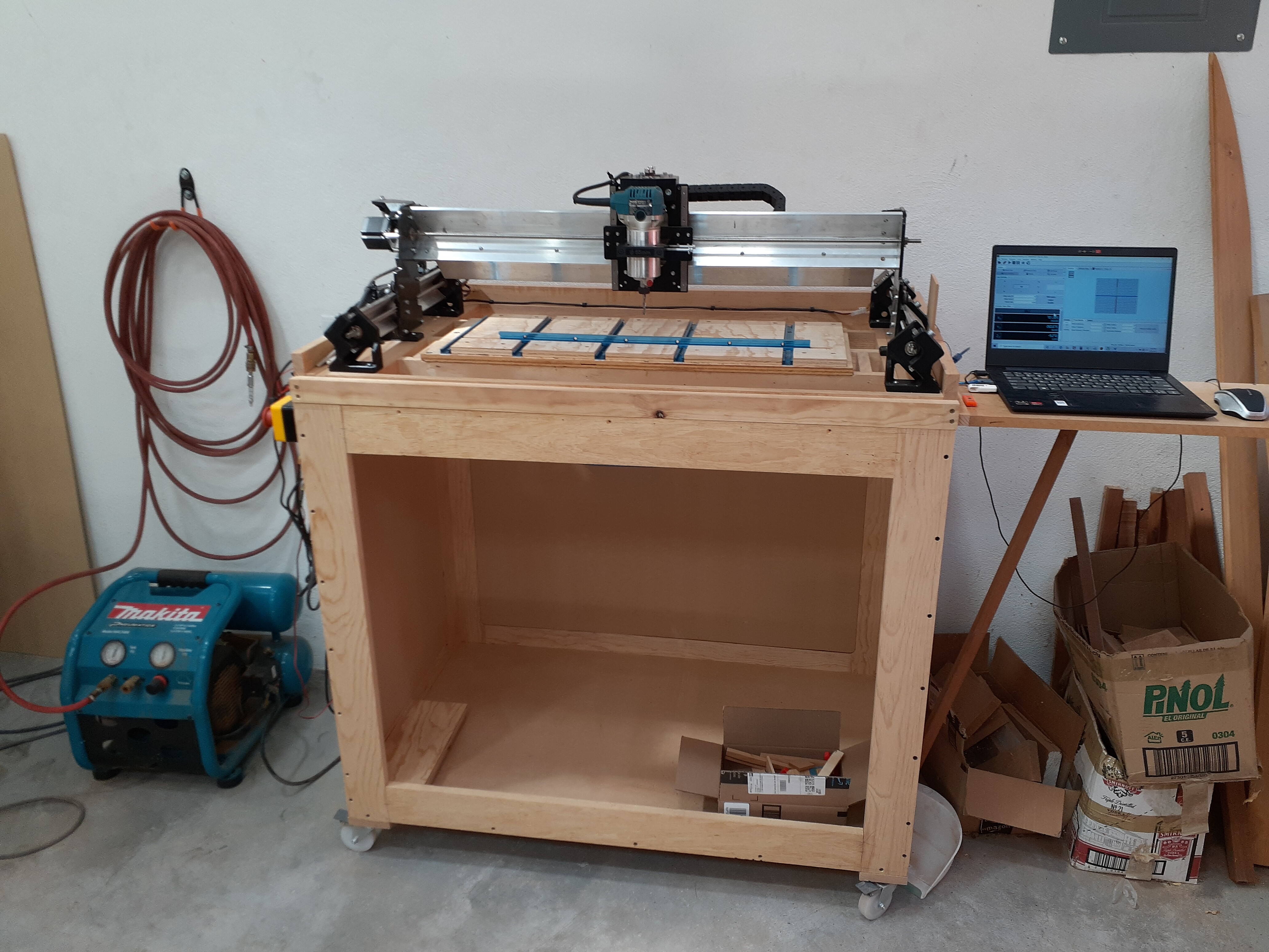

Here is my stab at a workstation for my 12x30 LongMill. Has a foldable table for my laptop and wheels for mobility. I also left room at the near Y axis so I can mill board vertically. I do mostly joinery on my machineb. https://drive.google.com/drive/u/0/folders/0B228IEWSn74XLUl6V3NJUktLYzA. Next phase…dust management and full enclosure.

Mark, as described several times previously, I and others have put 3/4" MDF under the mounting feet. It gives you more vertical space under the router, but depending on how many layers of waste board you use can force you to mount the router lower in the clamp, which can increase the flex in the system. The pluses and minuses are described in previous posts.
Thanks, I went with 3/4 inch over 2x4 frame for the tabletop then the spoil board extends to the feet so I maximize my router height.
