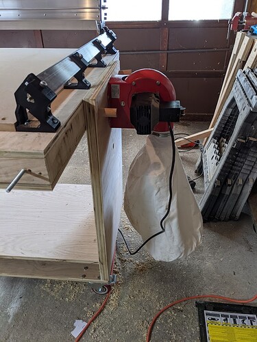

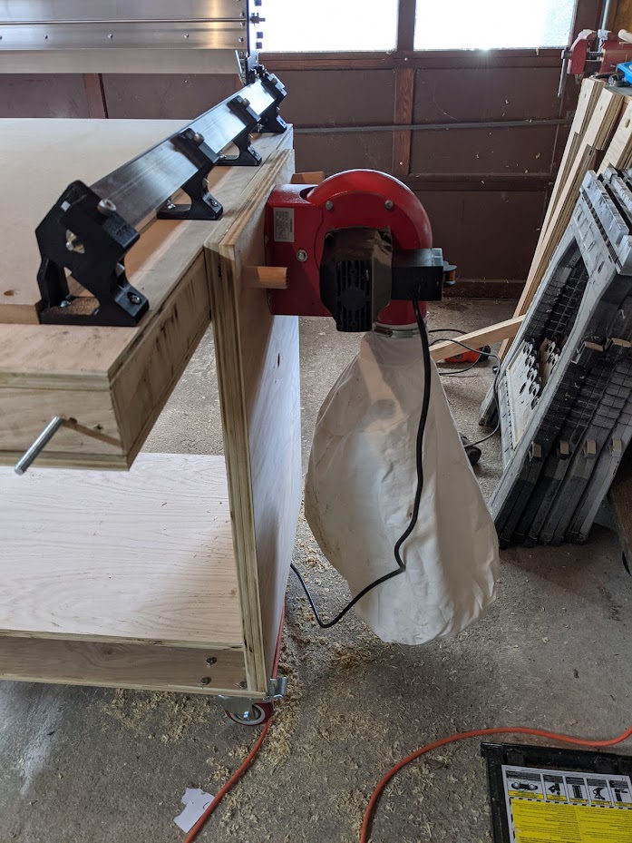

I ended up making the Fisher rotating table but I modified it a bit. For one I didn’t like the idea of having the power inside the table. Two I squared up the right side of the table ends. The plans want you to cut it in a triangle shape but I made it square. Also I made the legs as the plan said but later changed the plan. I used oak dow to make pins to hold the table in it’s position. And finally I added a harbor freight dust collector to the right side. Still waiting for my 4inch hose and reducer to come in.

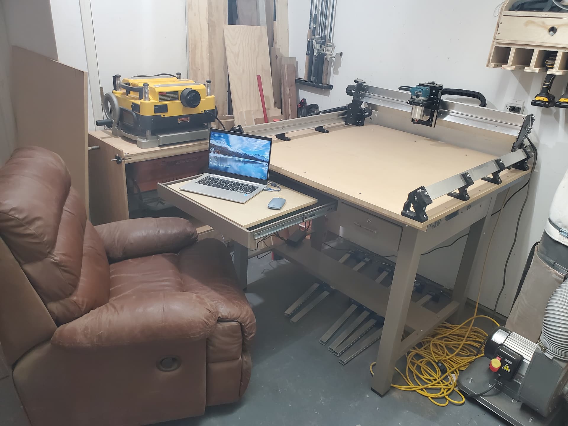

I found a drafting table on marketplace for free. A few minor adjustments and ta da! Solid table with drawers for free. There seems to be lots of drafting tables cheap or free near me. Brand new to this but the table seems sturdy and dead flat. 20210913_201337|666x500

I’ve mentioned this before but I think it may be worth mentioning again. I found a drafting table on marketplace for free. I often see them on there for very very reasonable prices. They work great as a table for the longmill. I mounted 3/4" MDF to the top of the table and mounted the machine to that. I then cut an additional piece of MDF to fit between the arms of the machine. This reduces the depth slightly but gives the table a little more weight and stability. The control box I mounted to the side. I have a full T track system with clamps I have yet to install. Plan is to get comfortable with the machine and then add those. Don’t want to run bits into them and im still learning.
Please excuse the mess. I have 5 projects on the go at the moment. Saturday mornings are clean the shop time.

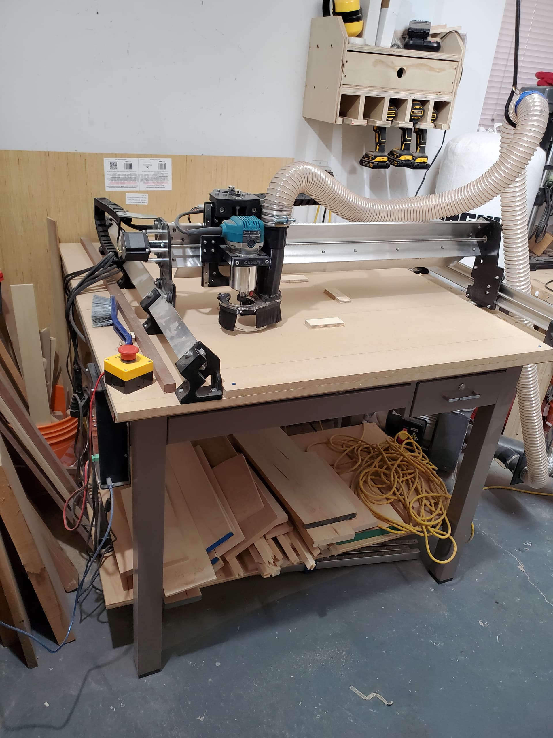

Noting fancy. Got into woodworking 3 years ago when I retired. Mostly building and selling farmhouse dinning tables from my garage. So the longmill will be a new addition to my shop. There will be a new sheriff in my shop soon. The table measures 50"wide by 93" long.

I would have to go measure which I can do a little later today. I made my table four feet square, but you could probably got down a bit on the size,but not much. I have the right rail on my machine up at the edge, the left rail has maybe 6 inches of extra space. I have my control box under the table. The back on the machine also has a few extra inches of room but less than the sides.
Having the table be 4x4 is probably easiest from a construction standpoint, unless you really, really are tight on space.
