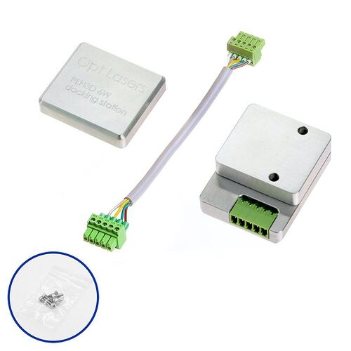

Here is a video of a CNC user laser engraving Stainless Steel with a 6 watt laser connected to his CNC This may put you in the right direction when it comes to engraving SS or any other metals.
Here is the laser that is being used in the video.
I originally thought of using that company’s laser with the MK2 as it connects with a magnetic base and is removable for CNC router/spindle work. But opt’ed to go with the Sienci Laser as I am new to the CNC and Laser usage and wanted to get all my support from one place.
EDIT : And a huge Hint to the designers at Sienci Can we get something from Sienci in the future like this just asking for myself and maybe other.
