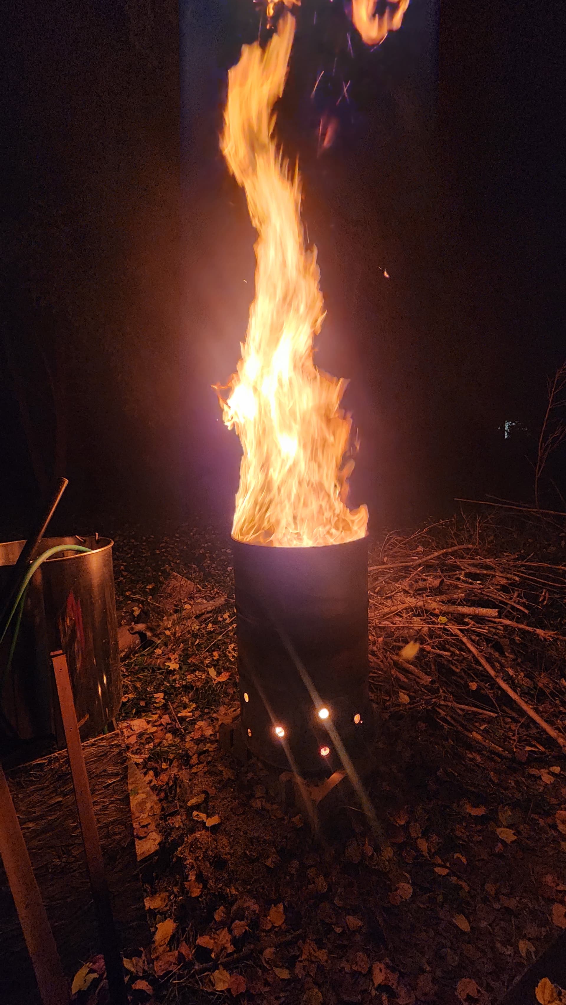

This picture was taken burning about 50lbs (due to me letting the DC get way too full). I loaded the bottom of the barrel with cardboard and wood scraps. Took a minute to get going but eventually took off. I know better than to dump in while burning. I designed the burn barrel with sawdust in mind.
Oh wow! I made my bride a burn barrel with plenty of ventilation designed to sit on some fireplace bricks we got from my father in law. I never, ever thought of that Kerry! Shoot, I’ll give that a try. It even looks fun, just bring a lawn chair. Might be a good way to get rid of excess junk wood that I keep filling up boxes in the shop with too. Thanks sir!
The design was mostly about big vent holes in the bottom 12 inches and no further up the barrel. Once the fire gets burning it eventually starts a serous chimney draw pulling in tons of air through the vents. There are 1.25” holes in a star pattern on the bottom as well as the ones you can see. It is sitting on 3 cinder blocks.
