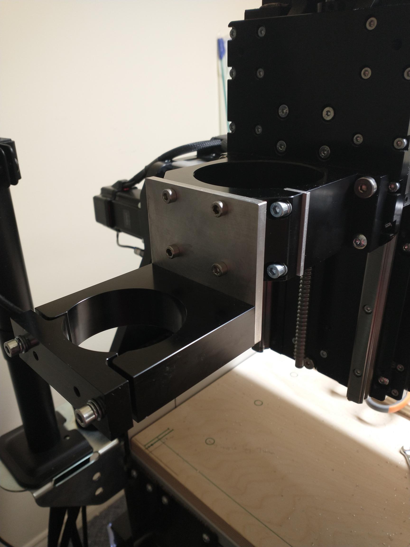

In the meantime, I set up my Altmill to use a Makita clone trim router (Benchmark from Home Hardware). I purchased the Longmill router mount from Sienci and attached it to the spindle mount on the Altmill. The mounting plate is 1/4" aluminum whereas the shim that fits in the gap of the Altmill mount is 1/8" aluminum.

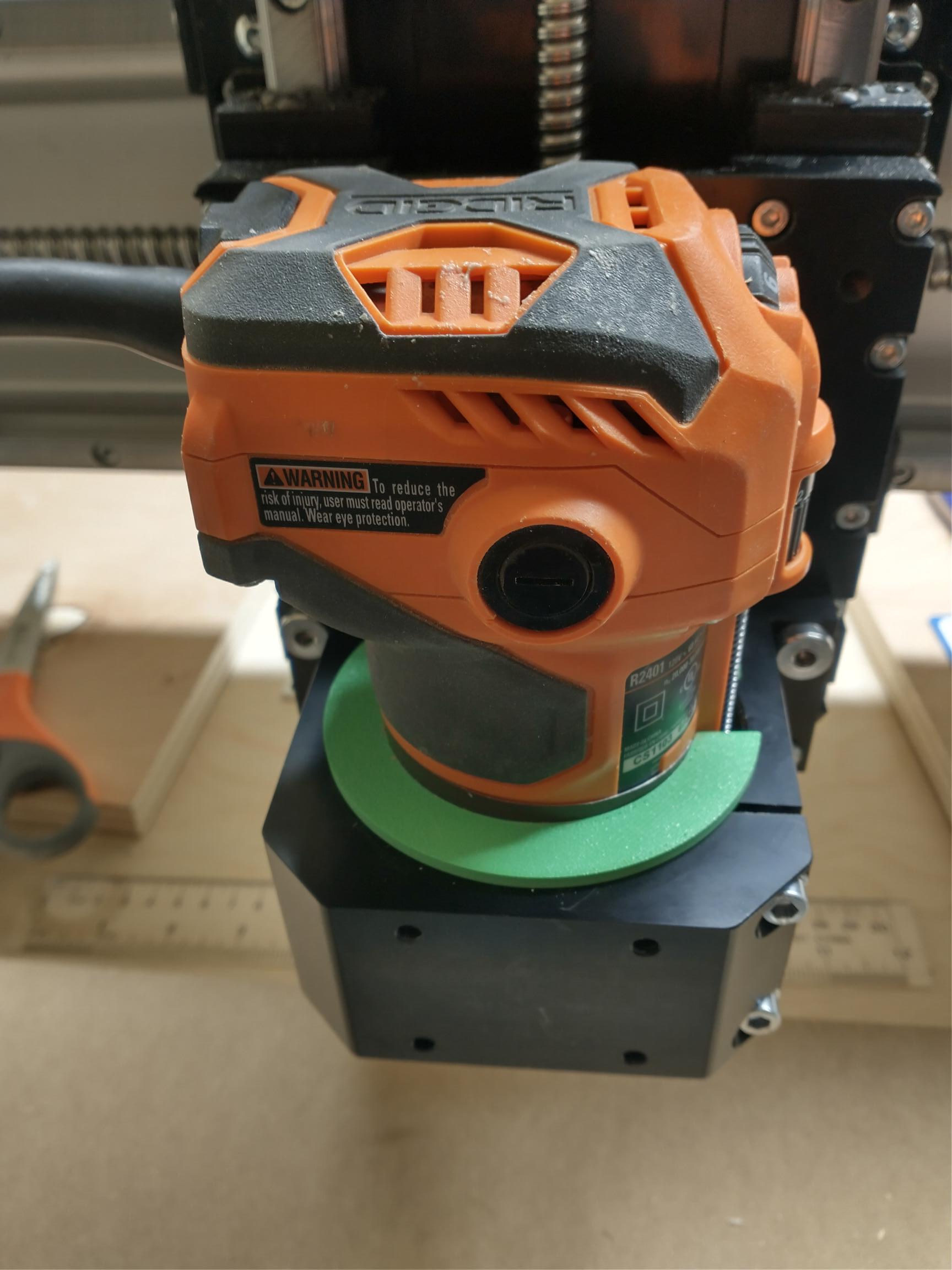

Both parts milled using the Altmill and my Ridgid router. That router fits inside the Altmill mount with the use of 80mm to 61mm reducing sleeve 3D printed by one of this forum’s members (@gwilki). Unfortunately, the Ridgid router has a shoulder at the top of the body. As a result, it can’t sit low enough in the mount and bits are 2" off my wasteboard. To mill the parts, I had to use blocking to raise the aluminum.
The 65mm mount attached to the spindle mount:
And the Ridgid router and green sleeve
Since the trim router sits about 4" in front of the spindle, it actually extends in front of the table. So using @Jens method of vertical milling, I can use this setup to do dovetails or finger joints on the ends of longer boards.
