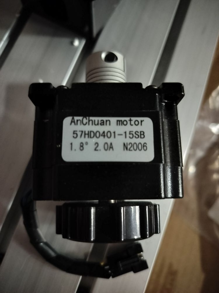

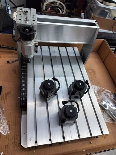

I have an older Chinese 3040. The build quality is surprisingly robust. But because it was a knockoff that used pirated software, I only got it to work on two jobs. I’d like to resurrect it. Will the SLB run it? What about the SLB EXT? What else would I need to get it to work - a probe? It’s got a 4th axis attachment too, but I don’t absolutely need that to work (it would be nice, but not necessary). Anything else? Thanks for all your help!

The SLB-EXT is for closed loop steppers and is highly unlikely to be compatible with your equipment. The SLB might be compatible but somebody else needs to provide more input.

As @Jens said, it’s unlikely that those are closed-loop steppers so you do not want the SLB-EXT. You should confirm the the motors are open loop before deciding on the controller.
Whatever controllers you choose, you will need appropriate cabling from it to your motors.

I do not believe they are closed loop steppers; it would be nice if there was an easy to find comparison matrix of the 2 controllers on sienci’s shopping site. What’s different between the two besides closed loop? I don’t know. Can I run the EXT in open loop? After all, having a closed loop capable controller for only a few bucks more would be an advantage for the future. But once again, can’t find any info on that. How do I determine the pinout on the SLB for the motors? Is that documented somewhere?

Making cables is not a problem; but sienci doesn’t specify if the motor to board header connectors (or indeed, any header connectors) come with the board in their list of what’s included. The photo shows some populated and some not. Is that what comes with the order? Again, I don’t know.

No, there are no onboard drivers
The board header connectors are specified in the on-line documentation someplace. I don’t know offhand where.
@AlexLTDLX As @Jens said, the SLB-EXT cannot control open loop steppers. The SLB can control open loop stepper for X,Y and Z and a closed loop for A.

Jens - Thanks for the answer on the EXT. I found the connector specs, and can order them from several sources. But I can’t find whether they come with the SLB or not.

Either way, I went ahead and ordered an SLB yesterday. In the notes I asked them to include the connectors for the motors. I remember reading somewhere in their docs that you can do that (but it was for a different connector).
EDIT: As I was typing this, they called me back (I called them yesterday, and we’ve played phone tag). At the very bottom of the SLB page, they mention to do exactly what I did - since it’s all the way at the bottom, I didn’t scroll down far enough. So it appears that everything should be sent out.
