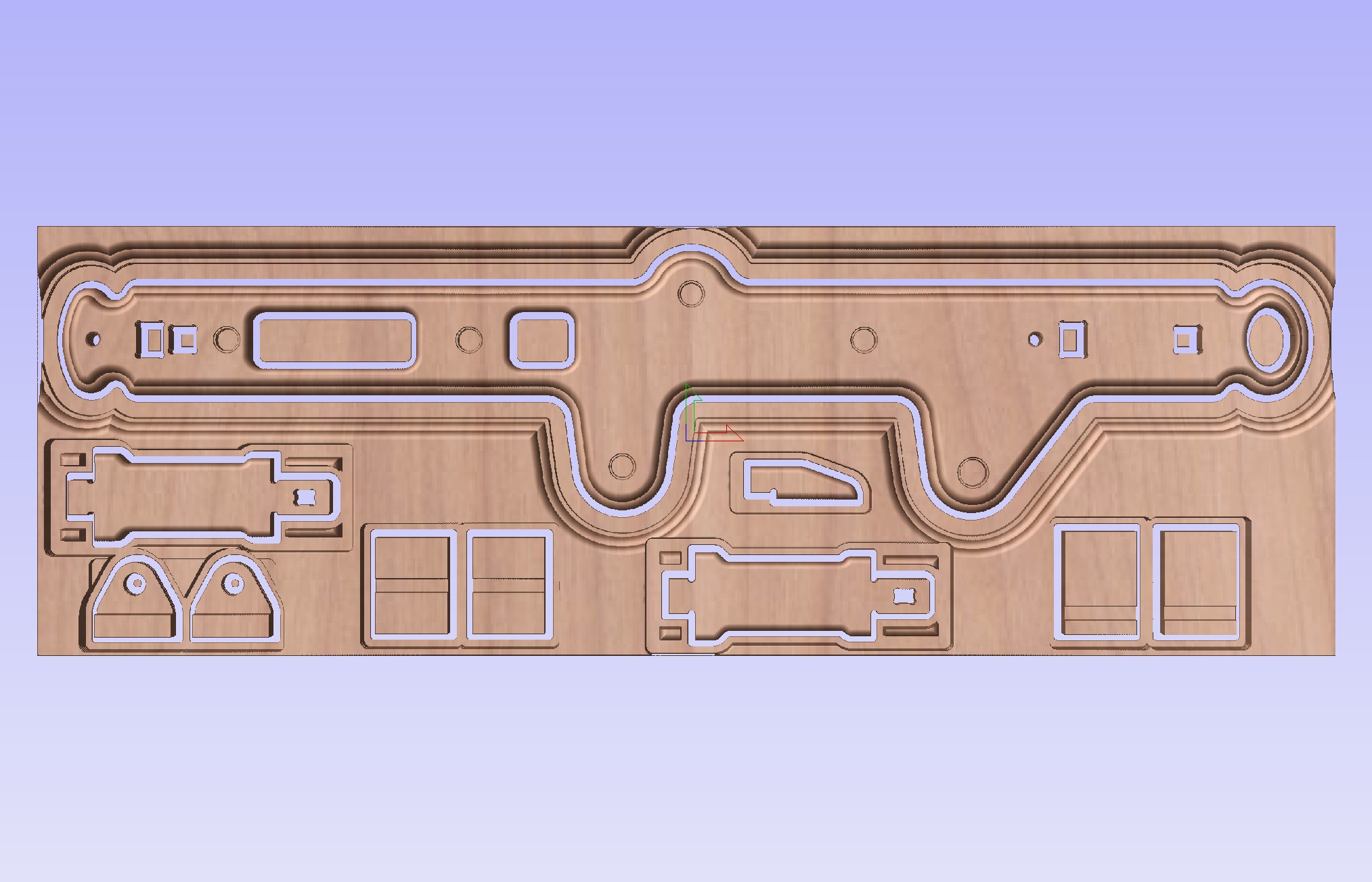

I have made a Brian Law wooden clock, 2 years or so ago. Was a steep learning curve as it was also the first ‘complex’ project made on my CNC (Vectric VCarve, ShapeOKO 3XL), and steep too learning how wood moves once major cuts alter its ‘settled’ state.
Went on to make a Raspberry Pi Nano embedded sensor to collect pendulum swing timings and, with some success, influence the pendulum with magnetic impulses - I embedded a Neodymium magnet in the end of the pendulum rod to do this.

There are CNC’d (or laser) parts, and I made some turned parts. Basic workshop tools all that is required beyond that. Time spent working on cut and finish on the gears, both for accurate dimensions and smooth finish on the teeth, will be helpful and cut down frustrations of sticking or excessively heavy weights needed when the clock is running. Ground steel pins and miniature roller-bearings were the only hardware bought in, aside from your choice of wood.
