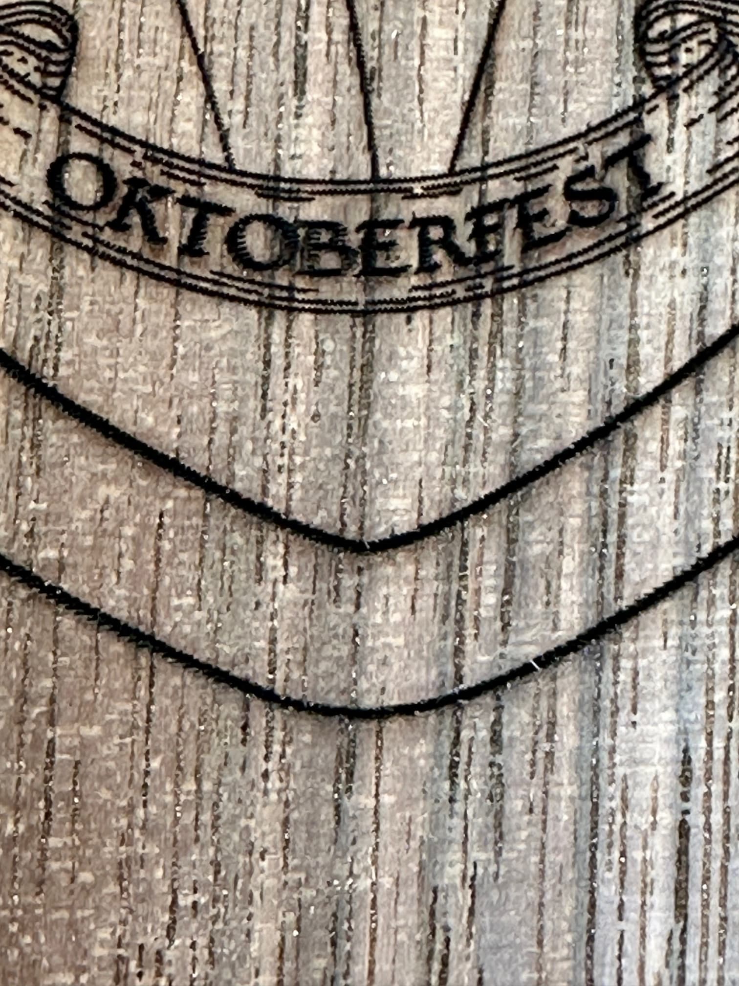

I’m puzzled on this one. I engraved some cutting boards the other week for a friend and noticed the laser is not burning right, the images are distorted/wavy. I have checked the mechanical items:
Changed the backlash nut and adjusted properly
Ran carriage end to end, no binding
Checked the set screws, they are tight
No loose wires
I have a MK1 machine.
I’m at a loss on what could be causing it. Here are some examples:
This is the bottom of an image setup to burn with a cross hatch. This part looks great overall
This is towards the top of the image (about 3 inches later)
You can start to see the double line off in the X direction only. Towards the top the text is terrible

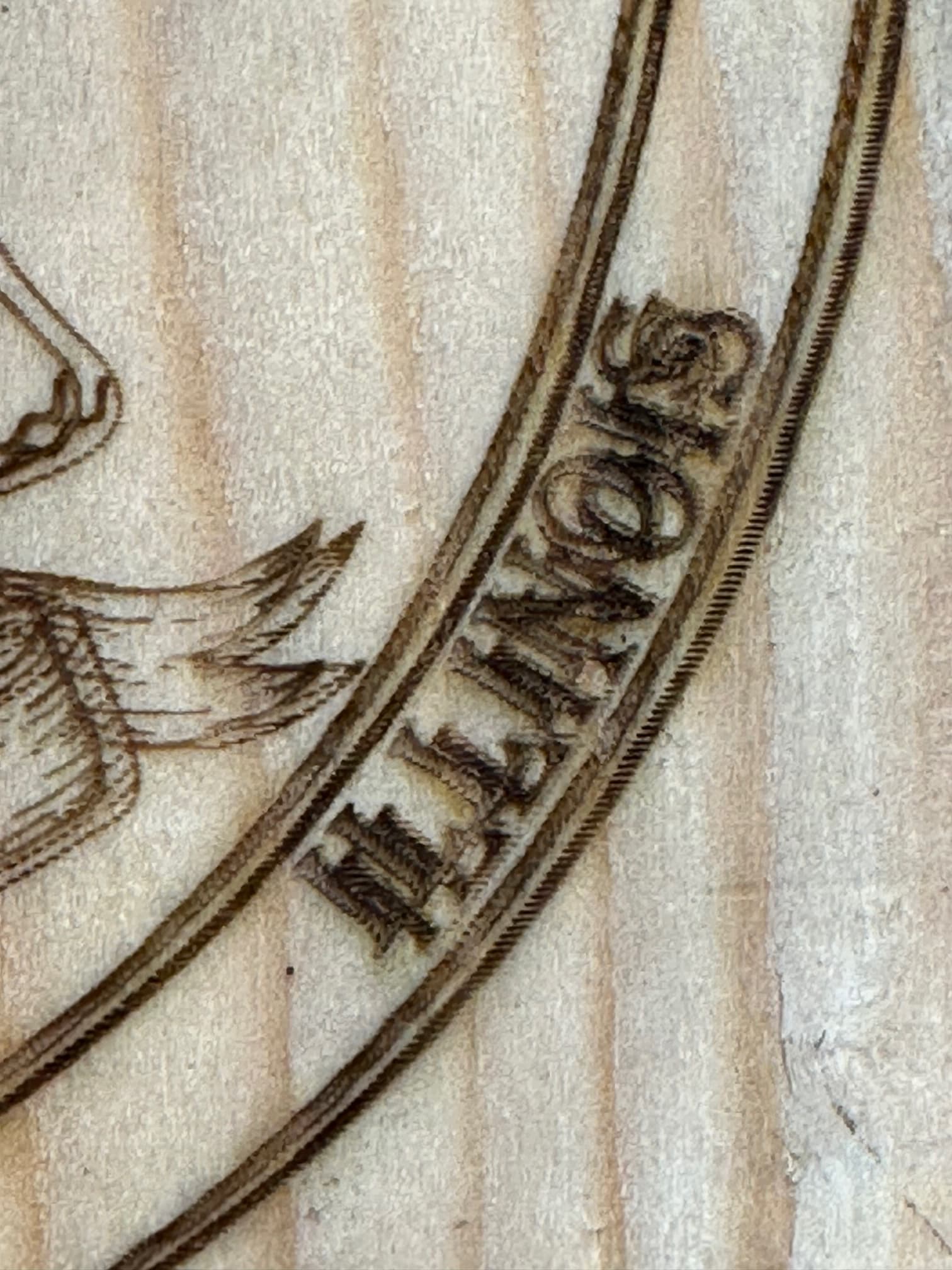

This is another example of an issue. This is a large logo (18 inches in diameter) and I split the logo in half to make it burn faster (less white space to cover). The two halves should have formed a point, but it overlapped, again it seems like only the X is off.
Here is another example, this number is probably 2 inches tall
It seems to wander around as it moves up.
I just tried to adjust the current value/settings to see if that can help. I turned it to 1 o’clock on the potentiometer (1 step higher than it was). After that adjustment, I tried the cross hatch again:
Might have made it worse.
I’m at a loss for what to do next. Any help would be appreciated.
