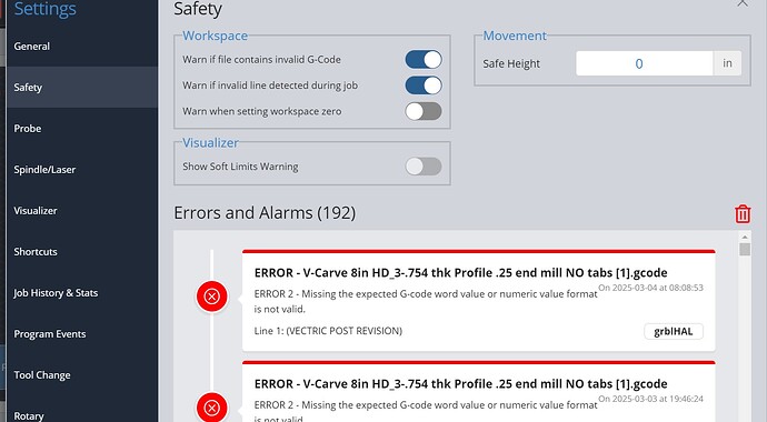

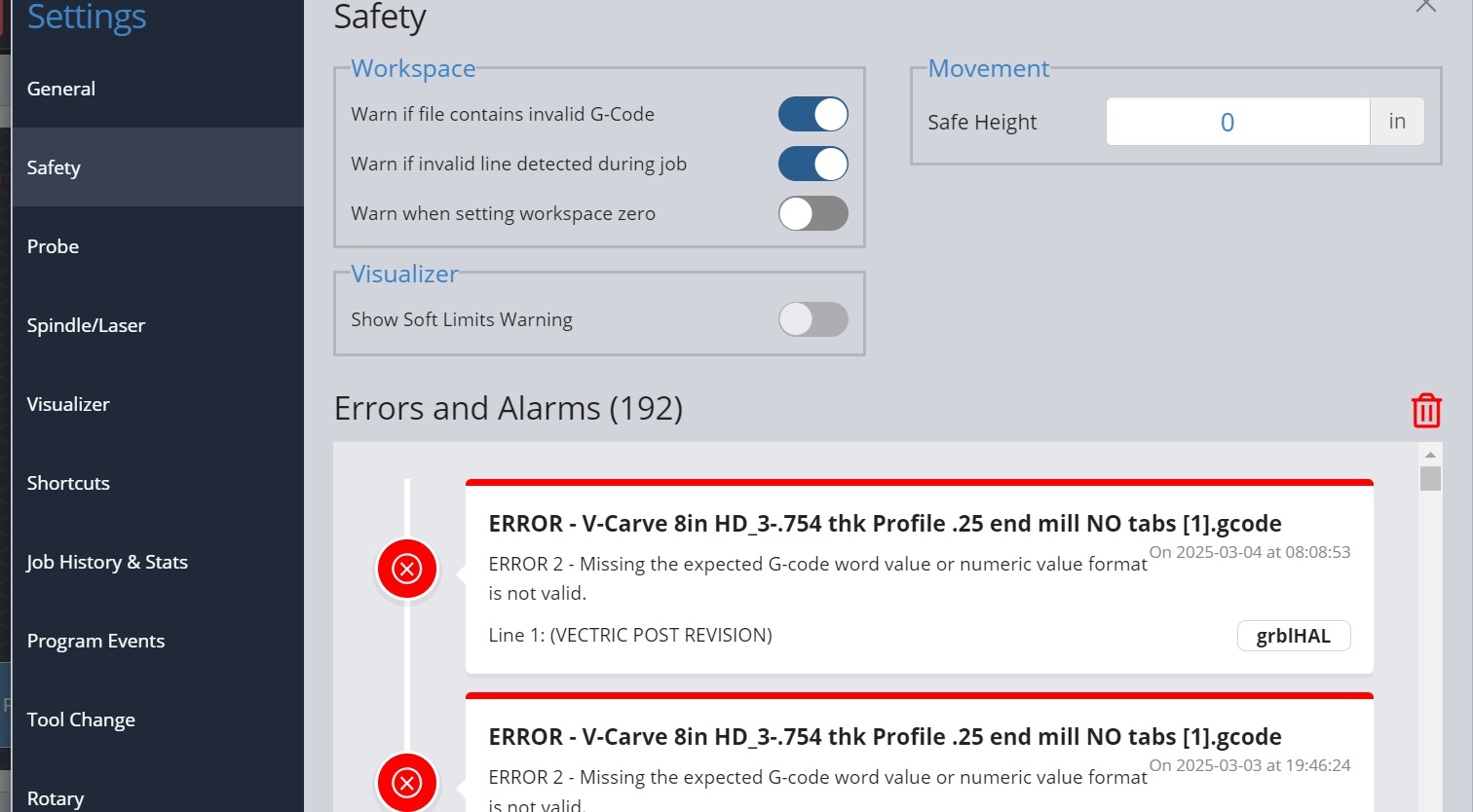

Thanks. After you mentioned that, I thought not a good idea. When I verify the file in gSender connected with grlbHAL, I get an error message (attached.) Maybe this is a Vectric question.
@BrianV That’s odd. It seems to be looking for a gcode value on a comment line. If you post the gcode here, someone may be able to help.
