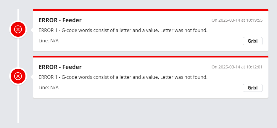

Z and Y axis wont move
I flashed my software and now my Z and Y Azis will not move . Getting this code. Please help
I flashed my firmware not software

You will likely get much more advice if you provide more info:
  1. What machine do you have?
  2. If it is a Sienci machine, what controller are you using - LB or SLB?
  3. What version of gSender you are running?
  4. Did this issue just start or has it been since day one with your machine?
Longmill MK2 48 x 30
SLB controller
Version 1.4.12
This just started. I flashed the GRBL and then after that they stopped working. When powered the Z and Y axis are hard to move. I switched the lines of the Y axis to the X axis and it works.
@richone When you say “I flashed the grbl”, what did you do. That board does not run grbl, it runs grblHal.
That was the issue. When connecting to the control SLB there is an option for GRBL and GRBLhal. The GRBL was selected, I changed to the GRBLHAL and it is all good. Thank you
