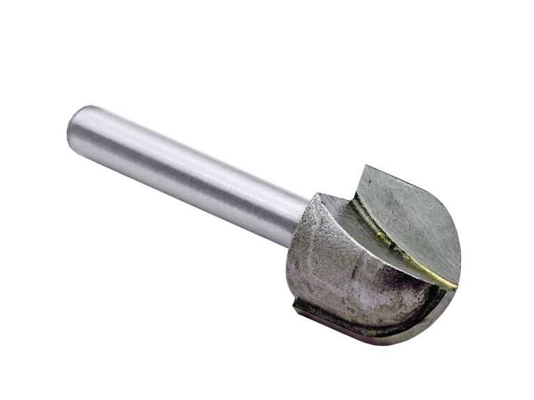

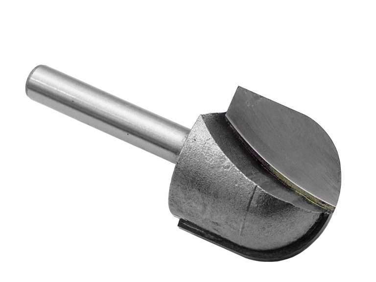

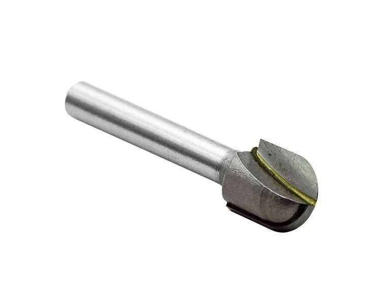

I’m a bit comfused on the ballnose question. Is there something special about your ball nose endmill or does it translate to the bowl bits sienci is selling.
I own the 3/4 and 1inch of these beast and they are awesome. I bet with the right stepover they would work with shaping too.
