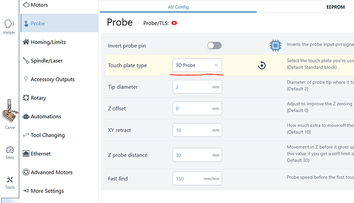

3D Probe Module XY Stepover
Is there a way to set the amount of X/Y travel offset that occurs with the touch probe routine? I have the X/Y value set to zero in the probe settings but it still steps over around 10mm. It hits the soft limits on my machine with a project I am working on.
Thanks
@scuba14c Welcome to the group. What machine do you have and what kind of touch plate are you using?
I have a Genmitsu 3030 ProVer Max. I am using a generic NPN-NC 3D touch probe.

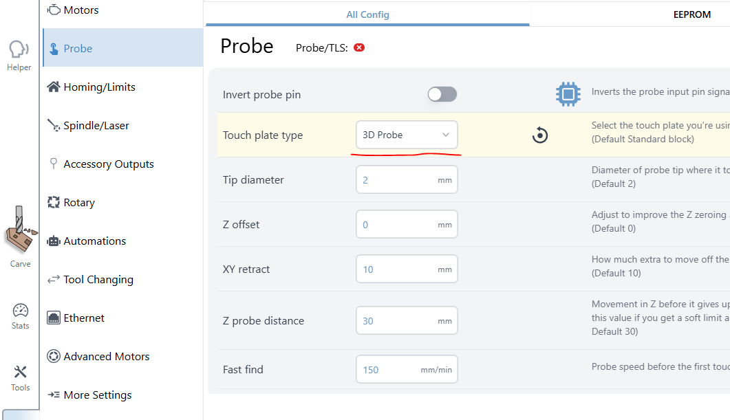

@scuba14c I’d recommend you select the 3D probe option in config since it’ll give you all the extra settings options you’re looking for rather than trying to adapt the ‘Standard block’ profile
