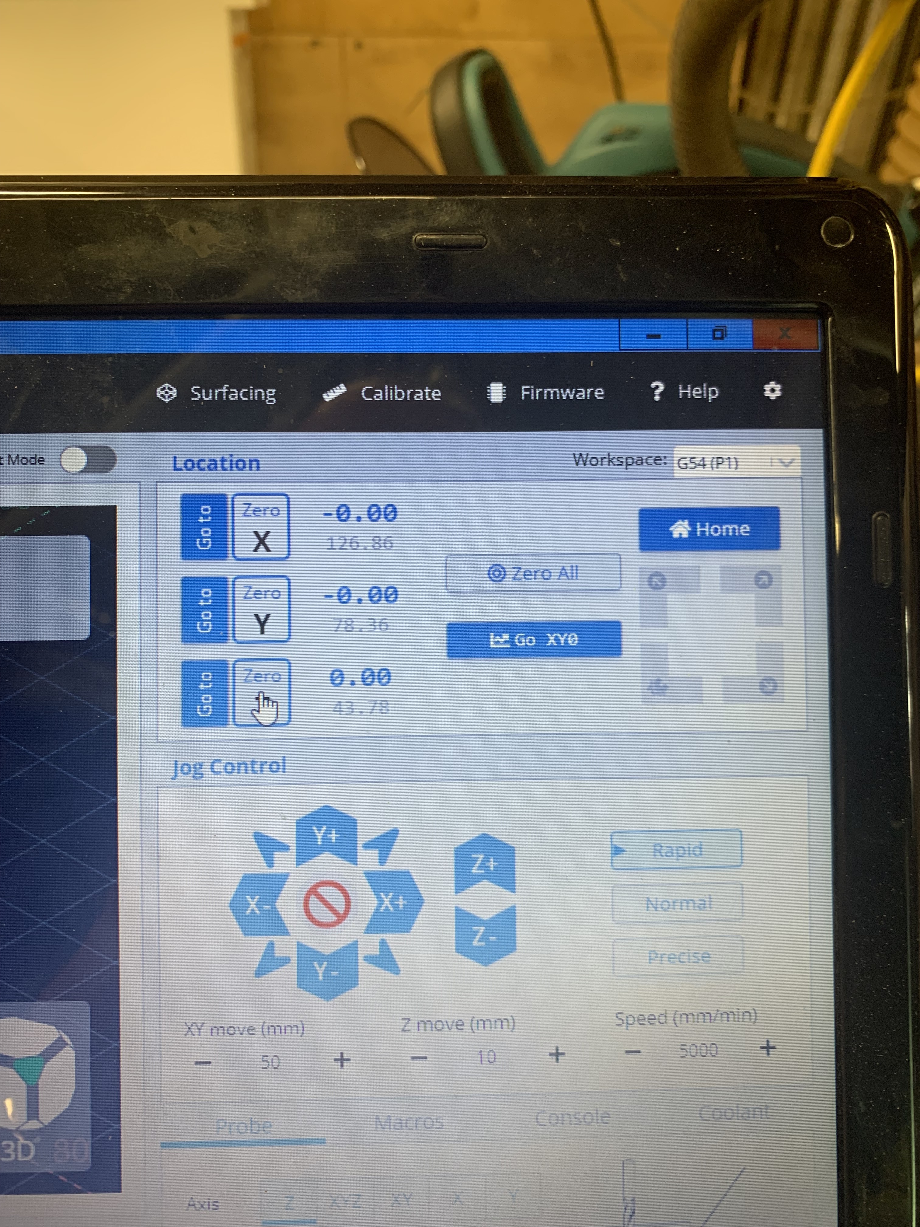

On GSender, UGS etc, there are two sets of numbers for each axis. The small numbers ie. the -795 -600 -5 you are seeing are the machine datum coordinates. (G53). These are the position from the rear right hand corner. The large numbers are the Work offset (G54) coordinates.
When you home your machine in GSender, UGS etc. just zero the axis by selecting “Zero X”, “Zero Y”, “Zero Z” These will be the large numbers you see displayed. See the photo.
I always position my bit on the job and then Zero my X and Y axis before starting a job as that is where the program will start from. I set Z using a touch probe.
