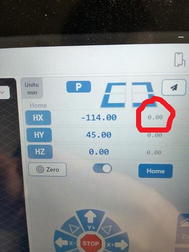

@reidcustoms If you manually jog so that the x is roughly at the corner you want, what does the grey coordinate show? That would be the absolute machine coordinates.
@reidcustoms Is gSender set to use that corner?
Been there done that :slight_smile: it is.
Homed the machine, zeroed.
Put it roughly to the corner i want and the machine shows 20 in the grey (also 20 in the blue because it’s coming from home zero).
There is lots of x travel left. I’ve zero’d off this corner dozens of times at this point.

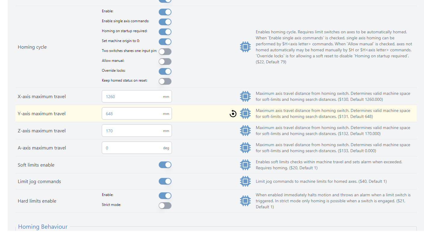

@reidcustoms did you set soft limits smaller than the machine limits? Sure looks like a limits issue.
when i specify the bit on the X and only do that, it touches off on the right yes.
i didn’t, and I went into config and reset them just to make sure when I first noticed this…

Over my touch plate middle the X is reading 40 (blue and grey).
And when it throws the Alarm it’s reading 27/27
