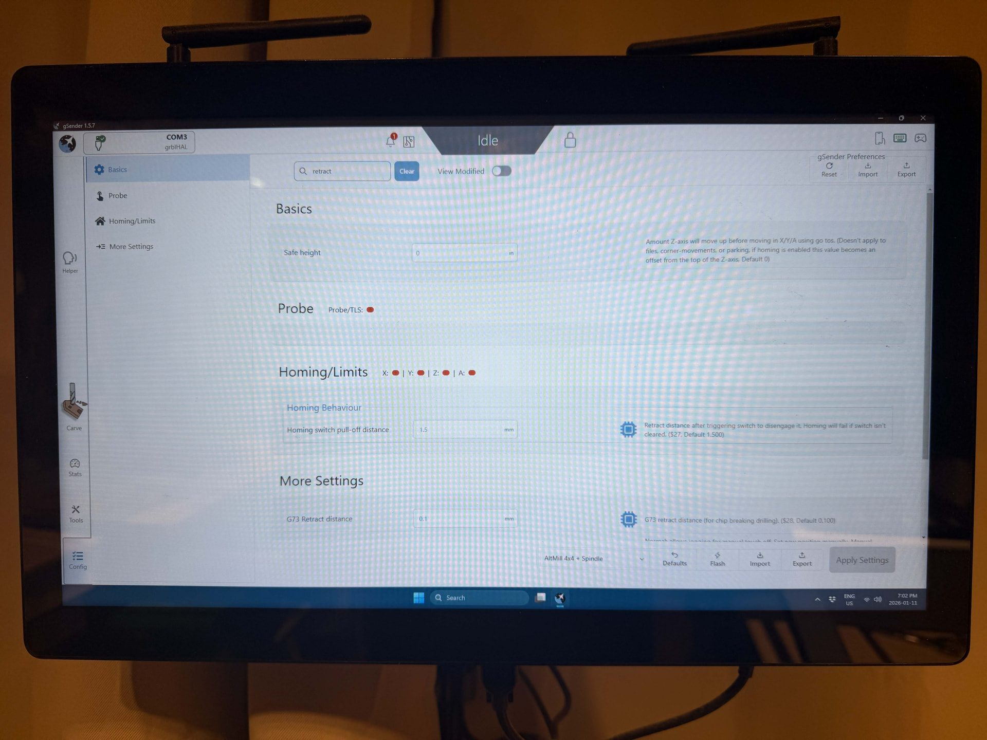

@Karver_One What is the Safe Height setting in gSender? Not in the resume job dialog box but in the Basics section of the Config.

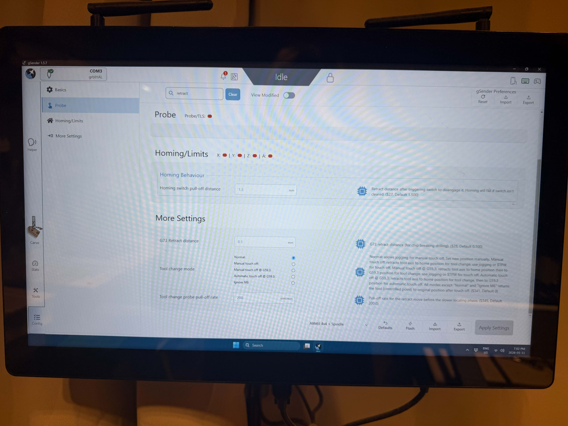

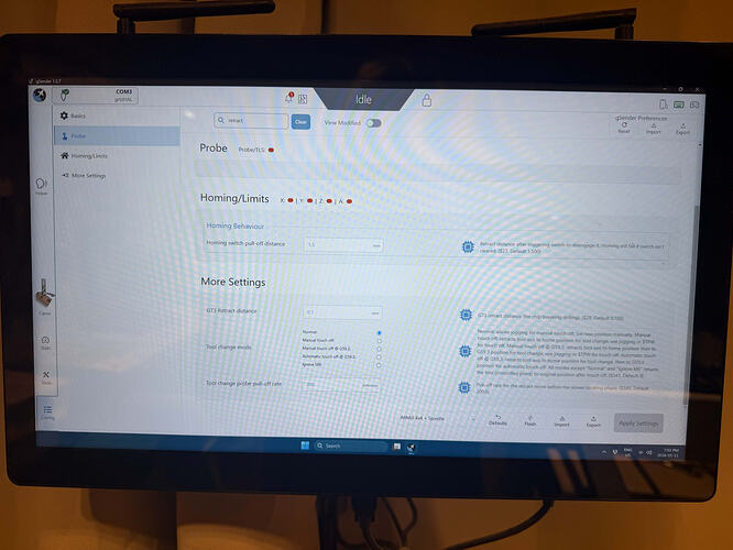

Thanks Chucky for looking at this with me, I’ll owe you one if we can solve the problem. I still don’t see an obvious problem in these settings but maybe you have something up your sleeve. Are these retract settings similar to yours?
@Karver_One For Safe Height, I have 5mm, which would be about 0.25". You have it set to 0. With a value of zero, the spindle will not move up or down at all when using to Go To’s. With a value of 0.25", it will move 0.25" from its maximum height before doing a movement in the XY direction. Having too high of a value for the safe height can cause the alarms, But with a value of zero, it’s very unlikely to be the cause. Just the same, I’d put a low value to prevent issues using the GoTo’s in the future.
