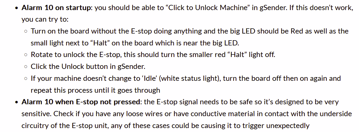

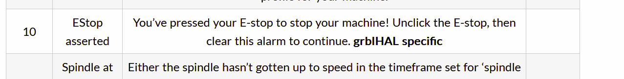

When I look at the alarm list, I see that alarm 10 is due to the estop being activated.
Found here:

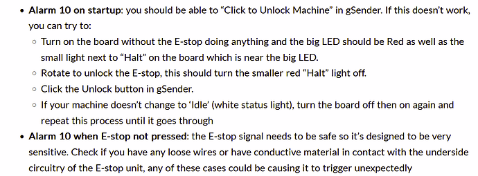

When looking into SLB trouble shooting I find a section specific for your problem stating:
Found here:
If you don’t find loose wires on the wiring of the estop, you might be stuck with a bad estop.

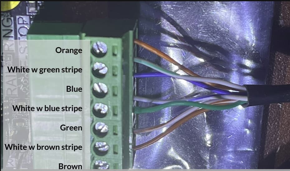

If you have a universal multi meter, you could check the estop by measuring the orange and white/green-striped colored wires with the meter set at low ohms or diode testing. EDIT: MAKE SURE YOU HAVE YOUR SLB POWERED OFF WHILE MEASURING.
If you cannot get a zero on the screen of your device, you can do a last check. take a piece of electrical wire and short the orange and white/green-striped wires at the connector in the SLB. This simulates an e-stop that is released.
If you get your machine to run with the bridge, you either have a damaged wire in the e-stop cable, a loose wire at the e-stop switch or an e-stop switch that is not functioning.
In either these cases it might be a good moment to get a ticket and have siencitists help you towards a solution.
