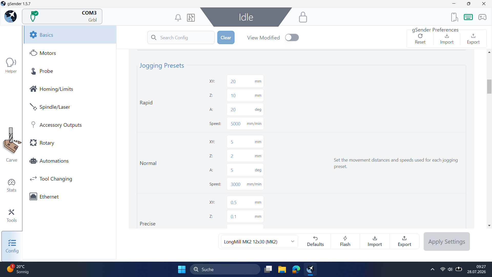

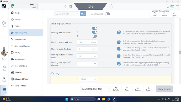

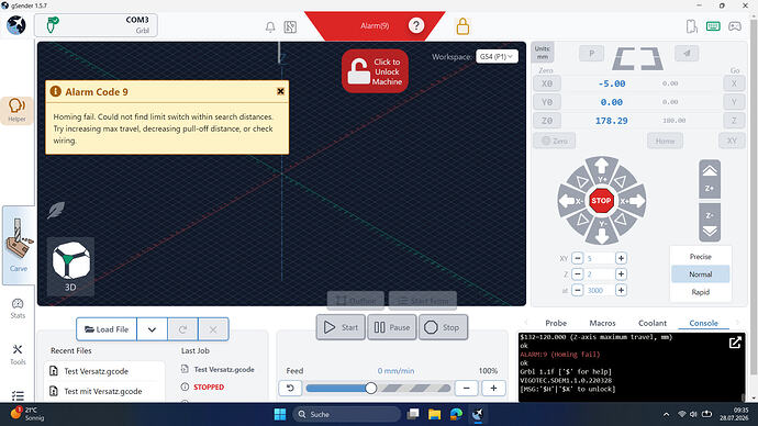

i performed a homing sequence. my vevor 3018 does not have limitswitches.
the axis engines hittet the physical limits and they liked to go more like rrrrrrrrrrr…
i knew that not good. so homing wasnt a option.

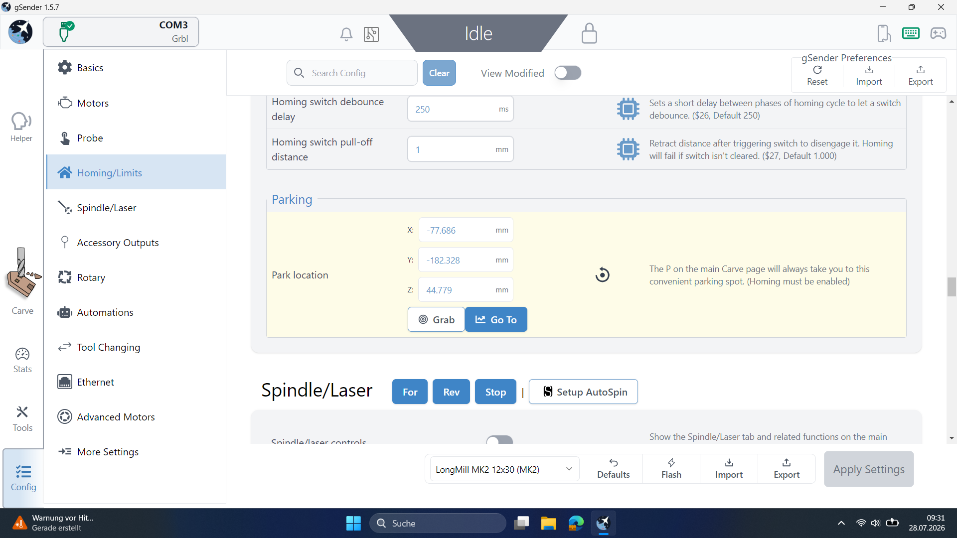

i tryed find a solution with the parking option.
i set a parking position. sended him to WPReference. works fine. back to parking. X/Y fine but Z axis likes to go further like rrrrrrrrrr…

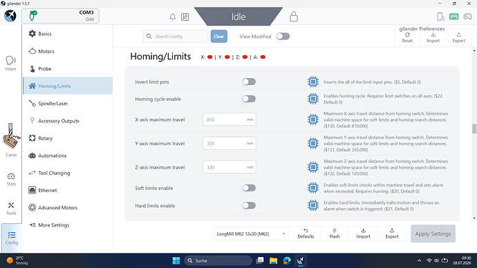

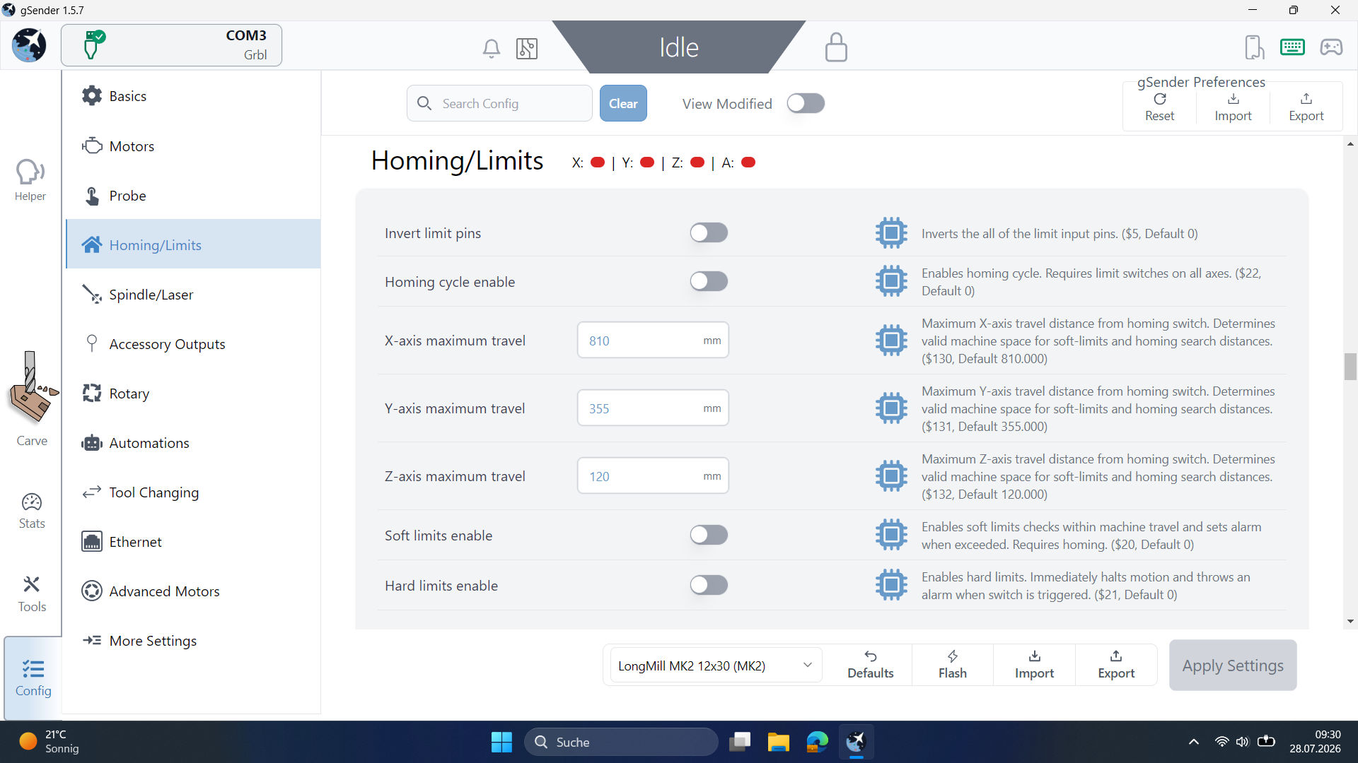

next: i was tyring some different softlimit settings. nothing solved it. so i SAVED the settings. and set all settings back to default.
its like since that default setting everything is blocked. loading the saved file the same. all axis are blocked even with the saved setting profile.
when i try to jog its like virtual jogging. the coordinate values changes. the tool on the screen moves but no physical movment at all.
i noticed the axis are blocked as soon power is on it even whitout connecting it on Gsender.
the engines gives a constant electrical humming.

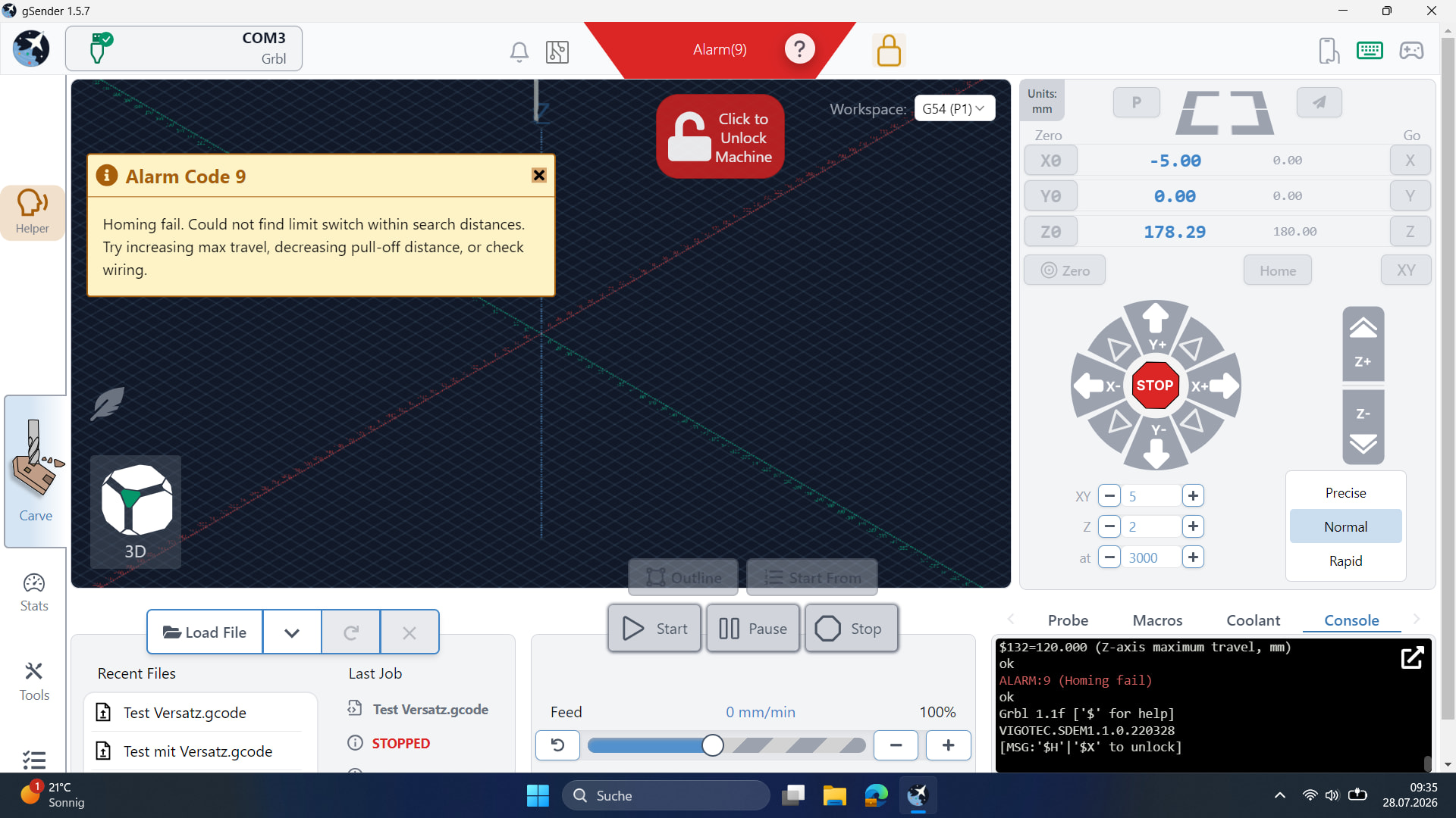

i noticed when i perform a homing (nothing moves) it unlocks the axis during trying a homing. i can turn on all 3 spindels like normaly untill the error report shows up.
has someone mercy on me with an advice?

@Clueless Welcome to the group.
I’m not sure that I completely understand what you are trying to do, but a starting point to solving your issue is to forget about homing and parking. With no limit switches, those functions are not available to you.

my main problem is that the CNC itself doesnt move anymore.

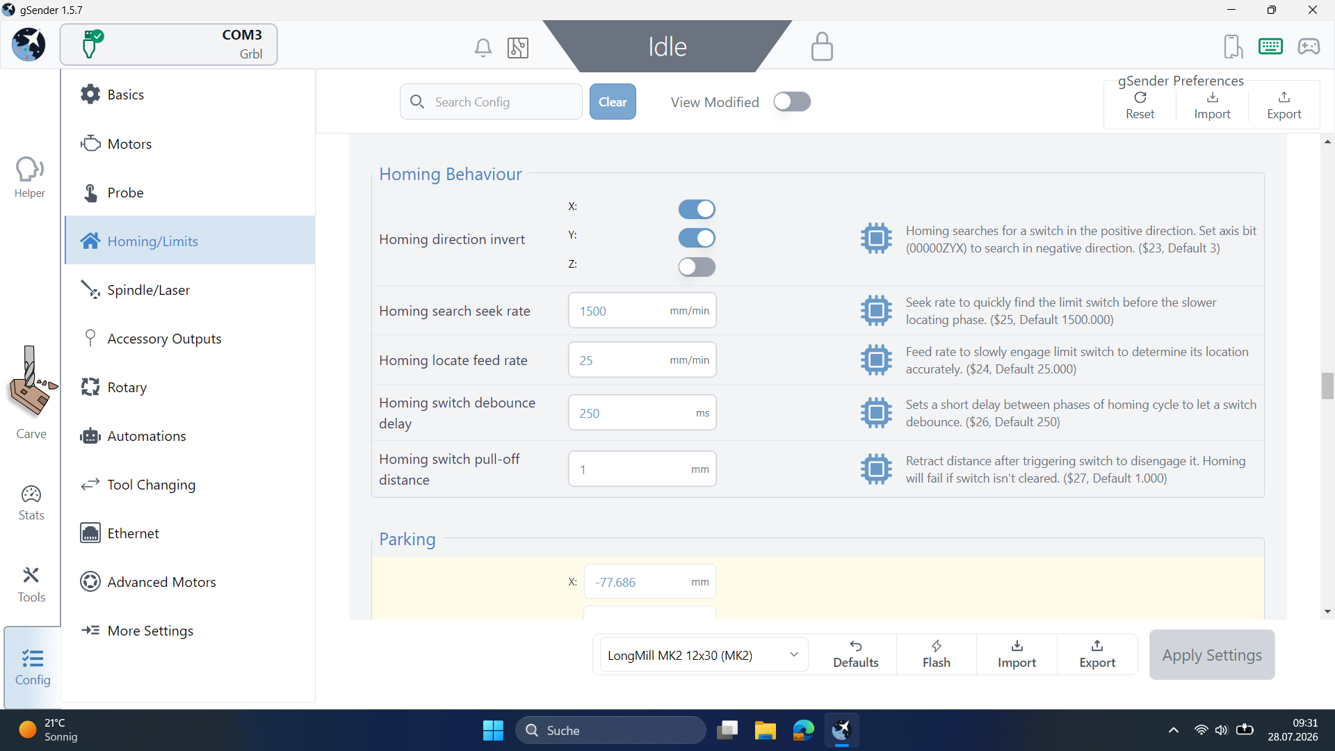

is it possible that i messed the Machine coordinates by homing it and crashing it to the physical limits?
i never crashed the tool. the x and y axes crashed. and the engine wanted to go further for about 3 sec.
but i asure you the blocking event happened exact on the point where i klicked on the default button in settings of Gsender.
since than nothing goes. before i default it i saved the settings.
@gwilki its like 50/50
it happens definitely (at least)operating Gsender
on the other hand. the spindels are blocked soon as i switch power on without a wired connection to the notebook/Gsender.
i got a remote. same blockade
I read sowhere that a G19 command can lead to blocking on Vevor 3018

Problem is solved.
like i said: caused oparating Gsender
solved operating Gsender
$RST=*
all axis given free
thank you guys
