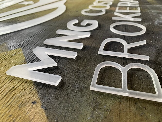

Hey guys,

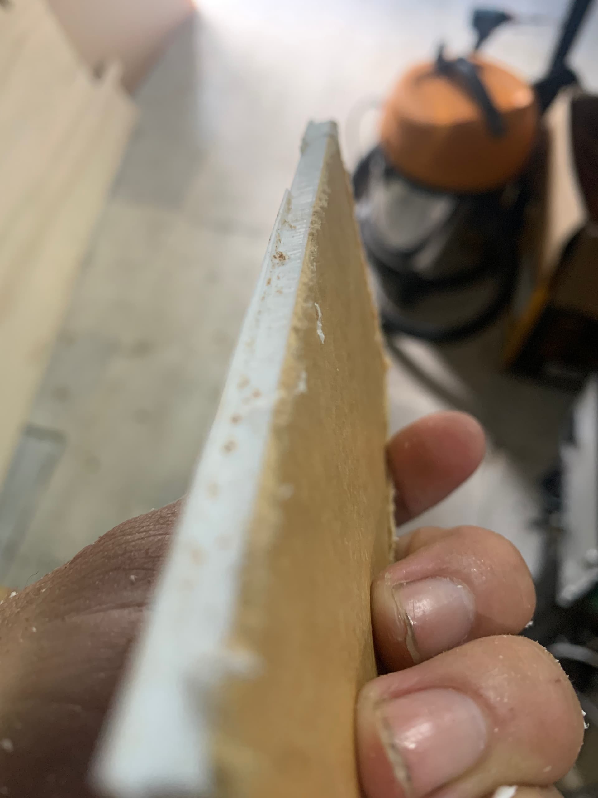

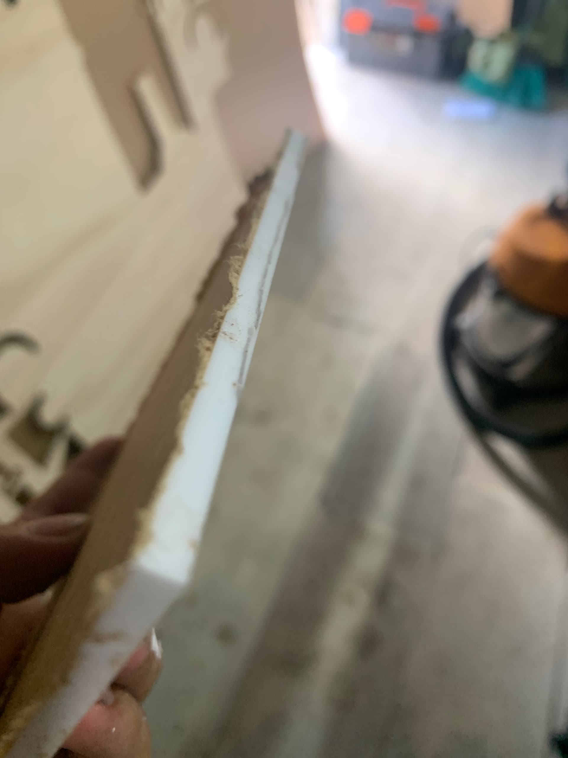

I’ve been cutting a lot of acrylics lately and I’ve had to cut some things and assemble them accurately. My Altmill has never given me any problems before but not Im noticing that when I’m cutting a 4.5 mm piece of acrylic. The first cut doesn’t align to the second step down cut. The material is well placed.
Images here:
So what I’ve observed was that whenever it started the other pass and runs down the Y axis there’s a very slight pause in the machine when changing from X to Y direction of the cut. Can you guys please help me identify what’s going on.

When I look at this footage, I do not directly notice a pauze, what I do see is the stock getting pulled up, and by the looks of it, quite a large amount. That might at least contribute to the inconsistent cutting.
You know now that you mentioned it I do see the lifting. I will adjust to setting as you guys recommended will post the results.
@A13x That’s a good call by @Spamming_Eddie . However, looking at the chips you are getting, I would say that your settings are fine. Your hold down method is not. If the material can flex, you need to use double-sided tape or blue tape and ca glues to hold it down. Clamping the edges is not working.
