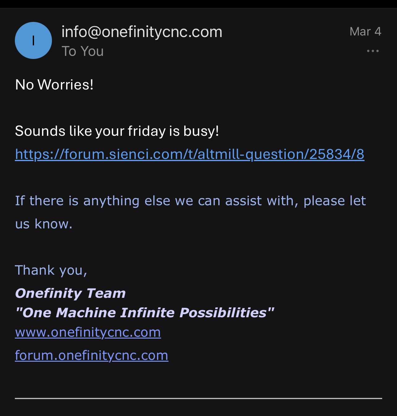

If the owner of onefinity has time to seek out what costumers say about his product on fora of their direct competitor, there’s clearly a lack of work to do on their own.
Weird business model these people follow.
@022580 Wow, that’s rather passive agressive of them. Have fun with your Altmill. According to yesterday’s blog from Andy, the 2x4 and 4x4 ship out relatively quickly. The spindle might take a bit longer though.
