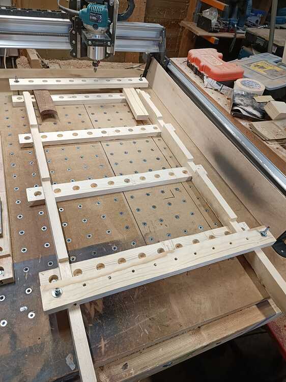

I too have a Longmill and opted to have my bed filled with inserts. Initially I went for a small mdf secondairy wasteboard and found it was indeed messy to keep resurfacing. I now use strips of pine that I can place around the machine to support projects. I (re)surface them untill needing replacement. Waaaay les messy and waaay quicker to do a surface job on.
MDF is, since replacing the sub-wasteboard with strips, a forbidden product on my machine.
