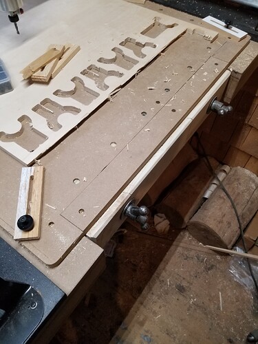

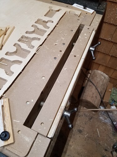

You want to do something like @_Michael does in this photo?
Yes, that is what I call ‘vertical milling’. Every configuration that I have seen involves a cutout in the mill’s table and the board to be milled is held by some kind of fixture under the table. It would seem to me that having that fixture at the end of the mill table makes the entire operation easier.
There have been versions of Long Mill machines that have the vertical hardware at the very front but in those cases the effective area available for traditional work is reduced.

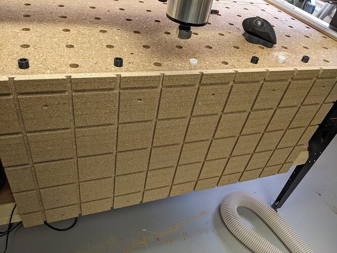

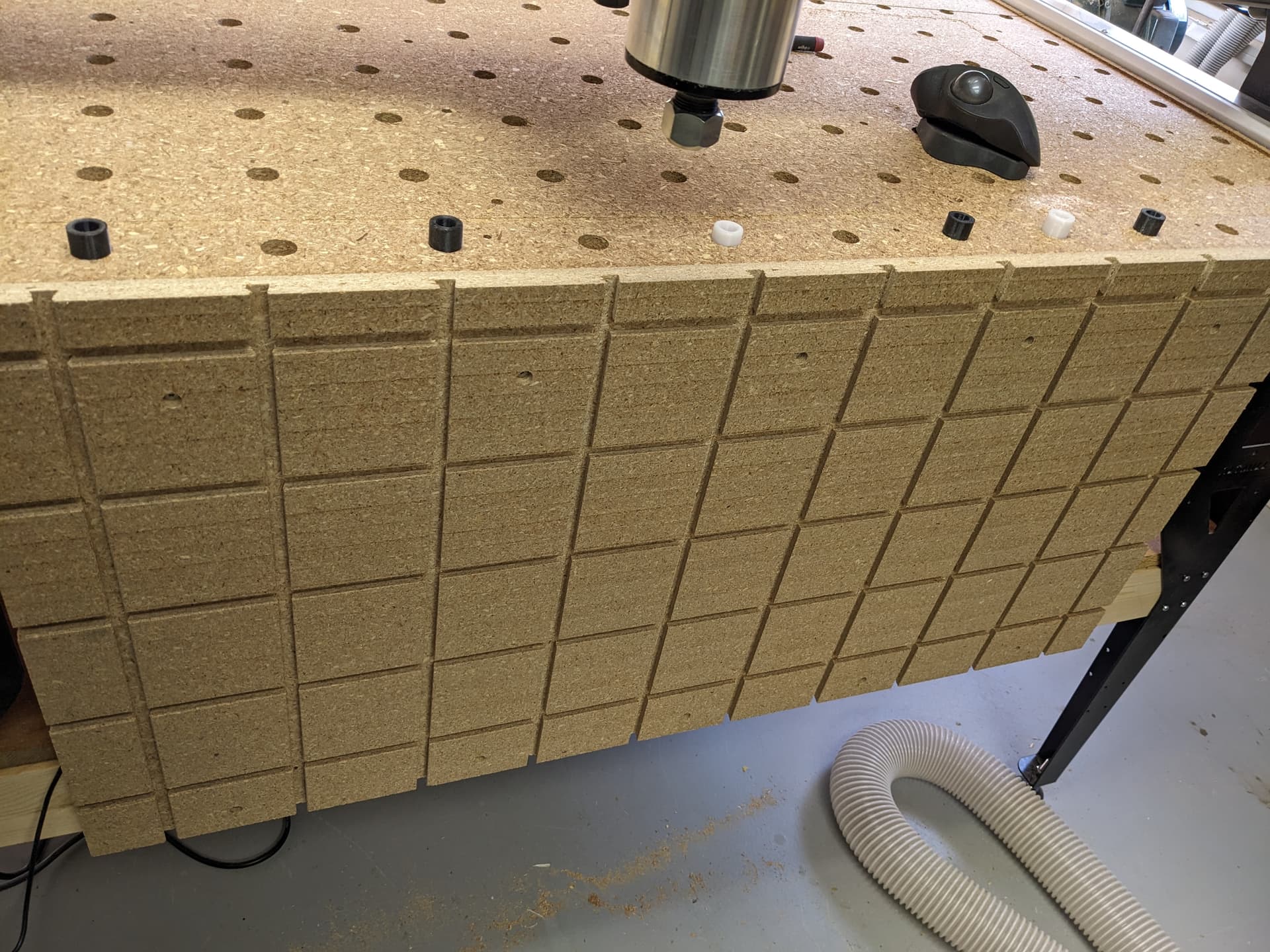

I like the way @CncJim did his because it’s at the front and he didn’t lose space.
But looking at the Altmill and it’s table frame I guess you need to either go all the way in front or use a space between the framing. As far as extending or moving the router 3" forward, I would think that if you slow down to compensate that it could work. Bear in mind I am not an engineer, not by a long shot!

My thought was to go all the way to the front of the frame, an area that the regular spindle can not access. This would be just in front of the Altmill’s front cross member. That is why I was thinking of mounting a secondary router in front of the current spindle when the job calls for vertical milling.
Yes, I would reduce the feed rates because this would be a router instead of the main spindle (less powerful) and because of the position further out from the normal spindle position (less rigid). I would probably not do a single full depth pass but I would use a straight mill to clear out the middle and then use a dovetail cutter to do the final cut. Actually, my thought had been more in the lines of a finger joint which of course can be done with multiple depth passes.
So far nobody has called me totally out of my mind so I think it might be worth a try to build a prototype of this setup. I would probably 3D print the initial mount to see how this concept would work.
While the official work holding setup would be for a straight vertical setup, if it works out, I might incorporate a tilting work setup system so that I can run 45 degree angles.

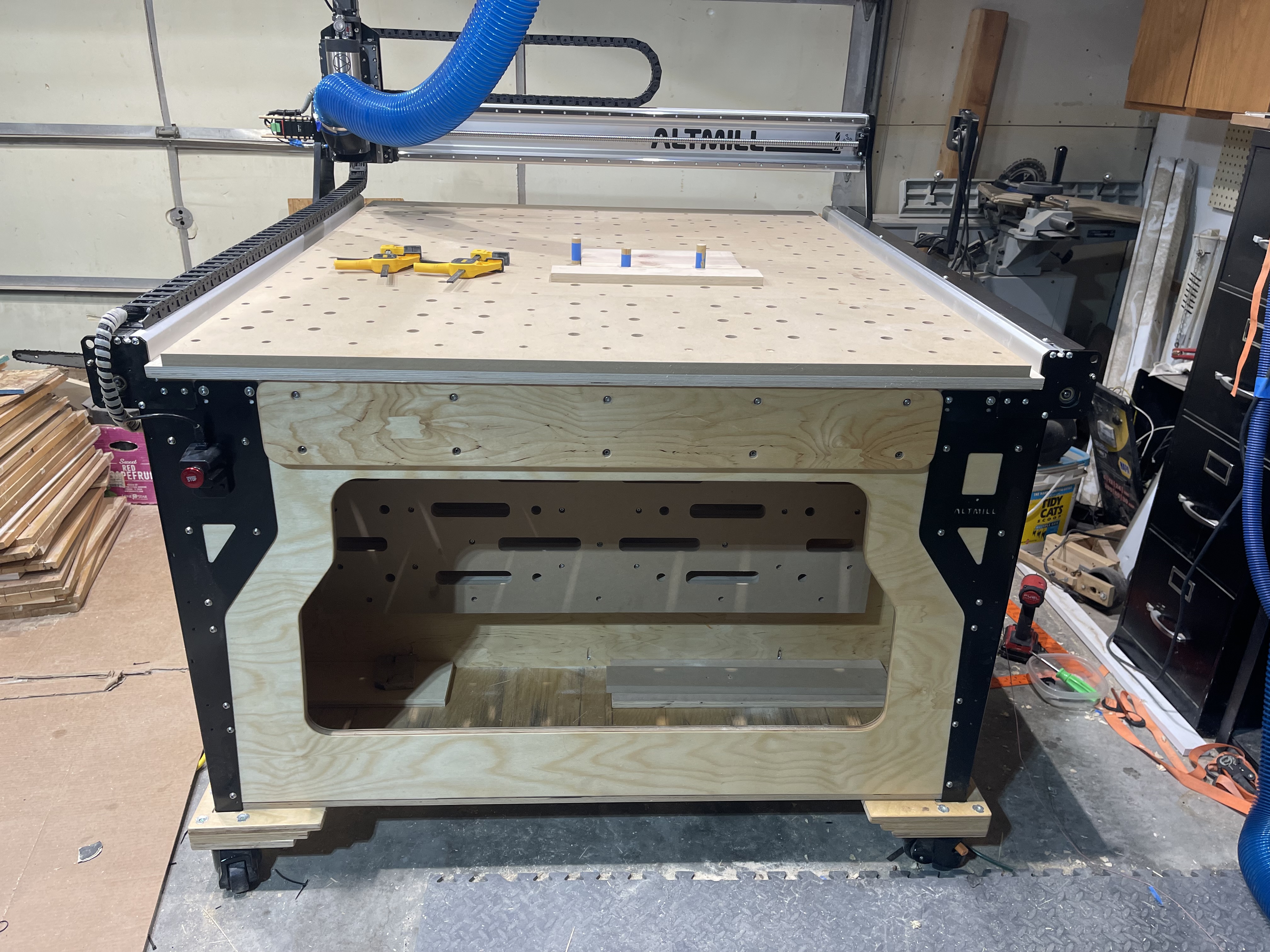

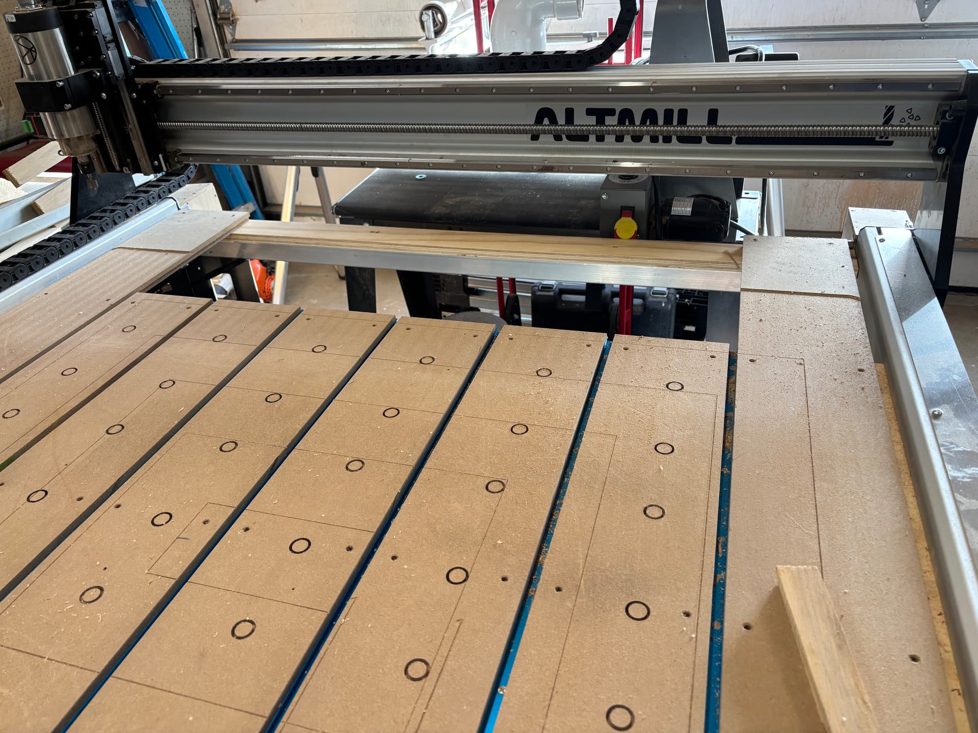

During assembly of my Altmill and the wasteboard I decided to stop the wasteboard at the second cross member from the back of the machine. I have 6" in Y available and 48" in X available for clamping material vertically. To maintain full Y range and the possibility of tiling longer material I will have a removable piece of mdf that can be attached over the back rail for support. Removable so I can flatten it as necessary when the wasteboard is resurfaced. The two pieces on both sides of the Y axis will be removed when I venture into that phase.
I’m with on this Jens, I would certainly like to be able to do mortises on the ends of my work pieces.
Just lose the legs and the last cross piece. Build a table with drawers and storage just like you would for a Longmill. Have a notch at the end of the Y axis a few inches in where you install your vertical clamping surface, complete with grooves or t-tracks or whatever you want.

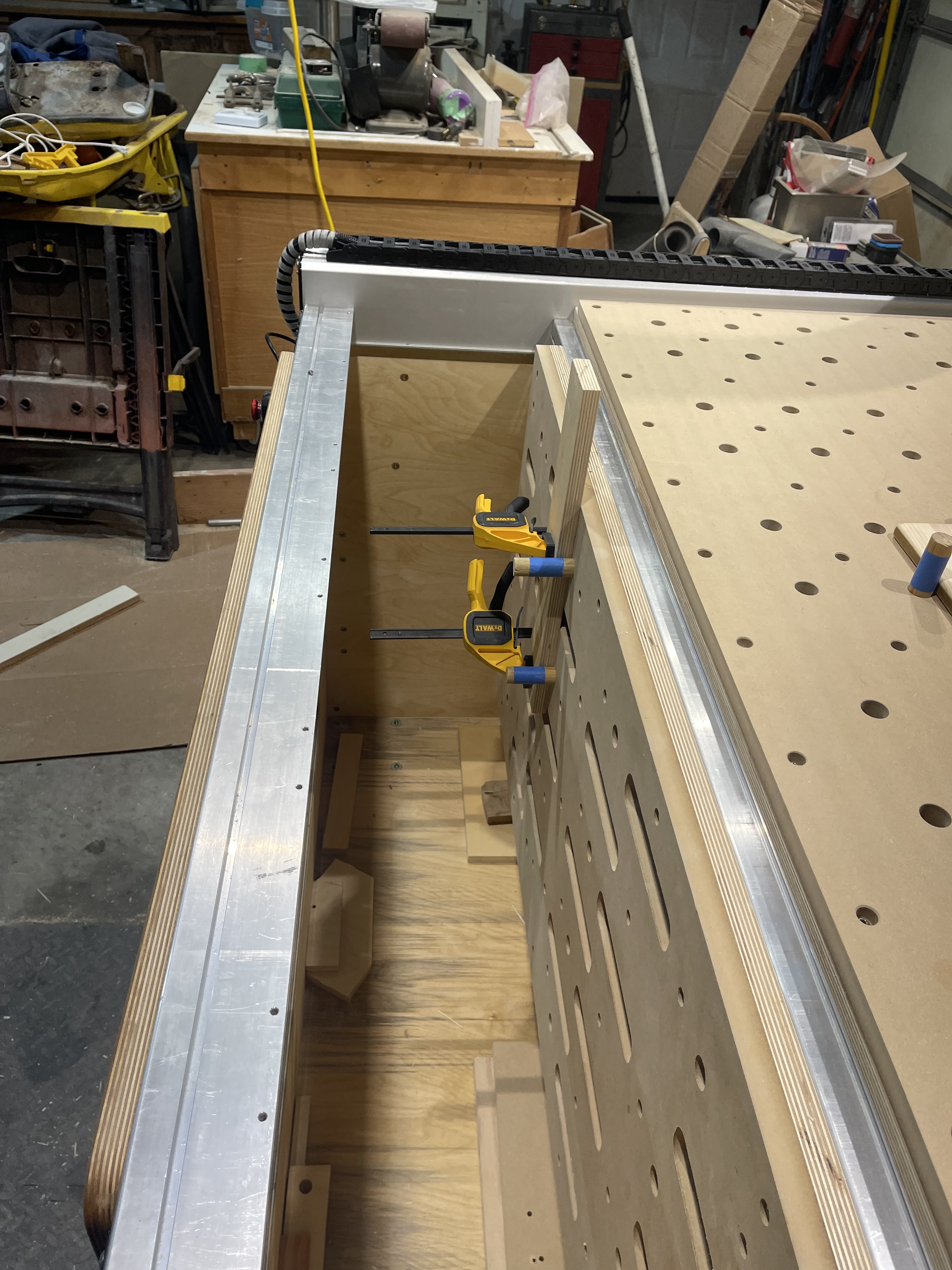

I love the idea of vertical board off the front with a bench end vise. As much metal as the factory spindle mount is I bet it would extend ok. I wrapped my vertical board up last week. Contemplated putting it on back but didn’t wanna work between motors. Just put it between first and second cross members at front. Working on a way to secure the extended waste board that covers the vertical board.
That clamping surface looks like the ones that the Avid people use. Seems like it should work fine if a little awkwardly.

Progress picture - slow but steady …Mounted on the front cross member using the T slots in the cross-member which required some out-of-the-box thinking. Spacers were used to locate the drop-in nuts and teeny tiny wedges were inserted behind the nuts to keep them in the correct position (they flopped all over the place before). With the drop-in nuts located and wedged the vertical board went on perfectly.
In the picture the router is located about an inch in front of the mounting board with lots of room for thicker stock. Width of the board is the width between the leg angles.
