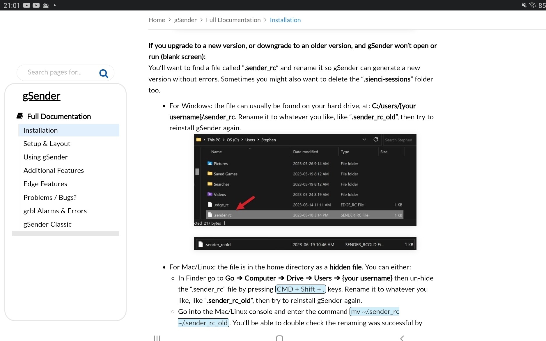

As far as files from a new version having problems when reverting to an older version here is what I’m aware of.
In your home folder there should be a .sender_rc file. Its probably hidden if you don’t have show hidden files checked in file explorers options. There is also a folder named gSender in AppData somewhere. I don’t have a Windows machine anymore so I’m not positive but I think it’s in C:\Users\your_name\AppData\local but it could be in one of the other sub-directories of AppData or just in C:\AppData.
I’m not sure if you can export settings from a new version and then import them into an old version. In any case it’ll only be gSender’s settings, not firmware settings that you have to redo.
We all should, but I never remember to, export settings, macros etc before updating just in case we decide to go back.
All good points, gentlemen, I appreciate you taking the time. I did revert to 1.2.2, replaced the .sender_rc file with an known good one from another PC and all was well today.
