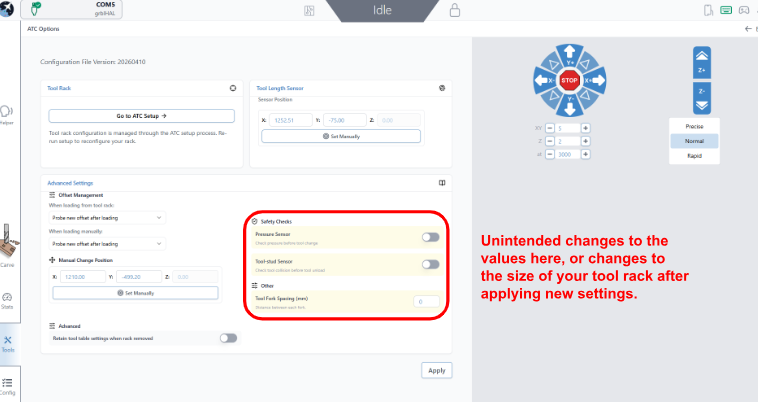

There is a bug in gSender 1.6.0 and 1.6.1 that is affecting users. The issue is if you setup the spindle and then open ATC options, there is a chance the files on the SD card get modified incorrectly and the settings get reset.
Recently, two specific bugs have been identified in gSender versions 1.6.0 and 1.6.1. These errors can cause unintended changes to your tool rack size and other settings after using the tool, and can potentially result in the ATC colliding with the tool rack.

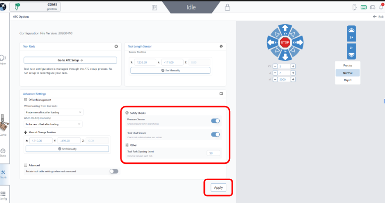

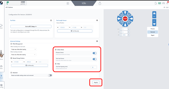

  3. Exit “SD Card Manager” and go to “Tools” > “Accessories Installation” > “ATC Options”
  4. Make the following changes
    1. “Pressure Sensor” to On
    2. “Tood-stud Sensor” to On
    3. “Tool fork Spacing” to 90
  5. Select “Apply”
  6. If you intend to make changes in “ATC Options” in the future, first visit the “SD Card manager” to refresh the files list, before moving to “ATC Options”.
