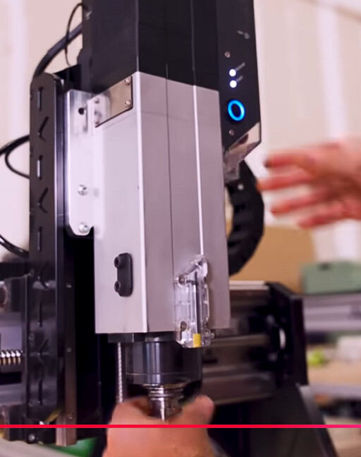

@beerbarrel What does the button with the blue light do? The ATC video shows it being pressed for a manual tool change. Press the button and pull down on the tool holder.
I did that…it does not do anything…it does not even light up on mine.
@beerbarrel Yeah, I’m wondering if you also need to put the ATC in manual mode in gSender for this button to work. I believe compressed air is used to activate the claws that grab the tool holder. Maybe there’s a valve that’s controlled electronically.
