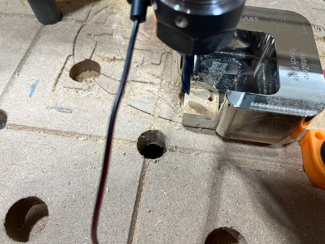

Still not XY zeroing properly using the AZTP no matter what. When it completes an XY probe with the correct corner selected in gsender, it still does not find material zero corectly, it’s like 10mm +Y
So when I run a job, the Y axis cuts tend to be -Y below where they should be. Makes no sense. When I run a job and let the spindle go back to material zero, it actually does. Again, makes no sense, especially after it goes back to XY zero after a job, I can run the same job from that position and it still cuts 10mm -Y. It’s pretty insane.

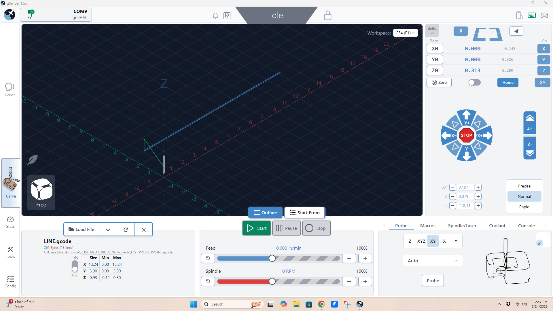

@grainandgain After probing, what are the actual coordinates displayed in gSender? A screenshot may be helpful.

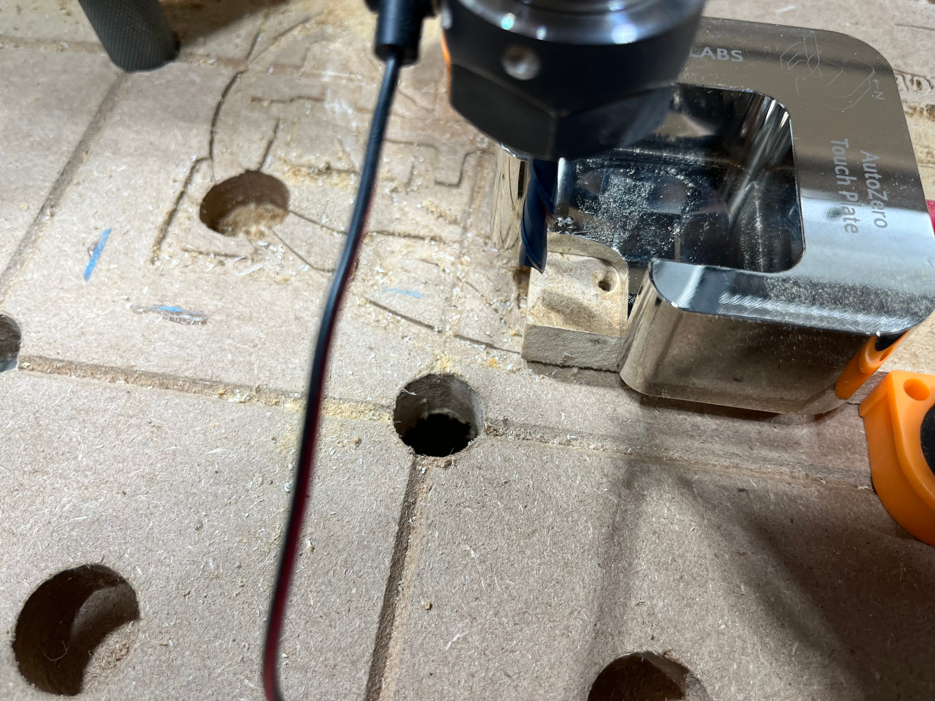

I just did an XY zero probe and here is a photo of the actual position it finished in. I measured it at 10MM on the dot. Gsender says it’s XY zero as shown on the screenshot.

@grainandgain Not that this has anything to do with your issue but how come the grey coordinates are so small? After homing, the rear left should be x0,y0. Anything close to the front should have a much larger y value.
I fine tune them when manually setting zero so they don’t move so much.
@grainandgain I’m not sure what you mean.
The grey coordinates are the machine coordinates and should always be relative to your rear-left homing location.
For example, if you jog to the rear left, the grey x and y should be 0
If you jog to the front-left, the grey x=0, and the y=-48 (if in inches and for the 48x48 Altmill).
Front right, grey x=48, grey Y=-48
These values are independent of what you set as your zeros.
