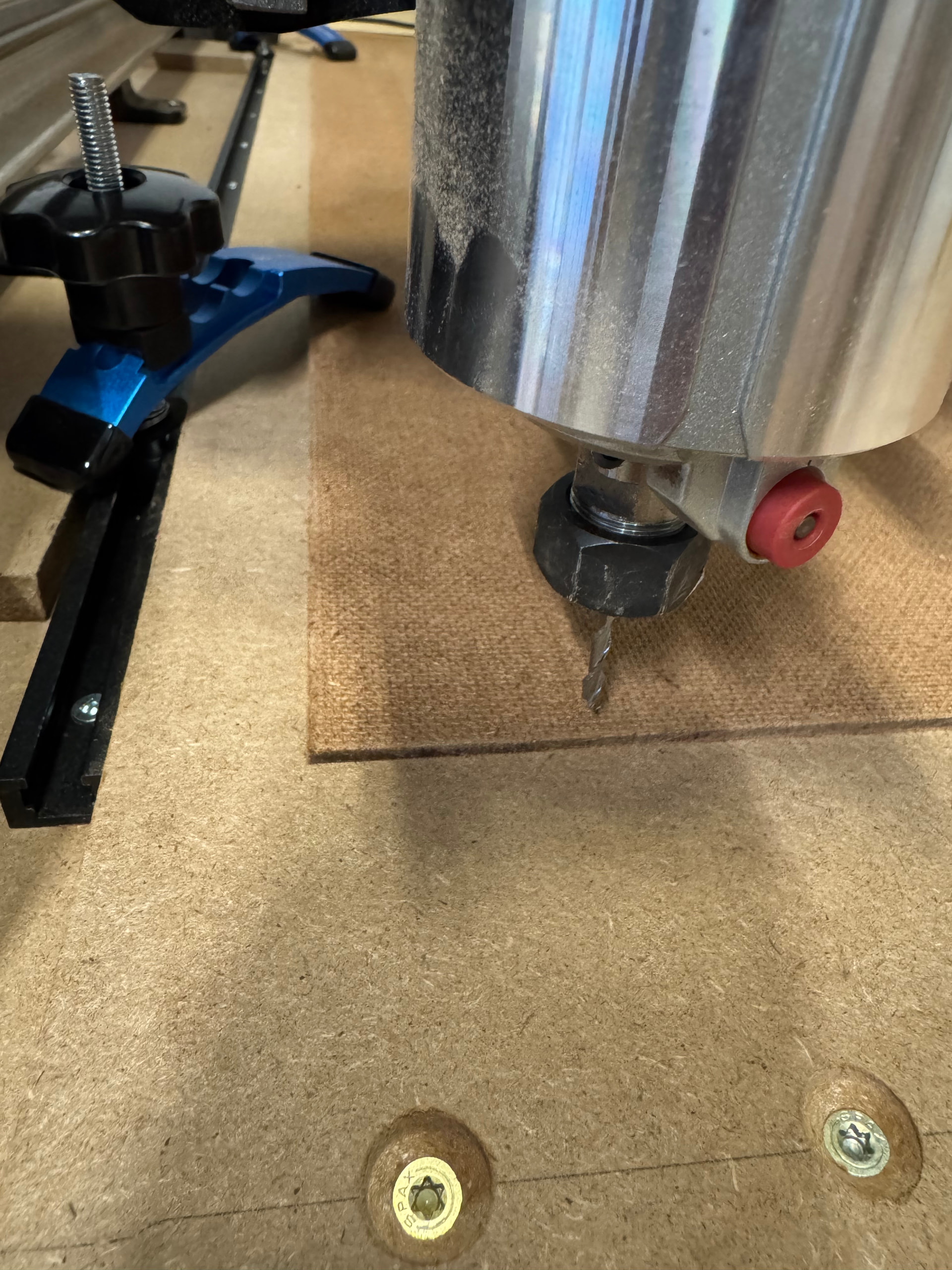

I’m pretty fresh to the whole CNC world and have stumbled my way to two successfully completed jobs on an MK2.5 48x30. I went out to the garage to see if I finally got the next job all ready for cutting when the Autozero touch plate suddenly didn’t zero on the corner of the stock–it’s +45cm x-axis. It repeatedly returns this as the zero point. I haven’t made any changes to any settings or made any physical alterations to any part of the code-to-cut process since the last job (which again, was successful). Gsender shows x0y0z0 for the placement of the bit. I tried turning everything off and on again and made sure that my gsender was up-to-date. I can only upload one photo as a new user but I’ve oriented the plate so that the bit should be able to exit to the corner shown in the photo I did upload. Please help, what am I missing?
@thepakltd I’m not sure I understand the issue. If you set the AZTP at the front left corner of that hardboard and run the zeroing routine, it doesn’t set the zero at the corner?
Hey Chucky, yup. That’s correct. Y is great, Z is great, but X is off 45cm away from the corner.
@thepakltd can you post a picture of the spindle and mill after it’s done zeroing (similar picture to what you posted already but with the AZTP still in place) and a picture of the coordinates you see in gSender?
45cm and not 45mm, correct? A full 18" off ?
Looks to me like the wrong corner was configured for the probing. Check to see that the system knows you are probing on the left front corner instead of the right front corner which would result in this kind of offset. The only thing odd here, if the auto Z probe was used, is that the cutter didn’t break when it tried to go to x/y zero. It would have caught on the auto zero’s edge …

Hey there y’all, appreciate all of the responses and insights. Turns out I did in fact inadvertently click the little button with the diagonal arrow on the probe display–surprise, surprise that it is in fact just user error.
