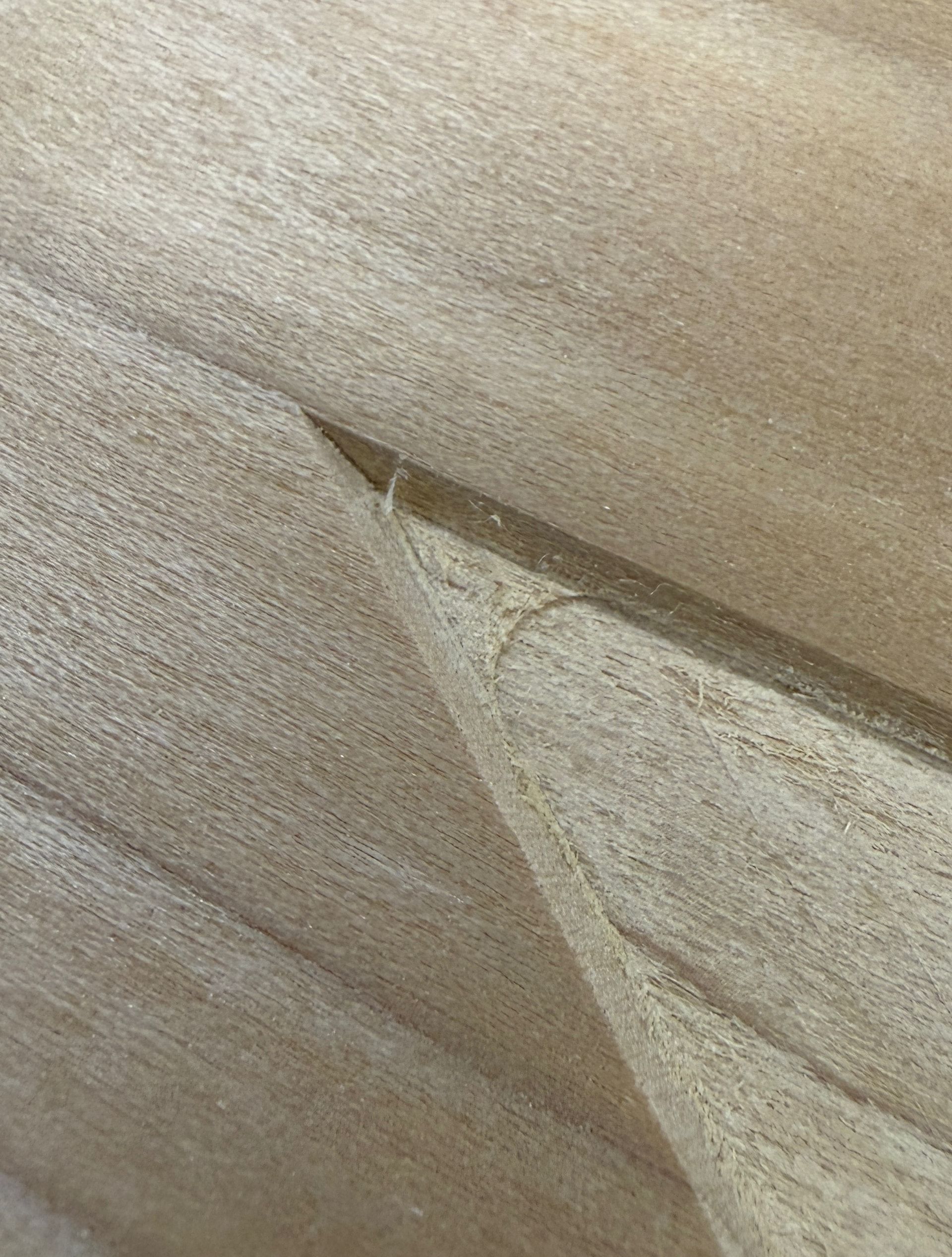

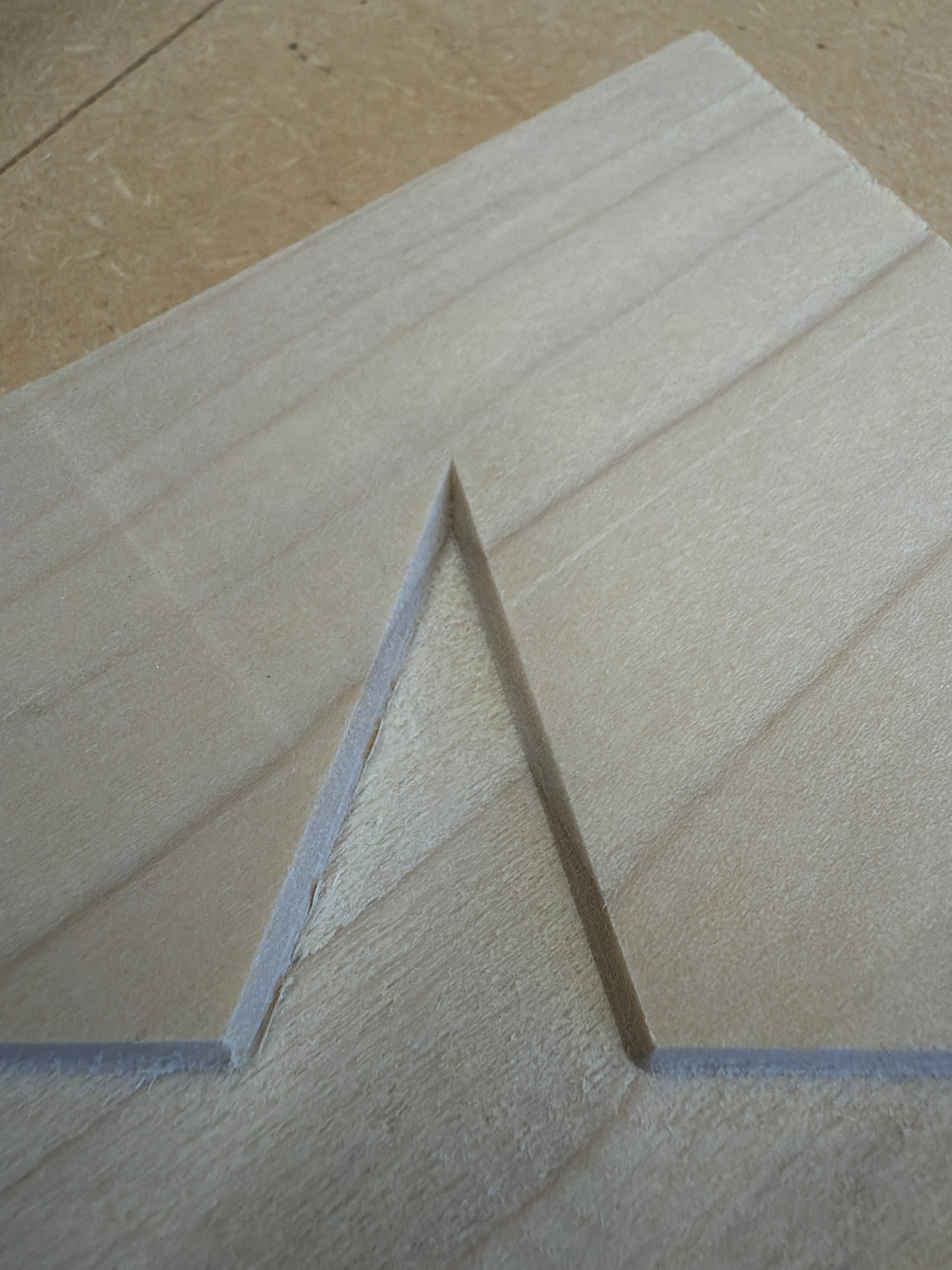

I’m trying to do a Vcarve generating the toolpath with Vectric Vcarve and running it on my Altmill with gsender. I’m seeing a step between my clearance tool and V bit of about 0.015” when Z zeroing with AutoZero touchplate. If I zero Z using paper method I don’t see the step. What might be causing the step with the touchplate? I made sure there wasn’t any wood chips underneath the touchplate.

Thanks for the response, my Vcarve flat depth was 0.100”. Taking into account the 0.0025” paper the paper Z zero carving was right on. When I Z Zeroed with the AutoZero Touchplate the area with the 1/4” downcut endmill was about 0.010” too deep (0.110”) and the 60° Vbit was about 0.005” too shallow (0.095”). The board I was cutting in was 0.750” or 19mm, well over the 4mm lip on the AutoZero TP.

I finally got back to my machine. I cleaned everything off as best I could and put in a 1/4" end mill an zeroed it off the back of the AZTP. Then after positioning appropriately I checked various heights with a feeler guage and it was right on. I then did the same with a v-bit, again right on. I believe I just had router dust causing my original issue.
