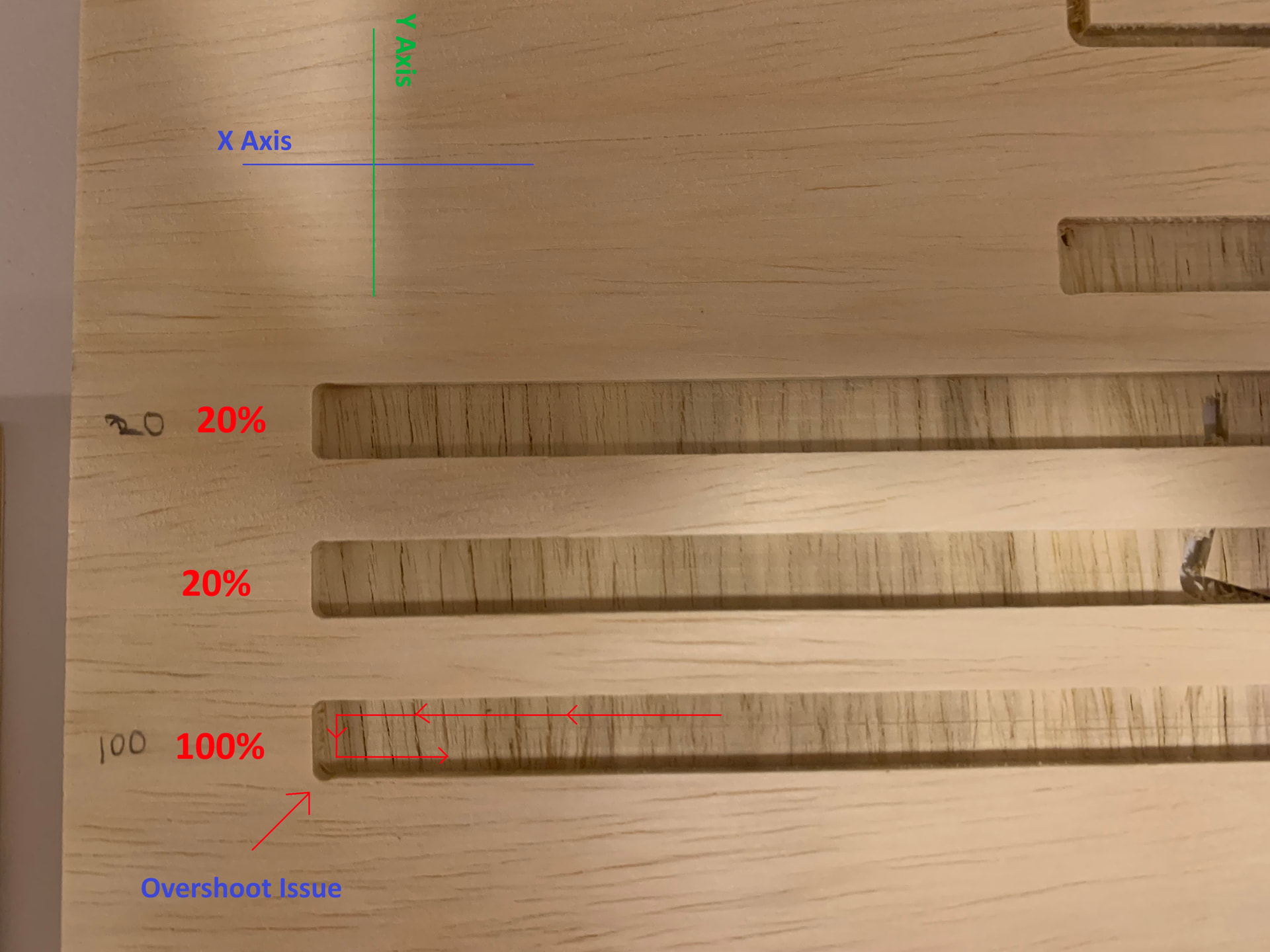

I’m new to CNC routing, but I’ve been 3D printing for 15+ years.
I just purchased an Altmill 4x4. I’ve done a few projects with it so far (relief carvings and some acrylic inlays) without issue.
My wife wants to make a detailed flag carving for her dad, so I setup a quick test project. She wanted to make it around 10 inches wide, so I mostly set this up to see how the stars would come out since they were so small at this scale.
We ran the job, and noticed these “lobes” on the bottom left of the pocket in each stripe. See the attached photo for more detail.
The toolpath for the stripes is a 1/8” SpeTool DownCut Bit (W04006). I imported the SpeTool Database into VCarve and used the settings for soft wood. The toolpath VCarve generated shows a speed of 115” per minute.
I decided to do a second test and let the first stripe run at 100% speed, then slow it down to 20% in GSender when it got to the second stripe. This “fixed” the issue. My immediate thought was to get back into VCarve and dig into the speed / acceleration / etc parameters. I quickly learned that VCarve / CNC routing is not like 3D printing :slight_smile: Not much to adjust.
I did some searching here on the forums and online. Mixed results, I’m not sure if I need to slow things down or if it’s potentially a backlash adjustment issue?
Going back to some of my other “hello world” cuttings I can see they have some minor overshooting as well, but not as noticeable as these.
Ah, and the wood is just “Sande plywood” from Home Depot. We just got a 4x8 sheet to test / learn with since it was really cheap.
I tried to notate the photo to show the direction of travel and X / Y axis.
Thanks!

Welcome to the forum , glad to see your jumping right in. There are probably a lot of people here who have experienced this problem. As you know CnC’s are different then the 3d printing you have been used to. I am sure some other people here will be able to also chime in on how to fix this. But on my behalf here is an opinion. Based on your description and the photo, you’re experiencing a common CNC phenomenon known as corner rounding or as you have called it, overshooting. This occurs when the machine’s physical inertia prevents it from making a perfectly sharp change in direction at high speeds.
Because the “lobe” is appearing at the bottom-left corner where the tool transitions from its X-axis travel into its Y-axis movement (or vice versa), the machine is essentially “taking the turn too wide” because it can’t decelerate and change direction fast enough at 115 IPM.
Why slowing it down “fixed” it
By reducing the feed rate to 20% in gSender, you lowered the velocity to roughly 23 IPM. At this slower speed, the machine’s existing acceleration settings are sufficient to allow it to follow the intended path accurately without the momentum “pulling” it past the corner.

“This occurs when the machine’s physical inertia prevents it from making a perfectly sharp change in direction at high speeds.” - Yeah, just watching it run it doesn’t seem physically possible for it NOT to overshoot. The entire mass of the gantry, side plates, and Z assembly are in play when it’s moving on the Y axis.
I had not yet “stabilized” the frame when we ran it this morning. I spent a couple hours running the two levels of 2x4’s around the machine, then added diagonal bracing between them on the Y axis (sides). It is VERY rigid / stable now.
The photo is from the post-stabilized run. The results were identical, though the machine was MUCH more stable while running.
I looked for a guide on checking backlash while I was still in the shop this evening. What I found seemed to suggest there was nothing you could adjust on ball screws? I’ll check and see if there’s any wiggle in the gantry when the motors are engaged tomorrow.

ISSUE RESOLVED: It was the Y axis ball screws. You leave the screws loose initially on the Y axis linear rails and ball screws. While I did come back and carefully tighten the linear rails (the part I was most nervous about), I did NOT tighten the ball screws.
I can’t believe I missed a step but I did, particularly here as the linear rails and ball screws were the parts I was so careful with.
I think Karver_One had mentioned pulling on the gantry while the motors are powered and see if there is any slop. That is what did the trick, when I grabbed the gantry and pulled, there was indeed slop. Quickly found the source of the slop was the untightened ball screws.
Redid the test, no more lobes, and it is indeed completely capable running this particular test at 115" per minute.
