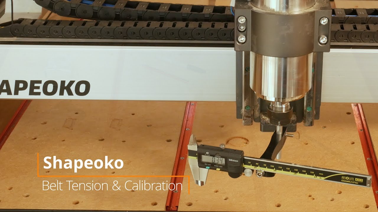

The tuned part of the belt was 280mm in length. The part of the belt to be tuned was raised on ¼” wooden supports. The belt was plucked with a wooden plectrum to standardise its vibration characteristics. The vibration was measured using a guitar string tuner attached to the extrusion endplate.
Supports under section of belt to be tuned.
The short video clip demonstrates the technique. Gates GT2 belts are designed to operate at a tension of between 100 and 150Hz when plucked. I chose a value of 135Hz because it equated to a note of C3 on a vibration sensing guitar tuner. Keeping the belts tuned to a set frequency means that each belt can be set to the same frequency and even movements can be expected. This in turn leads to accuracy of cut and the belts last much longer. The pull on the stepper motor shafts is known and within permitted limits.

The science of belt tension was beautifully explained by Liam Newcombe over at Carbide 3D and can be found here:
The supporting video can be found here:

I hated the job of belt tensioning with a passion. I discovered a belt tensioning system that made more mechanical sense to me and it maintained a straight belt path. It was designed by @NeilFerreri and was published on Thingiverse. The link to Neil’s work is here:
I had some components 3D printed and carried out some surgery on my SO3. I now can tune each belt accurately in seconds rather than the extended times of 30 ~ 45 minutes that I had expended previous to this modification. I also now had an accurate method of tensioning the belts to a known tension value. The short video clip displays the method used to accurately tension the belts. All of the belts used in this demonstration are Gates GT2 specification.
