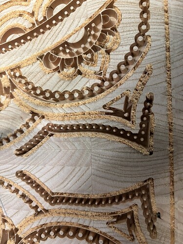

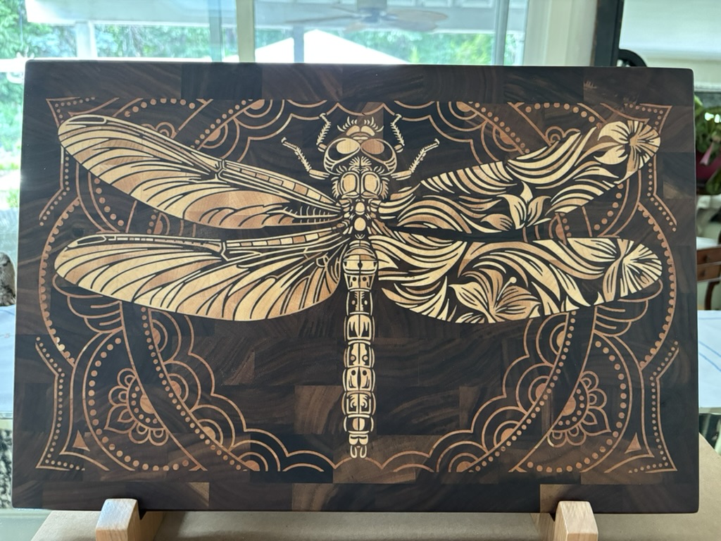

Hi Andy. Discovered the same thing a few days ago after v-carving 4 inlay plugs to the wrong depth! My own damn fault, I never checked it. When the plugs would not fit properly I checked the auto zero touch plate and it was +.471 mm on all of the bits checked. Will be submitting a ticket to see if it can be calibrated. Hereās a picture of one of the plugs that ended up in kindling box! I re-made 4 new pugs and surfaced off the cutting board and started over lol. Hereās a picture of the finished piece. Design by Nik at brownwood.com. Altmill mk1, gSender 1.49. Cheers
