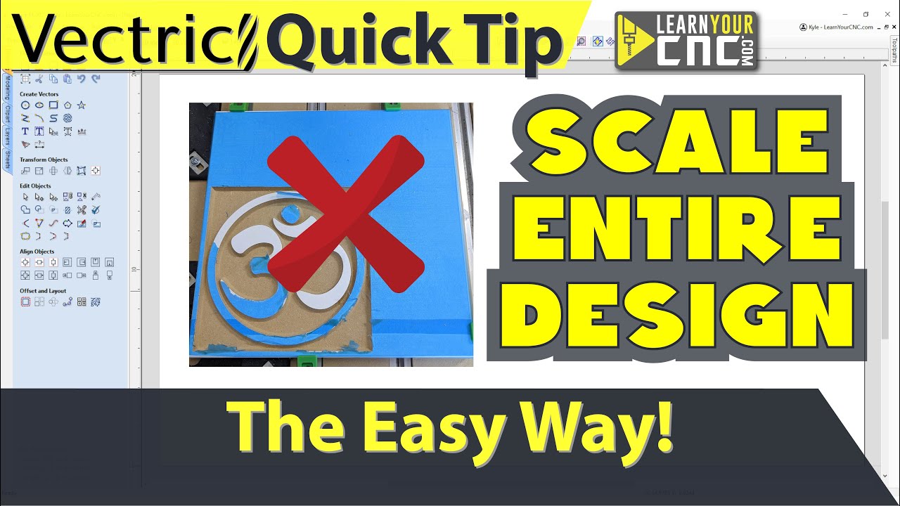

2 changing parameters. This can be done in a few ways. If all you need is scaling the complete cabinet, you can do it this way:
However, this may affect offsets that you might not want to scale.
You can create a template library as you go and resize like this:
