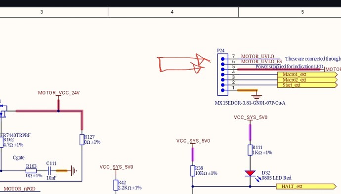

In this case it sounds like the soldering/wires conducting via the actual estop switch are the culprit. You can check if the problem is on pcb or on the switch bij shorting pin 7 to pin 7 (E-stop/E-stop) on the connector. If shorting these two pins on tne connector results in your slb powering up, check the wiring of those two pins.
If this doesnt work you can try and short the two pins on the board specific for troubleshooting an estop problem.

if i short out the estop pins as describedin steo 4 the machine comes to life but it completly nullifies the estop. So that appears to narrow it down some, just not sure where
Wouldn’t that indicate that there is a problem with the wiring going to the estop? (or the estop itself)?
Possibly wiring, I closed the circuit on. The estop button manually with no change in behavior.

Well, that is a good result. I personaly would now put a microscope on the wires of the estop at pin 6 and 7. Get them out of their seating and inspect them closely, it might be that they are not stripped.

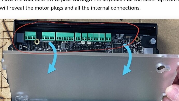

Can you unplug the E-stop from the cable and open up the E-stop from the 3 screws on the bottom? Check if the wiring inside is loose and reconnect them if needed. Then hook it up again and try it out
I did that, and unplugged the wiring harness from the e-stop. I then completed the circuit on the two wires leading to the e-stop button with no success.
