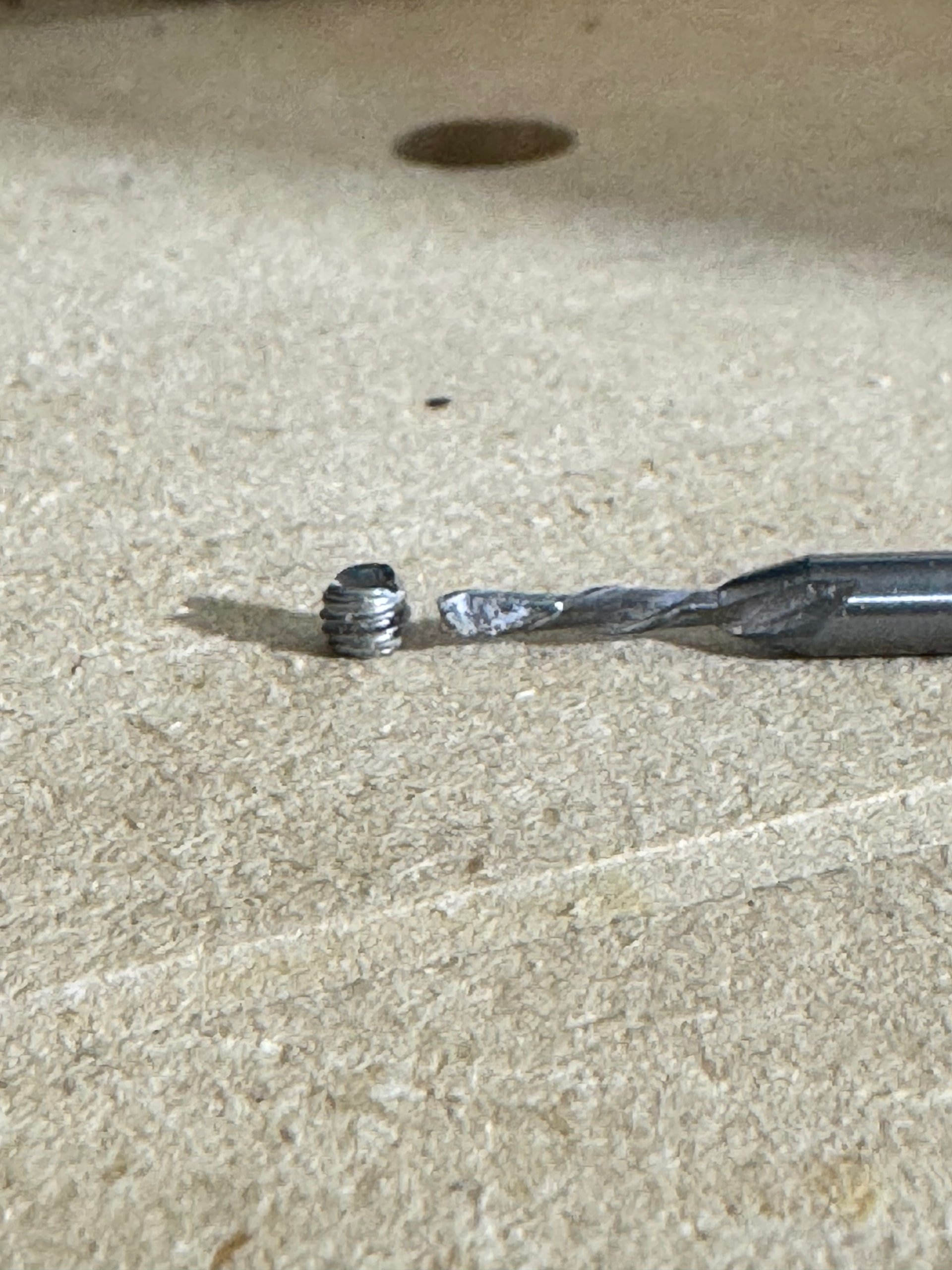

Found a tiny flat head set screw on my spoil board
Help, found this tiny flat headed set screw on my spoil board after a carving run on my stock Altmill 4x4 with the originally available spindle kit. I can’t find a home for it. Wondering if anyone has an idea where it came from. 1/16th down cut bit for scale.
Any ideas would be appreciated.
Check your spindle, specifically the screws on the electrical connector. I had a screw come loose from I think the clamshell on the connector at the end of the cable. I might not remember it exactly - the screw could have come from the connector that is part of the spindle.
That’s exactly what it was. Found it about a half hour ago. Thanks for sharing the fix.
