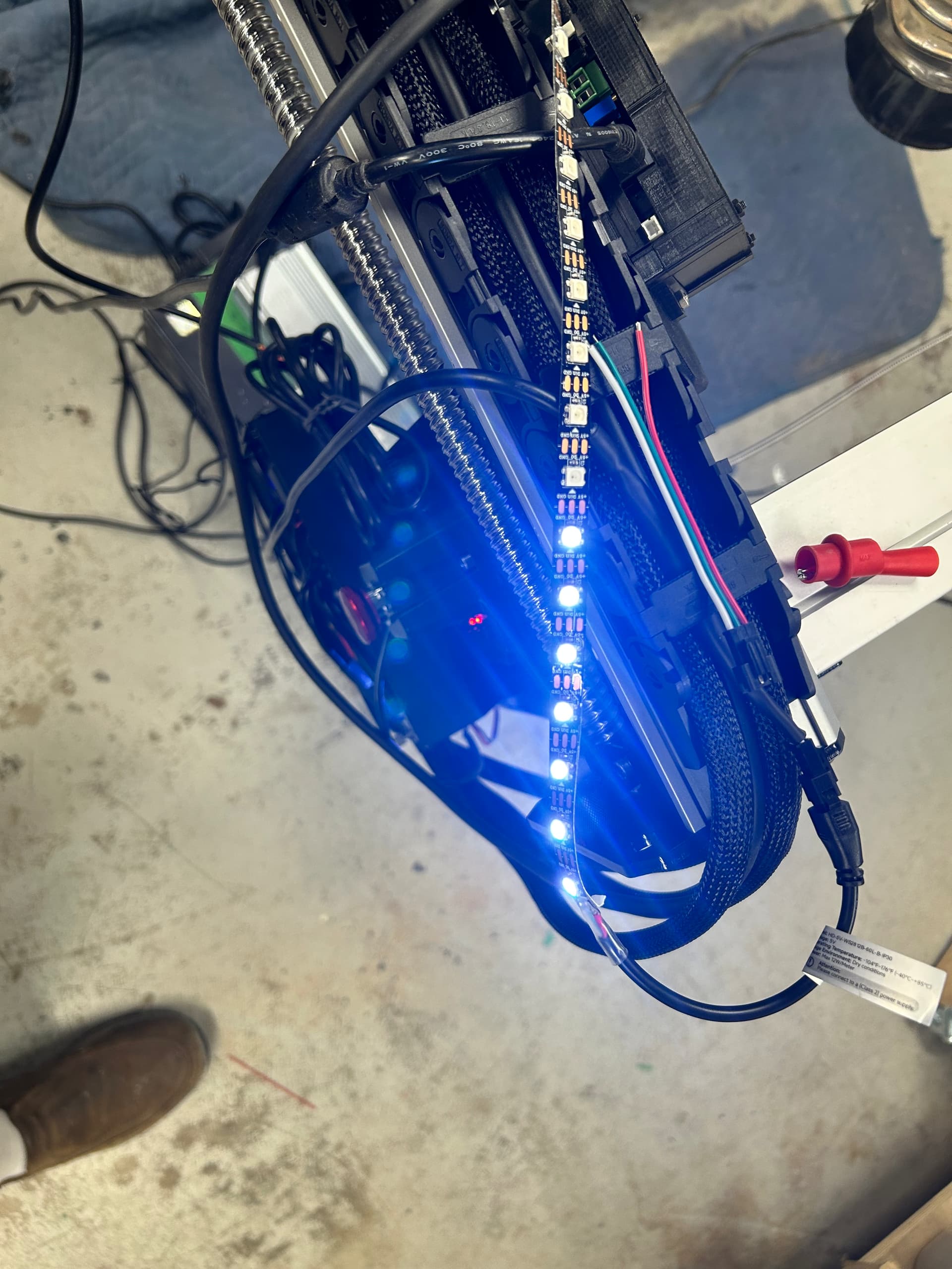

Decided to take a step back and wire LED strips, thinking this should be a no problem easy project. Again a fail, have had 1 light come on sporadically, but not all the time. Changed the strip light setting to 60 in the firmware. Have 5.12 volts at the end of the string but no lights. Continuity is fine on wire I made up on all three terminals. Using the BTF WS2812B 1m 60 LED strip as the link from technical handbook is dead, assume this is the updated version?

The LED lights on the other hand are still a no go. Anyone had this issue with the updated BTF lights? Link for something that does work in 1m 60 led strip?

The led strip is something I cannot help much with either. I could go down the usual suspects like telling the strip is directional, look at the arrows on the strip; the power supply needs to be connected to the slb, not at the extra wires on the led strip and maybe some more captain obvious remarks. I however read between the lines you are more than capable to avoid andor correct the usual mistakes.
Maybe you are in a position to cut the strip down to a single led to see if you are able to drive these ledstrips at all?

The link to the BTF lights on Sienci page is dead. A search of BTF WS2812 brings up the ones I ordered which are now WS2812B. This is what I ordered.

I assume that, when you simply connect the power supply the leds, they all light up, yes?
I’m assuming this is a bad strip of LEDs at this point. Have ordered another one.

The WS2812 family of “pixels” are a combination of RGB LED and shift register-like IC chip; they require a specific digital “protocol” on the input pin to do anything. (The alternative are LED strips that only have RGB LEDs on them, without the special IC chip) The LEDs on a strip/string are individually controllable, so the entire string does not have to be showing a single color.
Some debugging ideas:
  • is the polarity correct? Reversing + and - is usually a bad or very bad thing to do, even though the WS2812B includes a reverse polarity protection circuit.
  • are you connecting the correct end of the strip to the controller? On the correct end, the 3-wire connection is power (5v and gnd) and Digital_IN, while at the other end it is power and Digital_OUT.
  • The protocol for turning these LEDs on involves sending a color value to each individual LED on the strip. If you have 20 LEDS, you should send 20 color values. If you only send 3, only the first 3 LEDS will light up. The SLB-EXT has a setting for how many LEDS are in the strip. While it is unlikely, a bad value there (like 0) could possibly result in this type of problem.
  • You might have a 12v RGB strip. See the Sienci docs page if you have this type, as the instructions are different.
  • as with many cheap imports, the strip might be bad. You could try hooking it up to a cheap arduino to check. For some simple Arduino code to use, tell the Google to “provide arduino code for simple WS2812B led strip test”

New string of LEDs slightly different results.
More than one working but definitely not as it should be.. I’ll try a different PSU but have seen others hinting at issues on the FB group as well.. makes me wonder if there’s a bug with new gsender possibly?
@Bnb187 I know that I have asked this before, but at the risk of being a pain, I’ll ask again. When you connect the power supply directly to the led strip - no connection to the SLB - do they all light up?
I have two strips and neither light up with only 5v hooked up with no data.

My OCD has engaged on this now.. have tried 2 different power supplies, 2 different LED strips. Have now ordered a basic Arduino starter kit to test everything exclusive of the SLB.
So I tried to open a support ticket.. in the upload photo/video of my issue it won’t accept a JPG??? WTF!?!?
I have now run both strips successfully off an Arduino with the same cord I made for SLB so gonna have to say this is not a LED/PSU issue..
