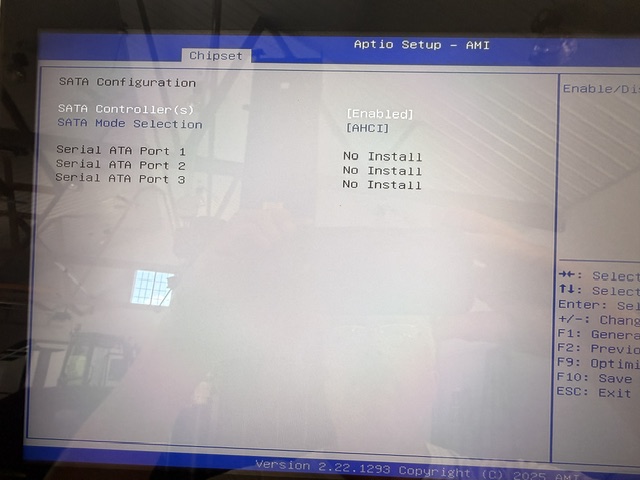

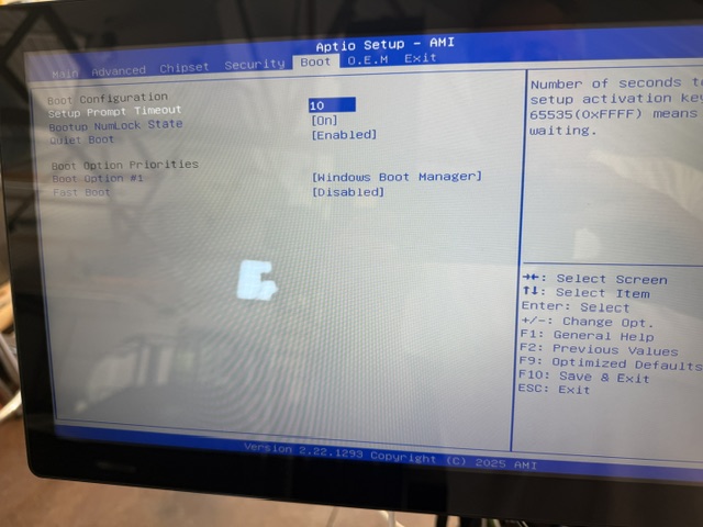

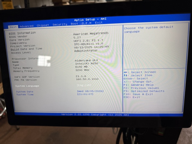

I received my gControl Panel Computer as part of my AltMill order and immediately ran into a problem. The unit boots to the AMI Aptio BIOS setup screen and will not boot into Windows. After investigating the BIOS thoroughly, here is what I found:
  • Boot Option #1 is set to Windows Boot Manager but the system loops back to BIOS regardless
  • Advanced → NVMe Configuration — No NVMe device found
  • Chipset → SATA Configuration — Serial ATA Ports 1, 2, and 3 all show No Install

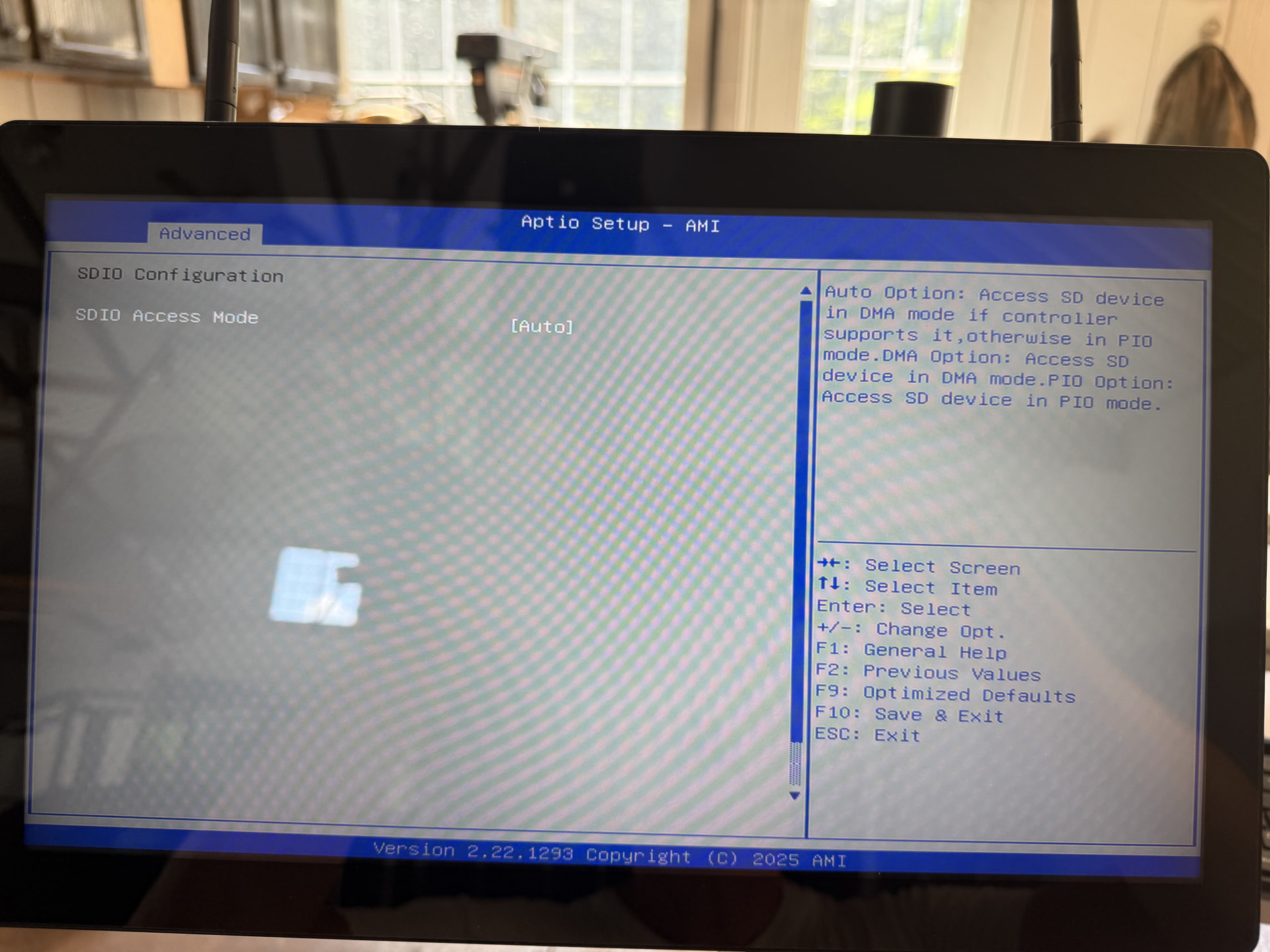

  • Advanced → SDIO Configuration — No SD device detected
  • SMBios Configuration — All fields show “Default string” suggesting the unit was not properly configured before shipping
No storage device of any kind is being detected in BIOS across NVMe, SATA, or SDIO interfaces.

it can’t find your gcontrol’s ssd drive. if you can pop the cover and make sure ssd is seated correctly. it might have loosened up during shipping.

As @Altmillal1114 has adroitly pointed out, It looks like your SSD is not being recognized, as it should appear in the boot options.
The machines are tested up to the Windows setup screen (OOBE) before shipping, so the SSD may have become loose in the slot.
I’m sending a video showing how to open the machine and reinstall the SSD for testing. It’s a fairly simple process, just pull the hard drive chip out, then re-seat it and tighten the screw back down.

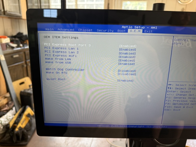

Post a picture of your boot tab and advanced tab. This doesn’t show ssd
