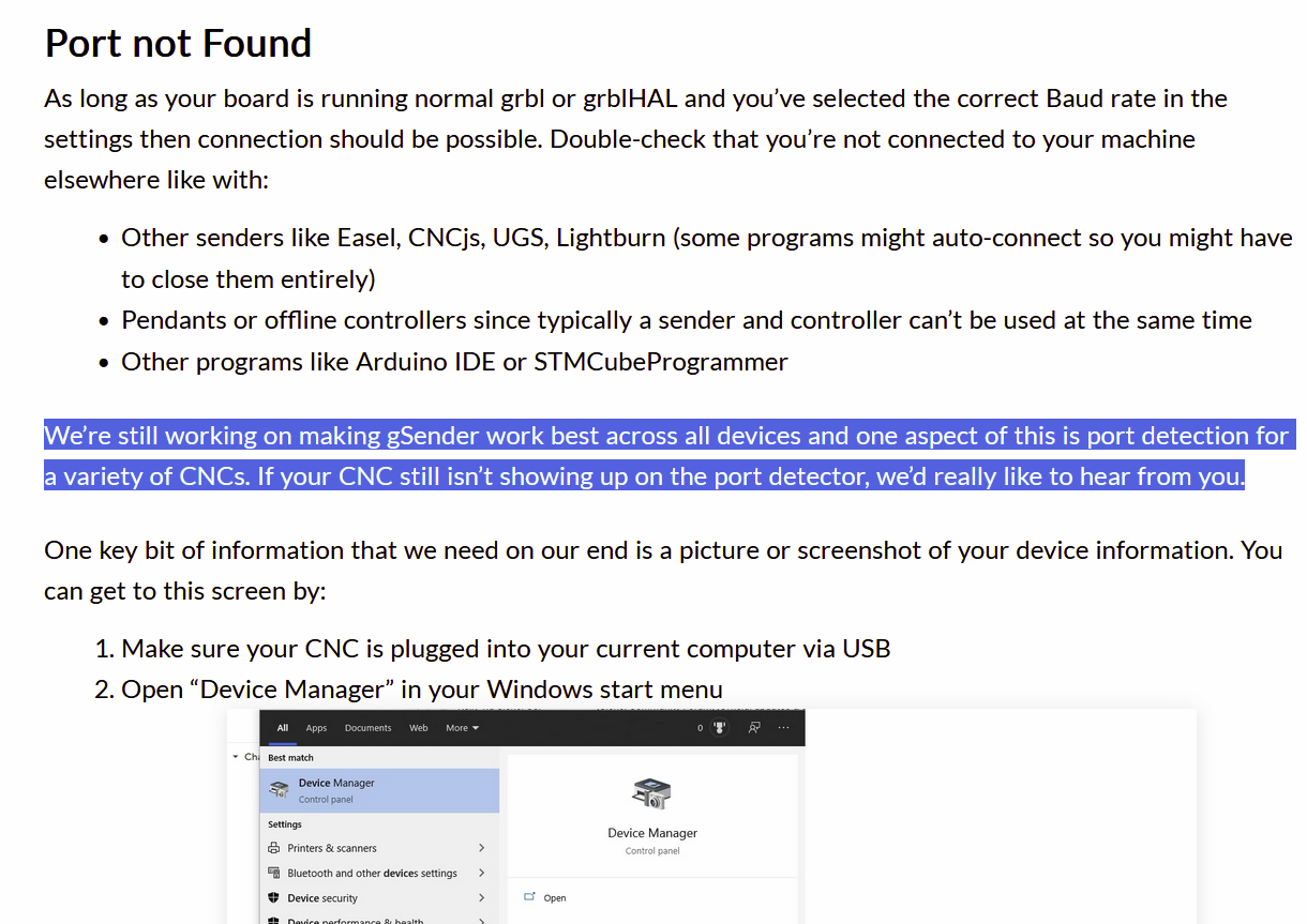

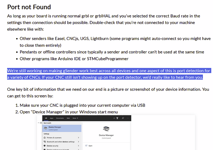

I am in no possition to help for I am not a wiz like you are. The one thing I can do is point you to this here page where sienci offers to look into making gsender available to more and more controllers.
They essential ask you to help them help you. Maybe something to look into?
Found here:
I know your problem is not a port not found, or it does not seem like that, but it sure as hell aint connecting either.
Worth a shot?
