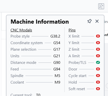

Just setting up my Altmill 4X4 using gsender 1.5.7 and am getting an alarm 12. None of my sensors are triggered and I don’t know why I’m getting the alarm or how to remove it?

@Dan3 Alarm 12 is not on the list. Error 12 is. It’s important to specify if you’re getting an Alarm code or an Error code. In this case, since there is no Alarm 12, can we assume you have Error 12 ?

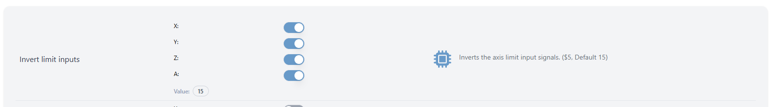

Check the value of $5 (Invert Limit Inputs) - default for the SLB-EXT is 15 (all enabled).
Past that it’s likely a wiring issue.
You can see what pins the firmware is reporting as enabled in the Machine Information flyout to narrow it down - if it’s all limit showing as enabled or just a specific switch
