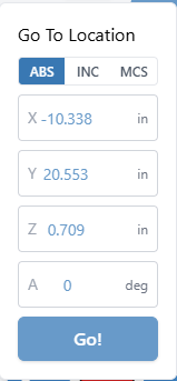

I used the GoTo (paper airplane) , set Z to 0 and hit Go!
Shockingly, the router went down about an inch and then back up to Z=0.

When you click the paper airplane (Go To Location), a dialog box pops up. I set the value of Z to 0 and then click Go!

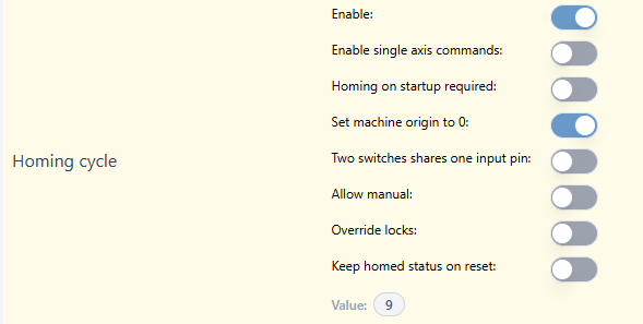

Homing cycle Enabled

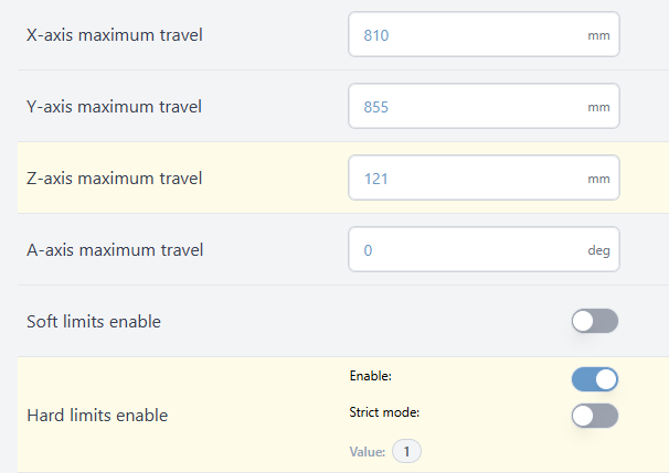

Soft limits disabled

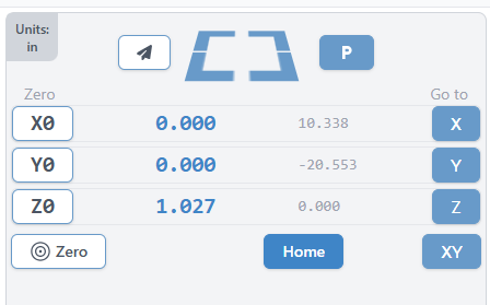

ABS refers to the material coordinates x,y,z.
Below is the material and machine coordinates after pressing “Go to XY”
