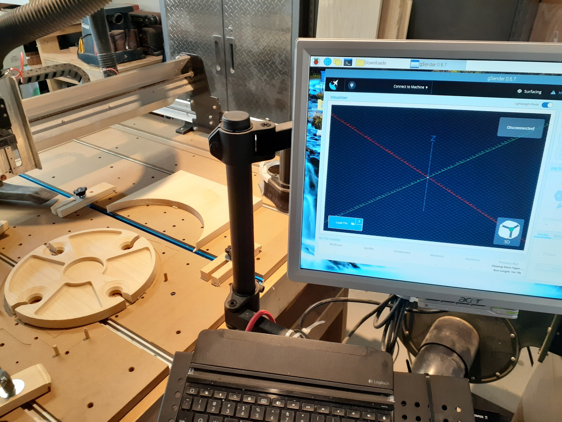

Chris, I don’t know if it was the heat (35-40’C) in the shop or g-sender but when I tried Ver0.6.7 on my RPI4B the time lag between g-sender & what the longmill was doing was well over a minute in duration, also noted that it was running the longmill at 2/3 feed speed. It then locked up with the longmill back at zero with job done but screen showing only a 1/3 completed. I the reverted back to V0.6.4 & it ran first 2 files fine but when I went to run third file it decided to offset 2 of the 4 tapered holes I was doing. On the fourth file which was to create 4 hollows around the tapers it also decided to a) lag & b) cut one of the hollows twice as deep as the others. I thought maybe due to the heat it might have been the Pi but I didn’t get a high heat warning & also have a fan in that unit. Today with a cool 30’C I tried V0.6.4 again running the dish file & had same issues. Finally I ran 2 of the files with UGS & it showed no issues. I’m going to revamp the files to try & save the folding wine table I was making & retest again with a fresh RPI OS & latest version.
UPDATE: I managed to set up a new OS & using Ver. 0.6.7, did up 3 files to salvage project & noted the following:
  • had to reboot after running each file as file wouldn’t load into visualizer.
  • First file screen froze at 9% done. Gcode/router ran complete code. Had to reboot when done.
  • 2 & 3rd files: time lag between what screen showed & router position at finish was just over 1.5 min.
    Ran last file in Lite mode, no difference in gsender time lag.
    First image is 1st file frozen at 9%. Second one is completion of cleanup files. Just a bit of sanding & folding legs to do
