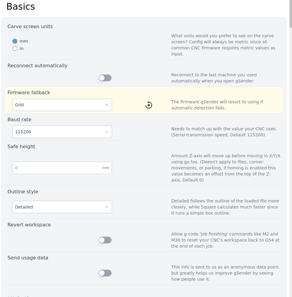

It might help to post your log file. I’m on Linux and my gSender log is at “~/.config/gSender/logs/main.log”. I’m using the AppImage but I would expect the logs to be in the same place for other installations.
I’d double check the Basics section of the config if you haven’t already. Try the other Firmware fallback if you haven’t. It’s worth a shot.
