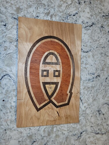

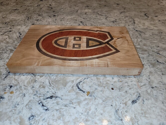

So gSender hung a few times today, not sure why,
One time it was seconds from finishing and it just dug into my work and ruined an inlay.
I had to disconnect the usb restart the job.
There is 8 gcode jobs to get this far, I am happy enough with the work, but it was frustrating
