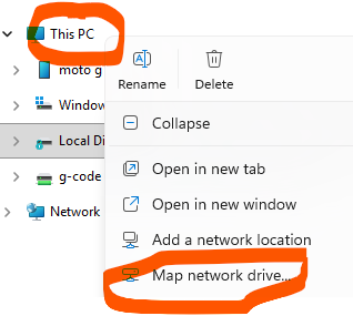

@Cam135 how does the server show up? Using the UNC naming convention (\\server\share) or with a drive letter?
If UNC, try mapping it to a drive letter instead.
I’ll have to look when I get home, my techy neighbor help set it up so I honestly have no idea what UNC is haha
@Cam135 UNC is when you refer to the server using \\servername\share instead of a drive letter.
There is no drive letter in front of it. That I do know. It just says file share and I think it has 2 green arrows or dashes in front of the word file share.
@Cam135 That might be the problem. I’m not at my computer to give you detailed instructions, but if you right click on File Explorer, you should see an option to Map a drive or file share. If you type in the UNC path that you see, it will assign a drive letter to it.
Thank chuck I’ll definitely look at tha when I get home.
@Cam135 In Windows 11. For the folder, you can manually type the UNC path or browse to the path you see in File Explorer
I looked at the Folder when I got home and it is labeled as Z drive. I erased the IP address haha not sure if that even matters but this is the folder I can’t see in gsender.
@Cam135 hmmm. Weird that you can’t see z in gSender. Map it again to another letter (F?) maybe?
Your internal network IP is likely 192.168.x.x. or 10.10.x.x. So no real security issue in showing it here and no need for the redaction.
@Cam135 oh, and when you click on Z, do you have to enter a password? Or does it automatically reconnect?
it connects automatically. Funny enough Gsender must have knew we were talking about it and scheming ways to force it to work and got scared. Because I opened it after renamed the Z drive to F and both Z and F were there. I love software! Thanks for all your help its very much appreciated.
