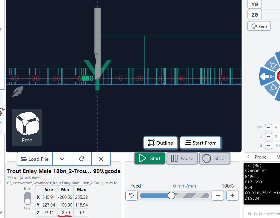

Chris, using V carve tool path, I set the flat depth at 0.08. Zeroed Z with paper method and started job. V bit immediately plunged into corner of material approximately 0,65. This was on earlier projects . Lately using very methodical Zero procedure. everything working fine.

Chris, flat depth issue returned. Have attached Vectric and G code files. 90 vbit plunging way past designated flat depth. Attempting inlay. First attempt successful’. Lately not so much. Clearance tool path works as programmed, Preview and G sender visualizer all consistent. Franken V bit plunges double assigned flat depth on first pass. ignores pass depth edited in tool data base. Please advise. Thanks, Mike

@longmillmike looking at your file, it seems that the lowest point is at -2.79mm = -0.11 inches which sounds like it’s what you want to have happen. Also when I run the file it behaves fine.
For you when the bit “plunges double assigned flat depth on first pass” does it go double the distance in the visualizer as well so the bit is much further below the material? Or does it look correct in gSender but moves incorrectly on your machine itself?
