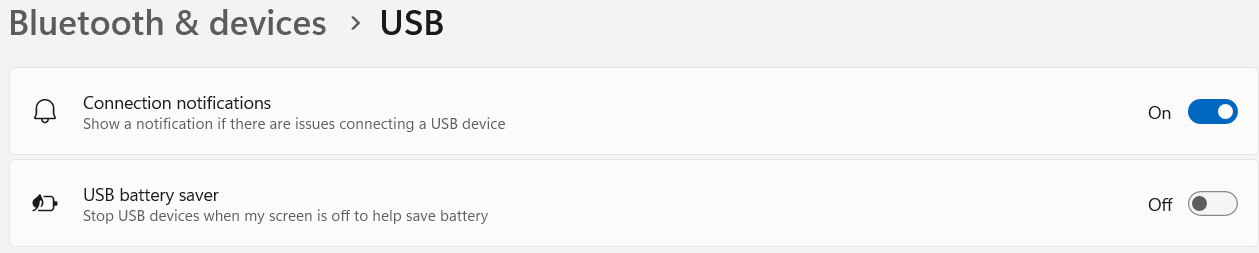

@Jimc137 confirm that, in windows power settings, you have turned off ALL power saving settings to USB. Windows updates is known to change these settings.
I just checked, I don’t believe anything turns off, goes to sleep, etc. when plugged in, which is the case.
@Jimc137 You could be right, but that screen cap does not confirm it. You need to open power settings and check to see that Windows is doing with all USB connections.
Well, it’s been connected for 4 hours, and it hasn’t disconnected yet! I guess I’ll just cross my fingers and hope it is a windows thing…

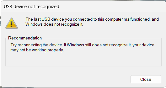

I was doing well for a while but my disconnection issue started popping up again. When it occurs, I get this message:
If I turn off the controller and turn it back on, it usually fixes it, but then I need to re-home and start over. I’m using gSender 1.5.7 with my Altmill.

@Jimc137 The odds are that it is a bad cable or one that is too long. You could also confirm that all power saving settings for usb in windows are turned off.
