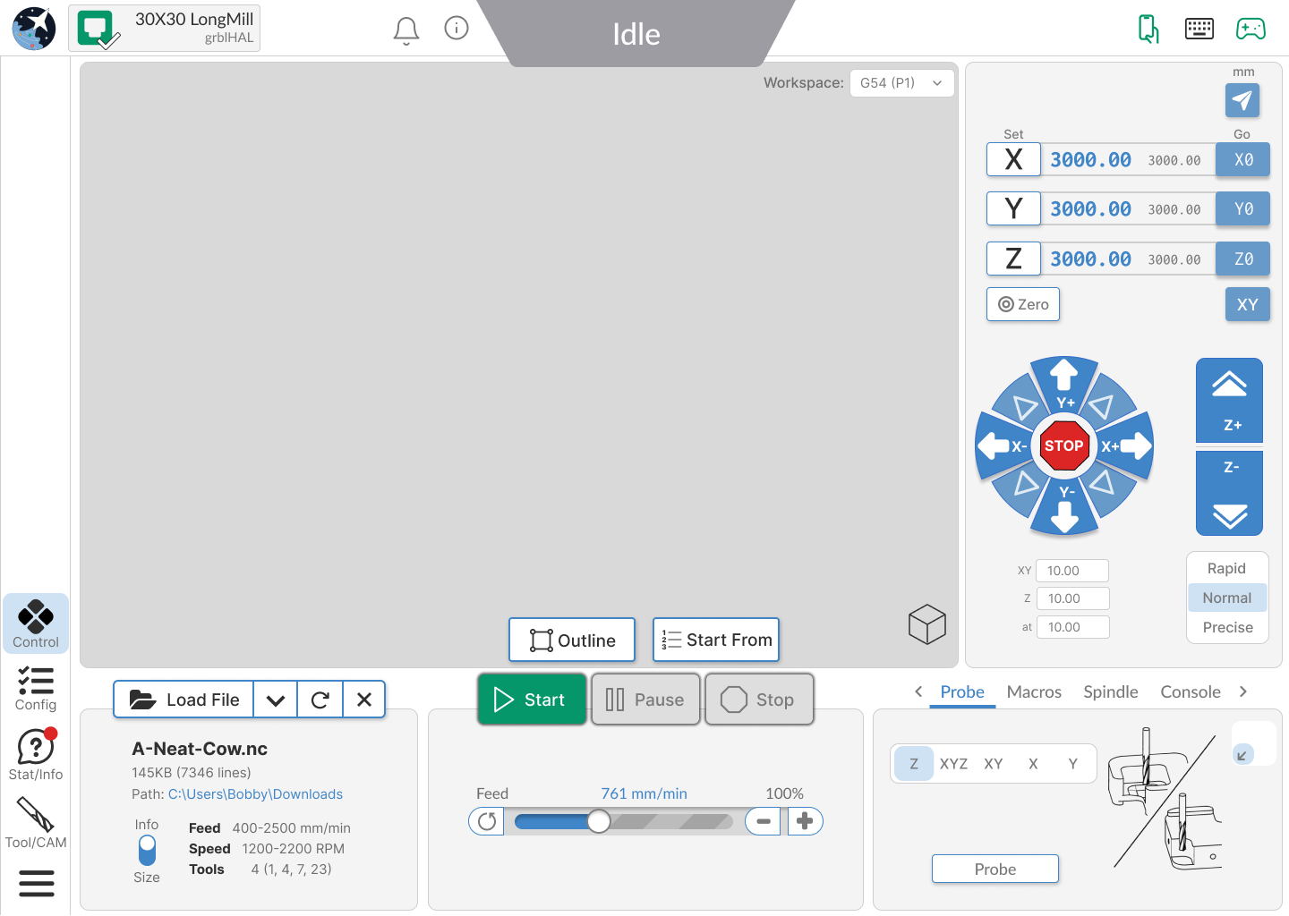

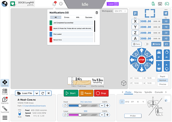

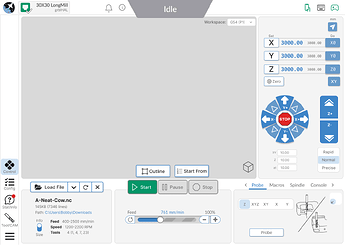

I prefer option #1 (=current design). I think the new treatments try to give visual weight to too many things and it begins to be hard-to-understand. My eye does not know where to go and thus it feels confusing. Some of the ideas, like adjusting the feed rate and spindel speed certainly are big bonuses! And surely making sure that the UI scales to different screen sizes is important. I use the software on a screen with 1280x1024 pixels, so normal desktop view is one I use.
I like treatments 2 and 3.
I like the color and the layouts.
Still like Version 3 however am a bit concerned about loss of visualizer size. Maybe a reduction in the amount of vertical space the notification center occupies could allow for a bit more vertical height for the visualizer.
With regards to Version (Treatment) 3 I prefer screens 2 & 4 with regards to disconnected & connected modes.
I prefer Treatment 3, but hope that the console (and perhaps the other features with console) have the ability to “pop out” to show a larger console window. It is a little busy, but I think, as long as items are logically arranged, it’ll work well.
I prefer Treatment 3.
I prefer #2.
The overall layout is clean and easy to figure out.
Treatment number 1 is the nicest in my opinion, this with the option to customize some colors would be more than enough

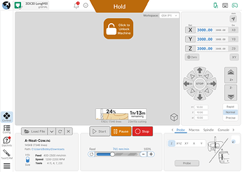

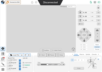

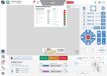

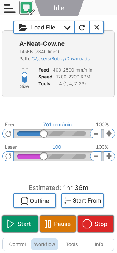

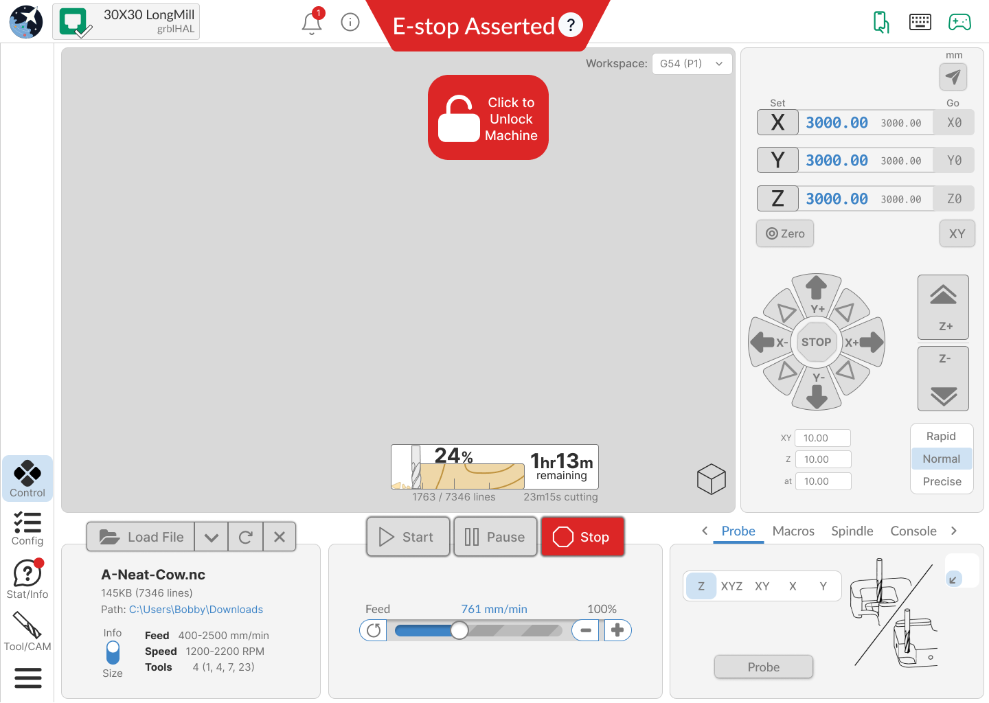

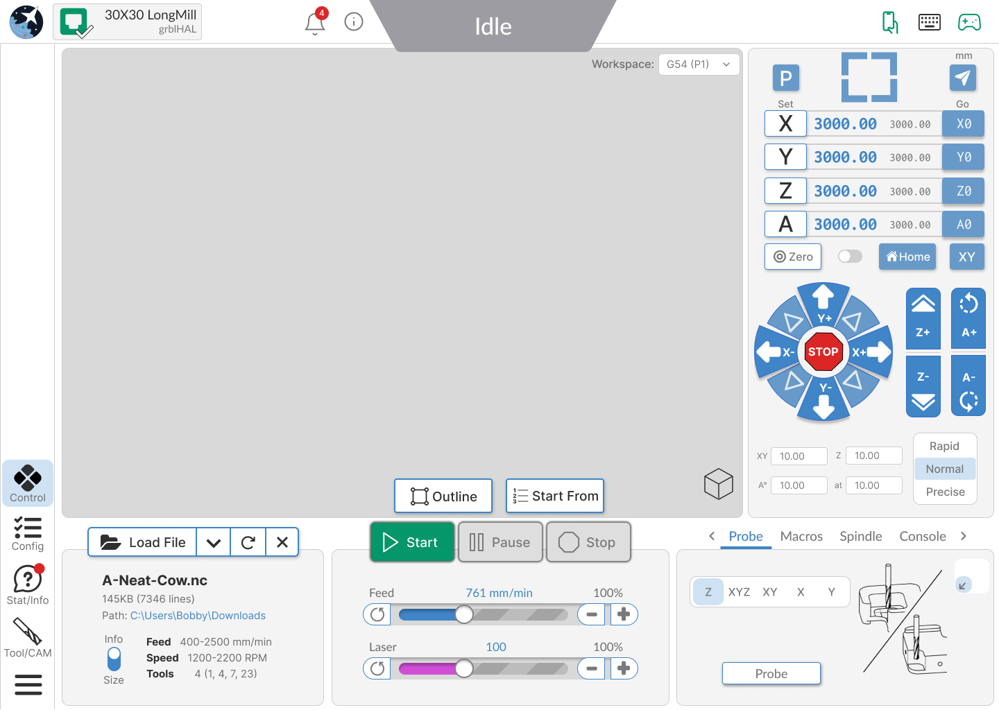

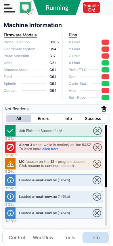

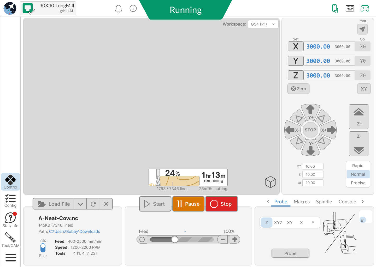

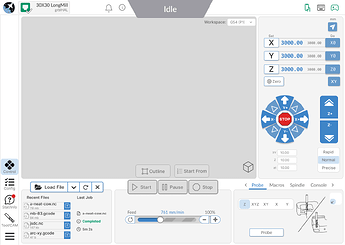

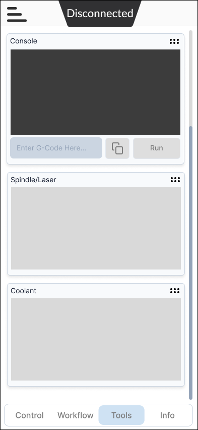

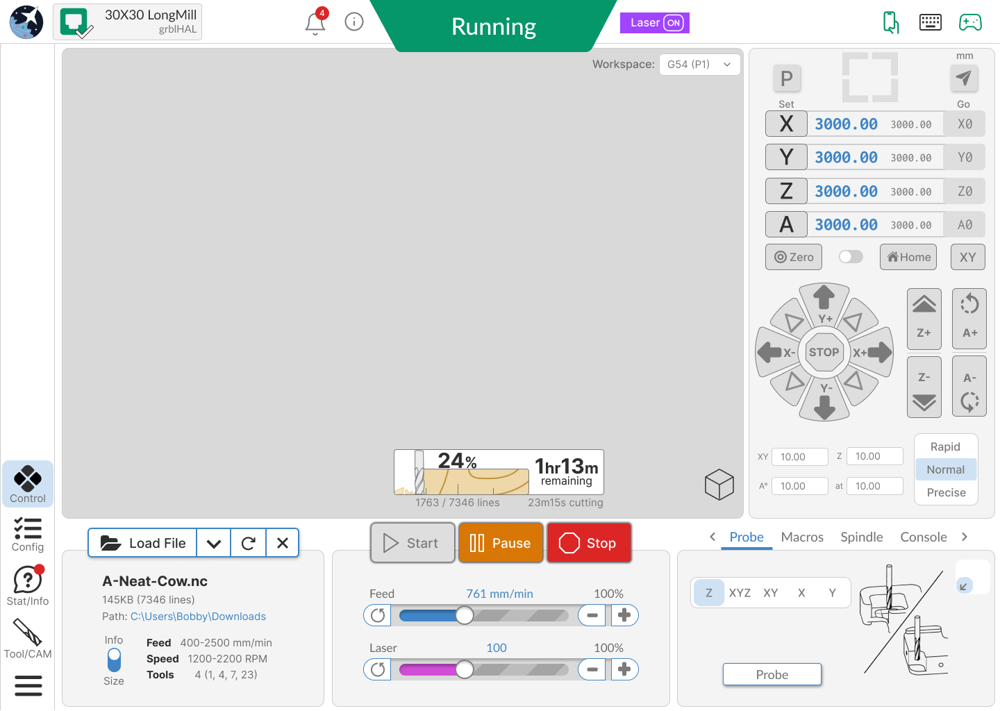

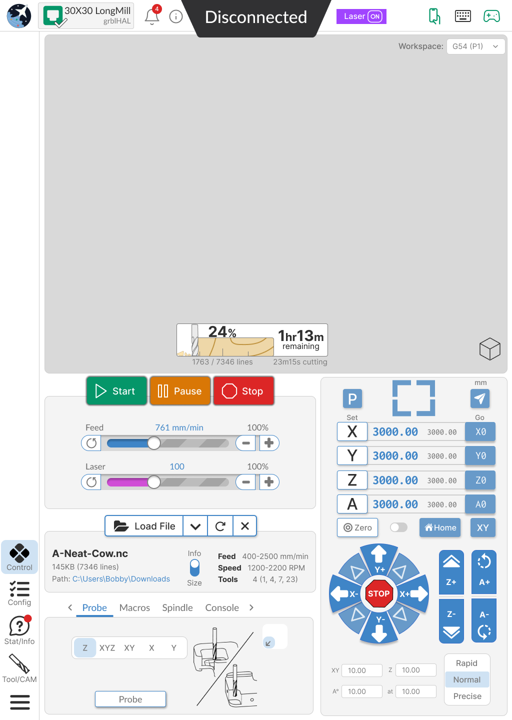

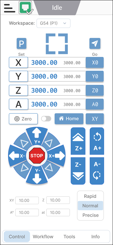

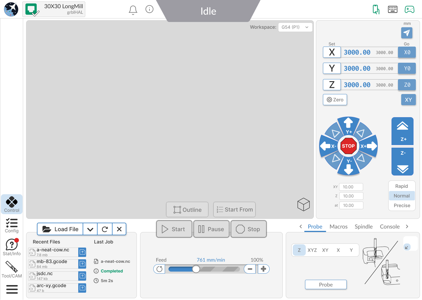

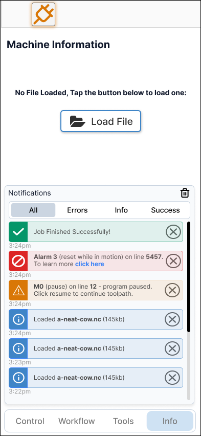

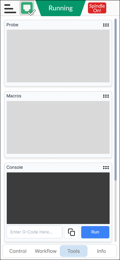

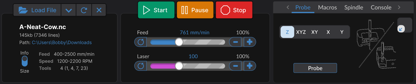

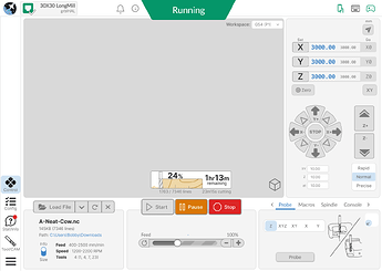

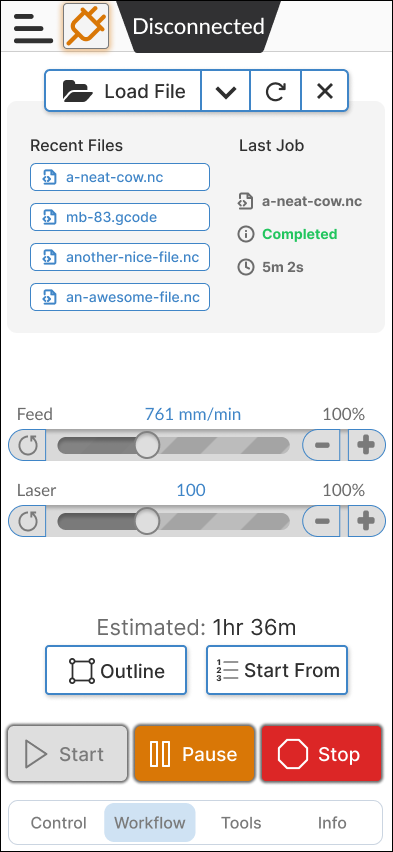

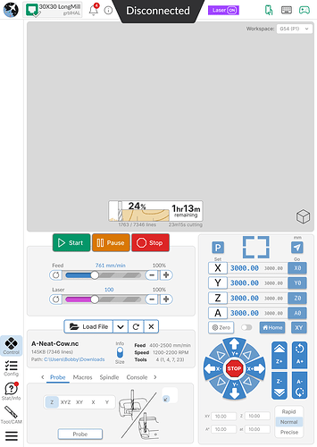

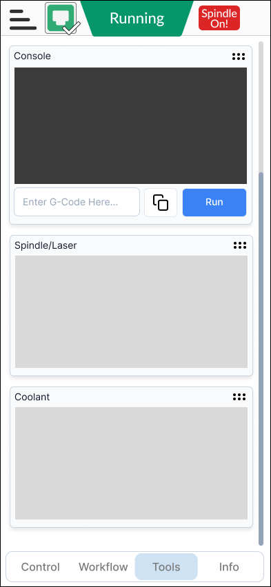

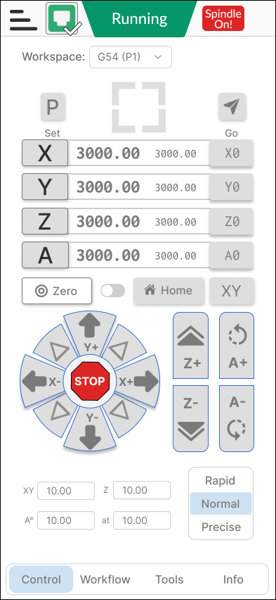

Hey folks,
Thought I’d pop in to share some of our thoughts and progress. Below is the direction we’re leaning - the overall layout of the application should be similar and familiar to current users with some hopeful improvements to other areas that have been mentioned internally and in your feedback. We’ve broken down the application into a few common states - basic (out of the box, no features on), advanced (all optional features/accessories on) and some mobile and landscape treatments. We’ve also included some informational popouts/hover elements so you get an idea of the information contained.
If there’s specific point you still think are troublesome or you have general feedback/pain points we’ll continue to iterate over the coming few weeks. That said, in general we’re happy with the overall flow of the application and are working to touch up some of the rougher elements.
Basic
Advanced
Popouts
Mobile
Landscape

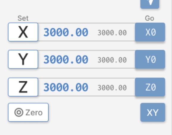

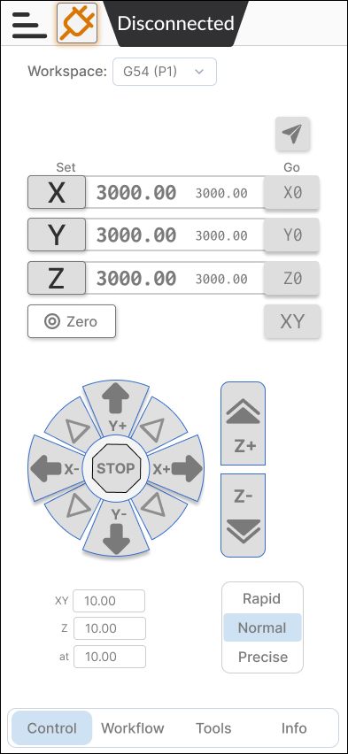

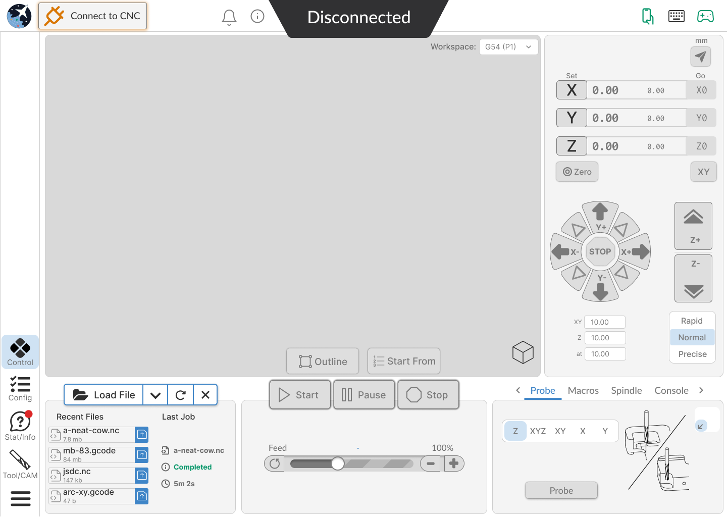

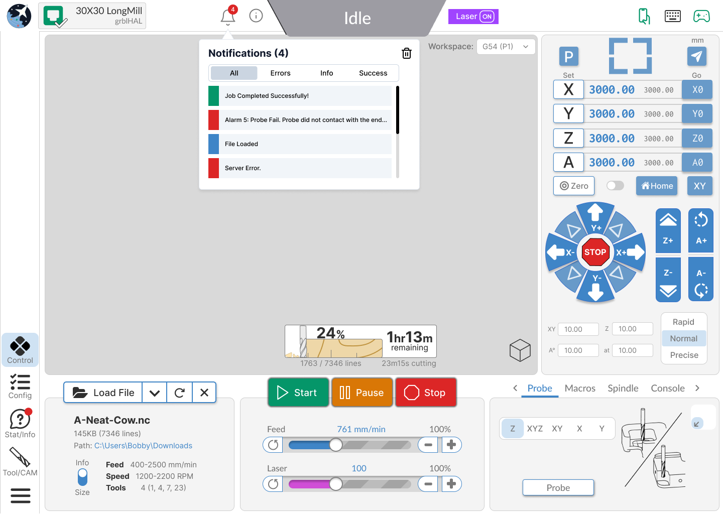

@KGN Please explain how this section operates.
I think it looks good. I’m sure in 3 to 4 runs I’ll get the hang of it.
A few questions/comments:
  • Please have a color-blind person give input. Might be some colors that work better together than others.
  • Will there be tool tips? I think those go a long way to help folks figure out how things work (like that icon in the upper right – is that a millimeters/inch selector?)
  • Can you pop out the console to a larger window?
Will these probable changes be suitable for plain old gSender or only gSender Edge?
Are they suitable for grbl or only grblHal?
  • The white axis buttons on the left are for setting your zeros
  • The blue buttons on the right are for going to axis zero
  • The individual white zero button with a target icon zeros all the axes
  • The blue button with the XY label goes to XY zero
Hope this was clear enough, let me know if you are still unsure about how that section works :slight_smile:
@JohnOCFII
We are taking into account accessibility when we start developing this new UI, color schemes is still something we’re thinking about.
Yes, there will be tooltips for many icons and other components in this new UI as I think they’re a handy feature to have.
Yes, we have this feature on the latest version of gSender (v1.4.7) and intend to keep it and have it working on the new UI update :slight_smile:
We will be rolling out this new UI update on gSender Edge to start with so we can gather more feedback and also fix any bugs that come up.
Once we are confident with its look and feel as well as its stability we intend to push it to the main version of gSender and off of Edge so the majority of users get to experience the new and improved UI.
This new UI was designed to work well with any firmware type that we support, which includes both grbl and grblHAL.
Hope these answer your questions :slight_smile:
