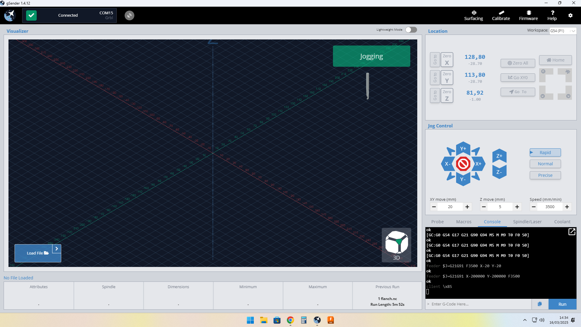

So today i found out why it jogs without moving the machine.
if i have rapid selected and on the X Y selected 20mm/min when i tap the keyboard it moves 20mm, but if i hold the key the sofware bugs out, it keeps jogging but the machine doesn’t, and only moves just ever so slightly when the softare stops jogging. I took a look at what happens in the console and when i keep the key down the XY feed gets multiplied and turn into 200000 see below image
if i set the in the setting default speed move /mm to 5 it’s fine and the rapid moves as expected when holding the key.
btw, i can’t do anyting untill the sofware gets out of that state, reseting it, closing the softare ar anything
is there a way to have 20 selected without having the sofware bug out?

i found the problem it was the -200.000 value on X and Y, i had it changed to a smaller value an it didn’t do it, now with 1.5.x you guys made it a more sane value and it doesn’t do that anymore , so i guess it its fixed
as you can see in my image i have 20mm set for one time jog, but holding will have translated that to the insane value
i believe that made GSender freak out thinking i was about to hit the machine limit hard
