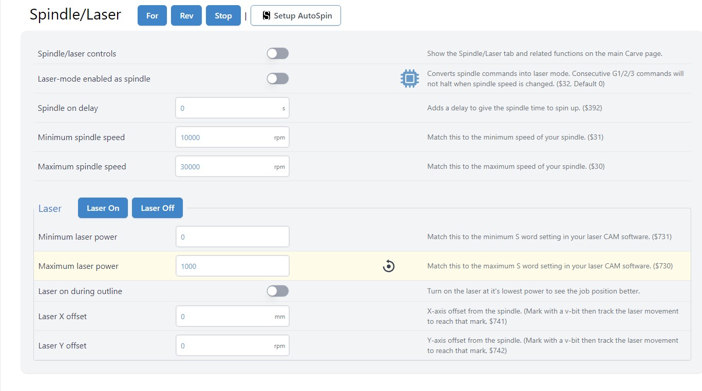

Hello all
I am having an issue where I set the max laser power to 1000 in Config-Spindle/Laser- Maximum Laser Power and every time I switch the Spindle/Laser slider to Spindle then back to Laser, or close and restart gsender it reverts back to 255. I can watch in console when I switch the slider to Spindle it sends the proper $30 value I set under Spindle, when I switch the slider back to Laser it sends $30=255 every time. It would not be a big issue except Vectric Laser Module uses S=1000 so any laser project I create in my VCarve Pro with Laser module , save the gcode and run it in gsender, the power setting is WAY off, (its expecting 0-1000 min/max and getting 0-255 min/max so burning way way hot)
I am using Win 11, gsender 1.5.1, Shapeoko Pro XXL with grbl 1.1f (NOT grblHAL) (gsender is ā€œsetā€ to Shapeoko)
Any advice would be hugely appreciated.

@DavidS To be clear, in gSender, you are on this config screen setting max laser power to 1000 and it reverts to 255 on exit?? Correct?
FWIW, I can duplicate your problem. In config, I set max spindle to 30000 and max laser to 1000 on a grbl Uno. With the spindle/laser slider on spindle, I entered $$ in console and $30 showed 30000 as it should have. Then, I went back to config and laser max had been changed to 255. I slid the spindle/laser slider to laser and $30 in console showed 255.
I’m sure all of this is old news to you, David. I’m simply documenting my process so that Sienci tech can replicate it.
I’ll add another observation to this issue. The description beside max laser power refers to $730. This is not a valid value in grbl. It is only valid in grblHal. That may be the issue.

Edit: Are you running a spindle or a router? If you are running a router, a workaround would be to see the max spindle to 1000 and not use the spindle/laser slider at all. $30 will stay 1000 that way. That is what I did when I was running the Makita router. I left $32=1, too.

Hi David, I was able to replicate your issue and can definitely see how it’d be frustrating. We’ll look into it and aim to get a fix into 1.5.3 :+1:
I’ll also mention that the reason other aren’t seeing this is specifically because this issue only affects grbl machine, not grblHAL ones

We released v1.5.3 for gSender yesterday. @DavidS Whenever you get a chance, can you confirm if this issue has been solved on your end on the latest version?
I will indeed. I installed 1.5.3 this afternoon and I will test it out on my machine/setup tomorrow. Results to follow
I ran 1.5.3 through its paces WRT the Laser $30 issue I was having and I am very happy to say it seems the problem is resolved with the update. Thank you so much for being so incredibly responsive and fixing this so quickly!
