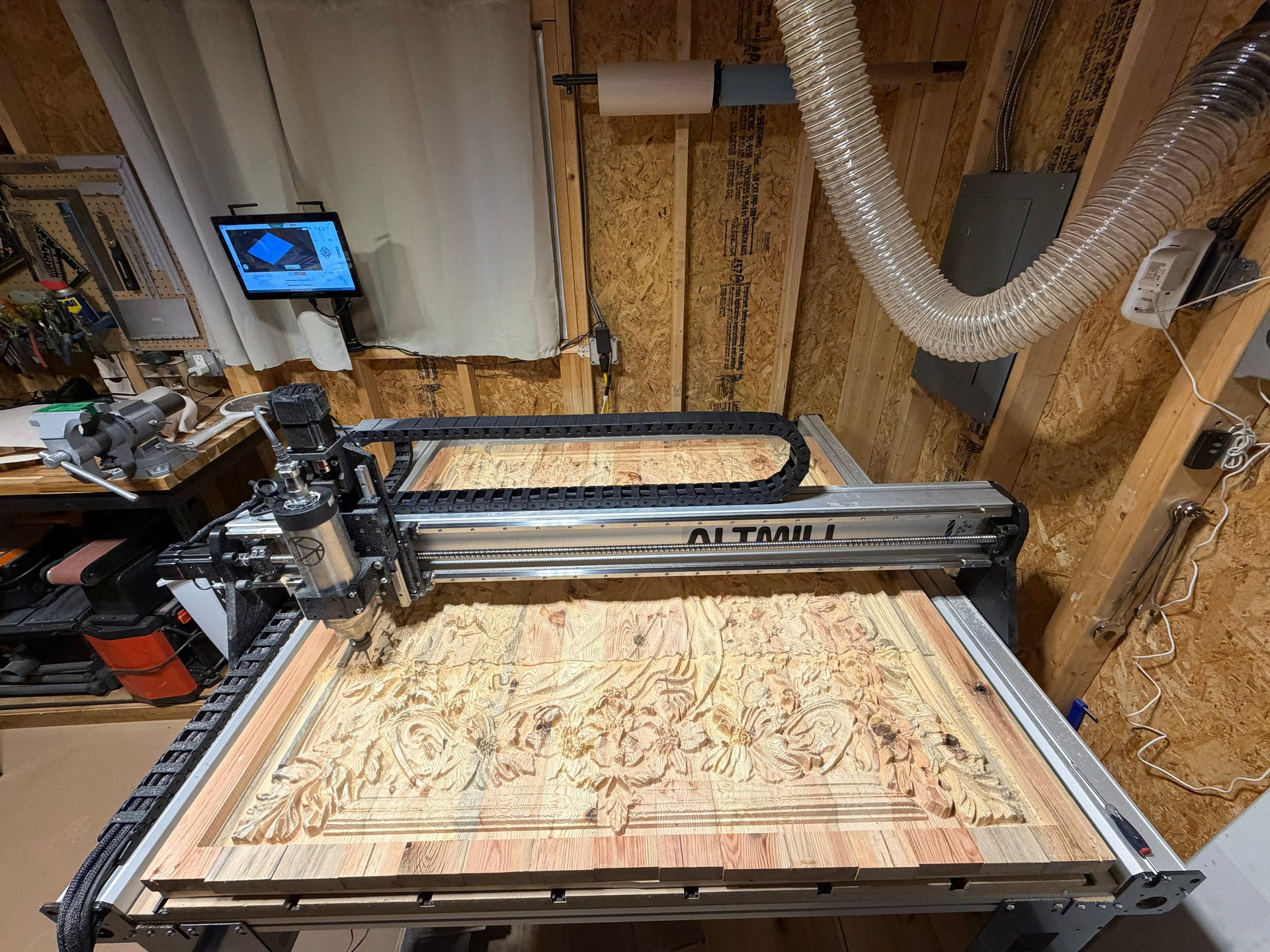

Hello everyone, I think I have discovered gSenders limit to my dismay. I enjoy 3D carving and am presently doing a 4’x4’ carve (HUGE =) On my Altmil 4x4 with Sienci Spindle. After doing my roughing pass I tried to load a finishing pass which has over 5 million lines. gSender will only load 87% of the file then lock up on my Sienci Controller (No Mods and Brand New). I then tried to load it up on gSender on three (3) different other computers and the exact same thing happened. All drivers, Software, Windows, and gSender are up to date on all three computers. I am running Aspire 12.5 to generate the file which comes out to a whopping 164MB. gSender will load all the other Roughing and Profile files but not the large Finishing File.
I then realized that I might be dealing with a Limitation in gSender or a bug. After reinstalling gSender and bringing all things to complete up to datedness (sp) the same problem happens on all three platforms and computers. I then began to increase my STEPOVER so as to decrease the file size, and after going from 10% stepover to a whopping 17% stepover my file size went from 164MB down to 86MB and gSender could now load it. MY computer has 24GB of memory with i7 cores (very powerful computers).
I realized that 17% Stepover was just under 5mil lines of code and hence possibly the limit of gSender. Which for me is VERY little. If I go to 15% STEPOVER (hence over 5mil lines) gSender Locks up and crashes. Is there a fix to this or am I stuck with an expensive paper weight?

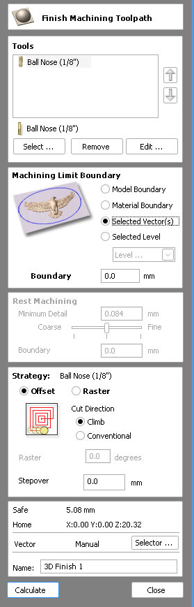

As a workaround you should be able to split the carve up by making a square and using ā€˜Selected Vectors’ as the ā€˜Machining Limit Boundary’ for the carve. The following is from VCarve 11.5 but Aspire should be similar.
You wouldn’t need to change the origin or reset Z so things should line up. Bear in mind that I have not done this myself.

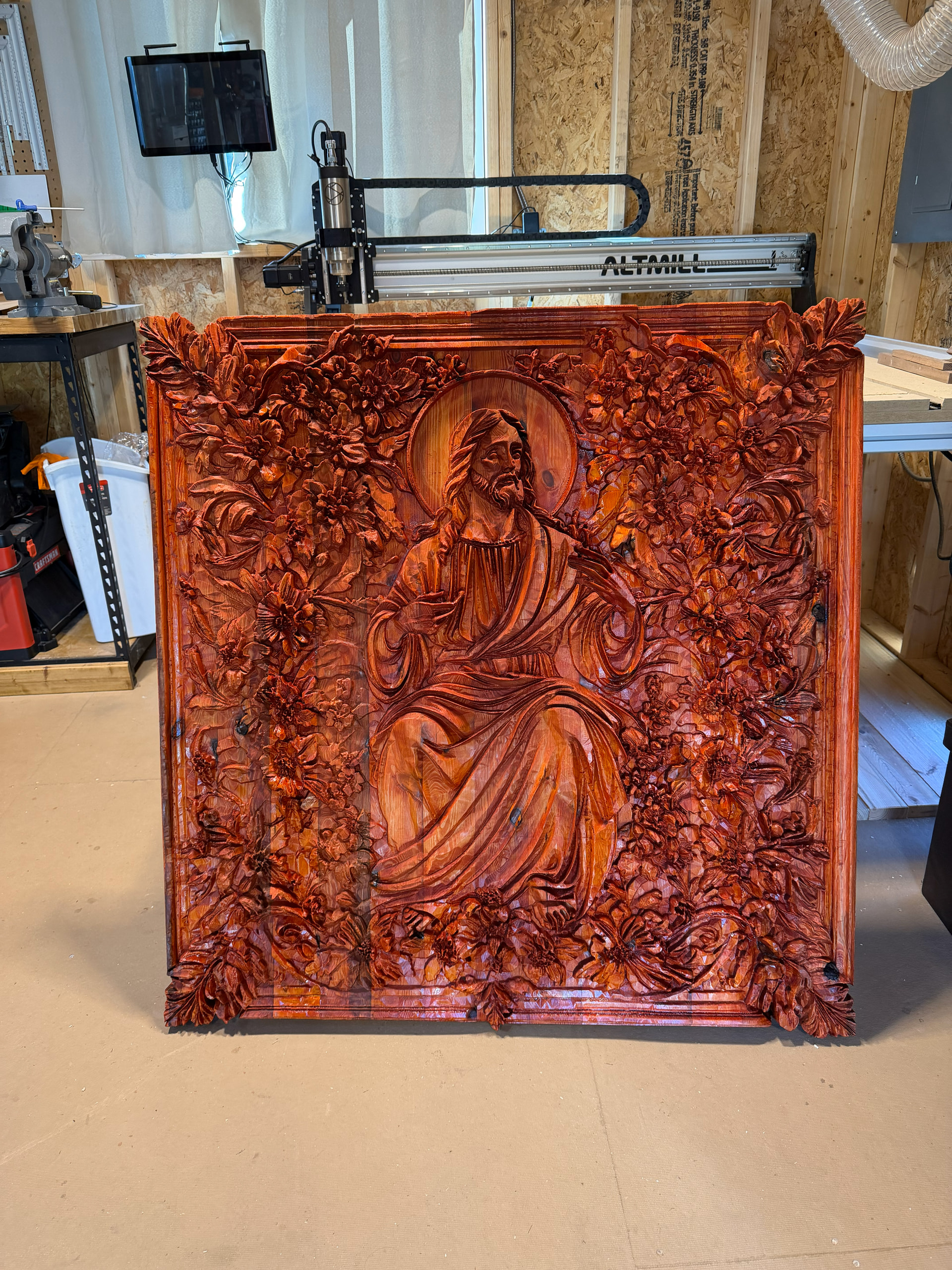

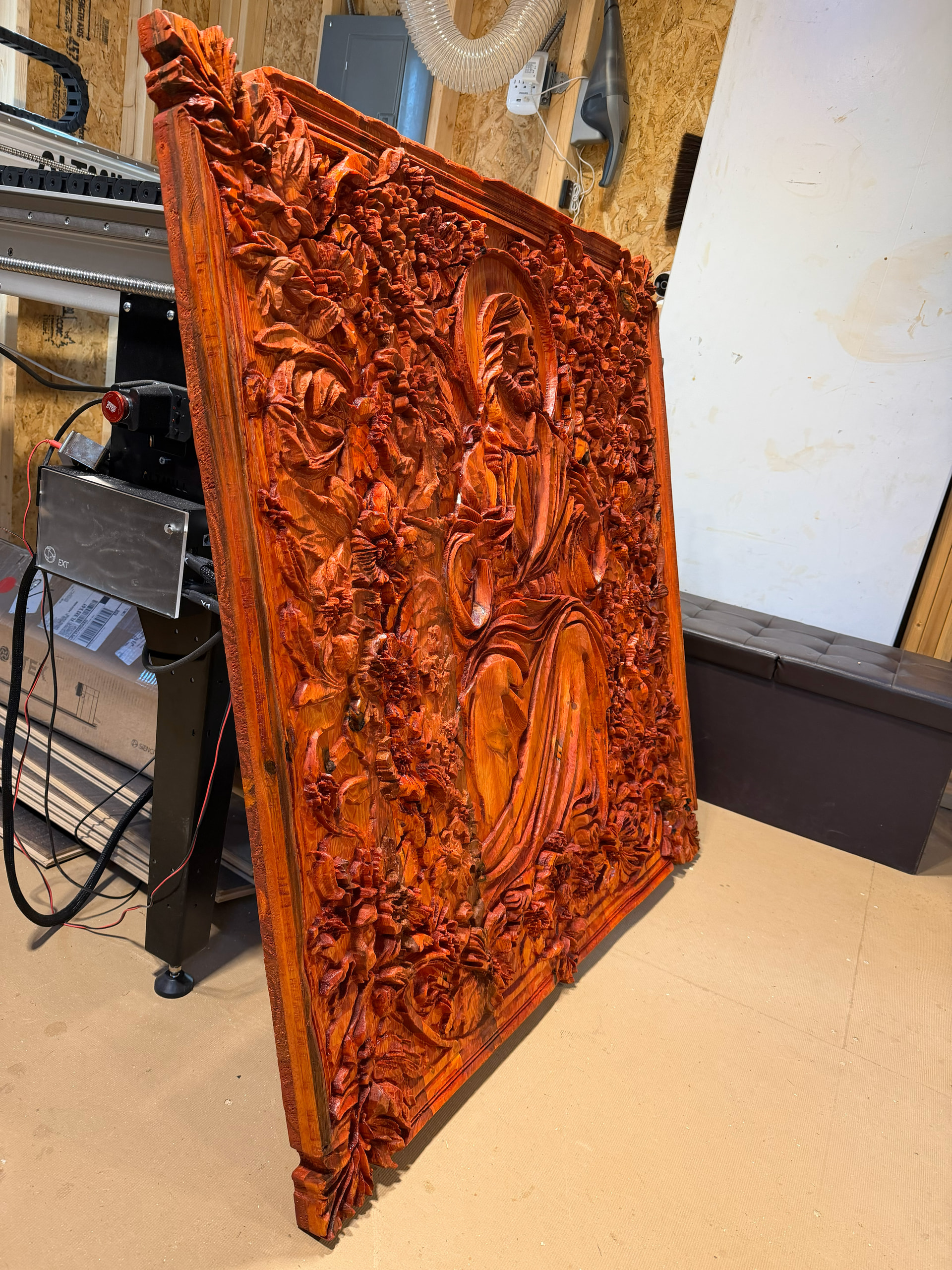

@Michael - Sure I’ll share =) - Here is the second phase of the base stain. I will be coloring his robe with a white transparent stain for blending. This will be hung in our parish church hall which seats 500 people. I’m calling it: ā€œChrist Sits with Usā€ and it will be for our parish breakfast and dinners.
I think that’s amazing! It’s great that it will be in a place where many people can appreciate it’s beauty.
