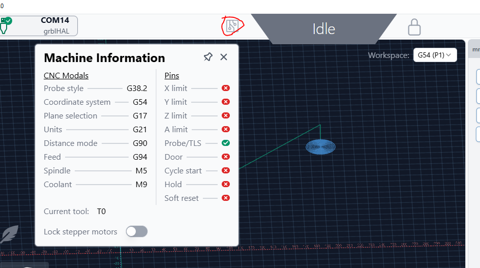

Hi guys, have question to Altmill gSender MAC users, I try to use Mac mini(Intel base) in Altmill, all works fine except probe, when I try to zeroing machine probe don’t have contact,all parameters same that I have in Windows computer, when I switch back to Windows computer - all works perfect. Can anybody have solution for this issues?
I run gsender on my old intel macbook and don’t have an issue probing with the auto zero touch plate. I wonder what is going wrong for you
What version of gsender are on for your mac?
Are you connected with usb or ethernet?
Which touchplate are you using?
Thanks for respond.
I use MAC Mini Intel, USB-C and USB A to USB-C cables connect to SLB-EXT, I try both cables , AutoZero Touch Plate.
gSender 1.5.7 touch plate don’t work, at gSender 1.6.0 touch plate works but spindle delay don’t - now I confused.
When I switch back to Windows -all works perfect.
@DanBtek when you make contact for the touch plate, are you seeing the orange contact light light up? And once that happens are you also then seeing it light up in gSender?
Thanks for respond, I fixed probe issue at MAC, in my machine it’s required to use 2 wires from probe while at Windows computer I use only 1, my spindle have good ground connection.
