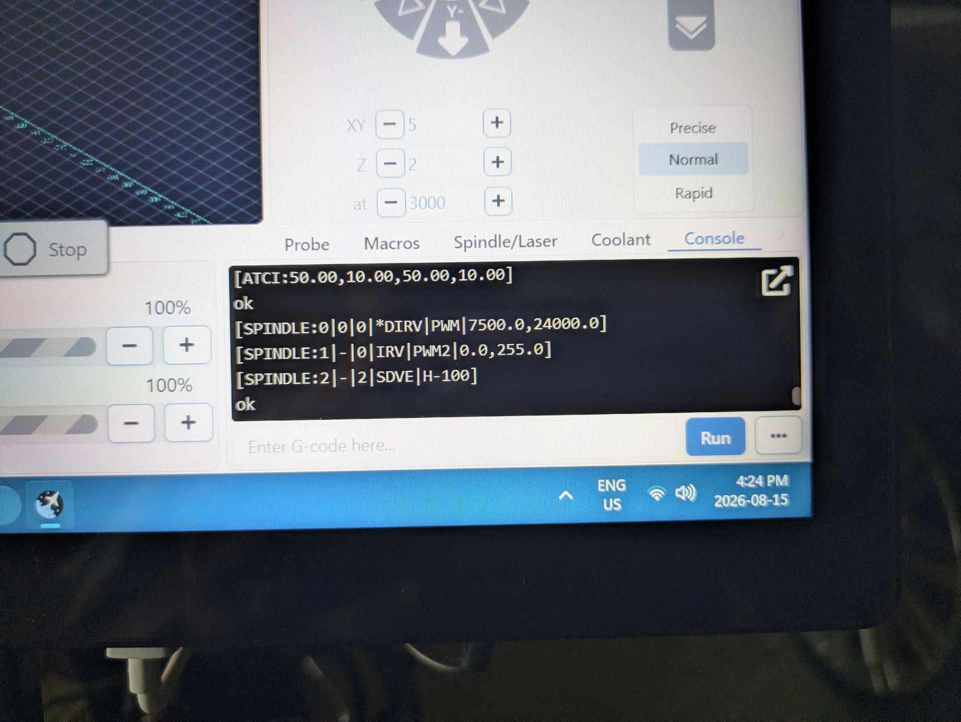

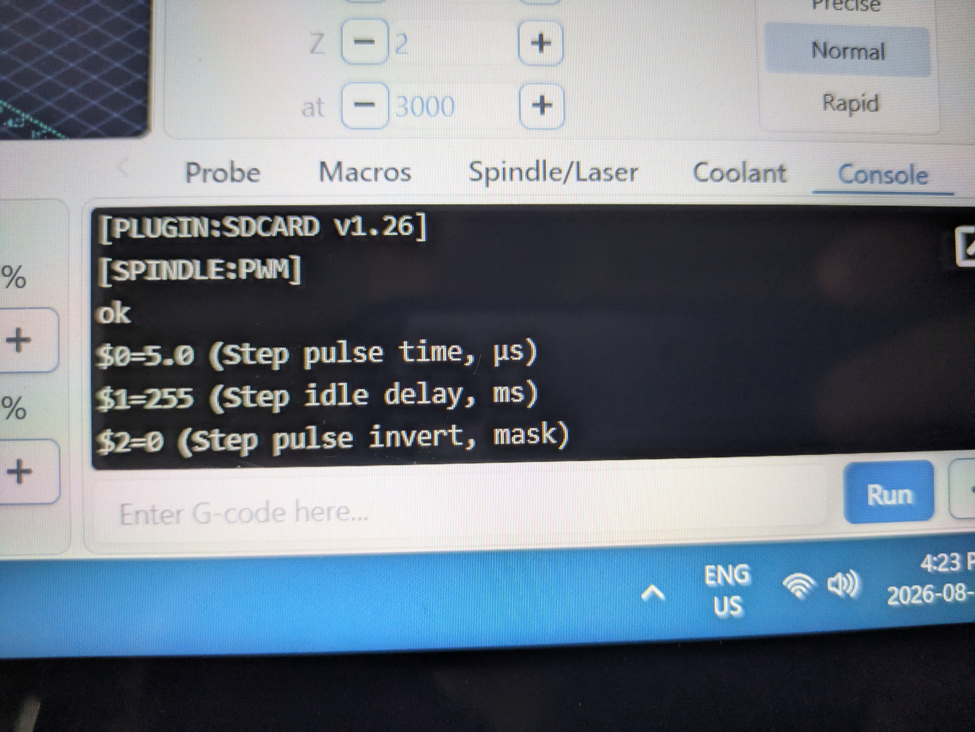

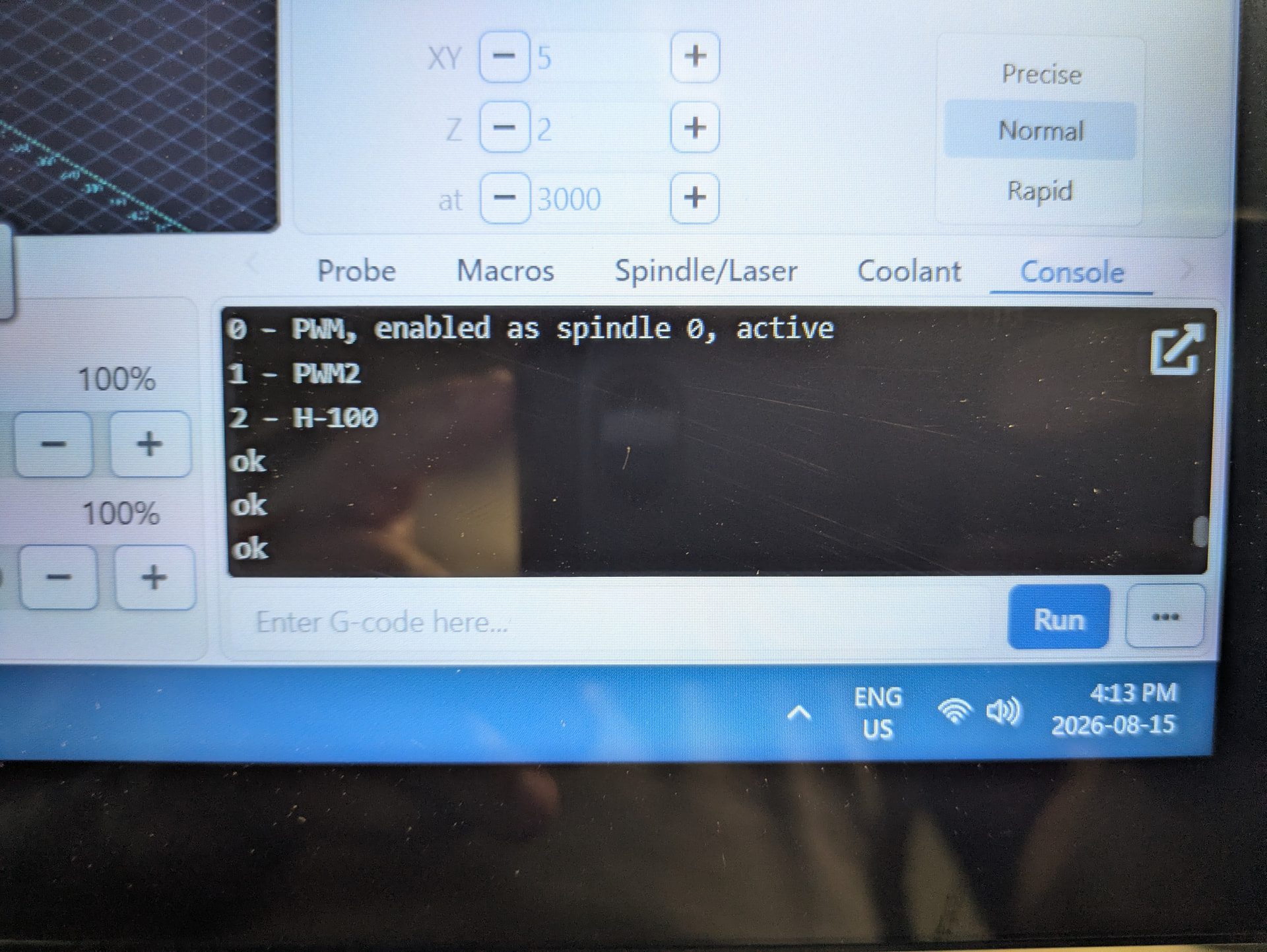

Ran all of the console commands they list. H100 is not spindle 0, PWM is. Ran the Sienci Spindle Configuration (SLB-EXT).gcode. In GSender not seeing H100 in console or spindle.

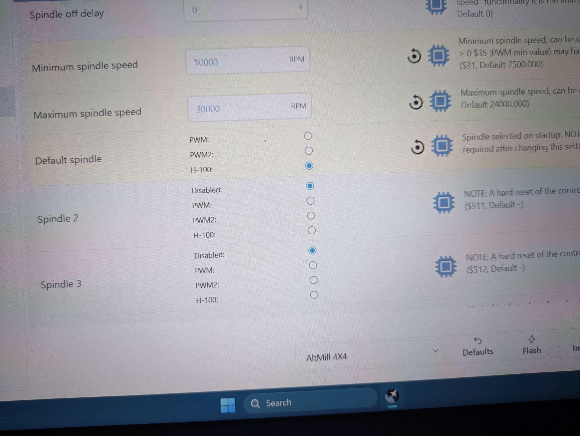

Writing out the issue helped me figure it out. Leaving it here in case anyone else needs to see this. Went into config and set spindle 0 to H100

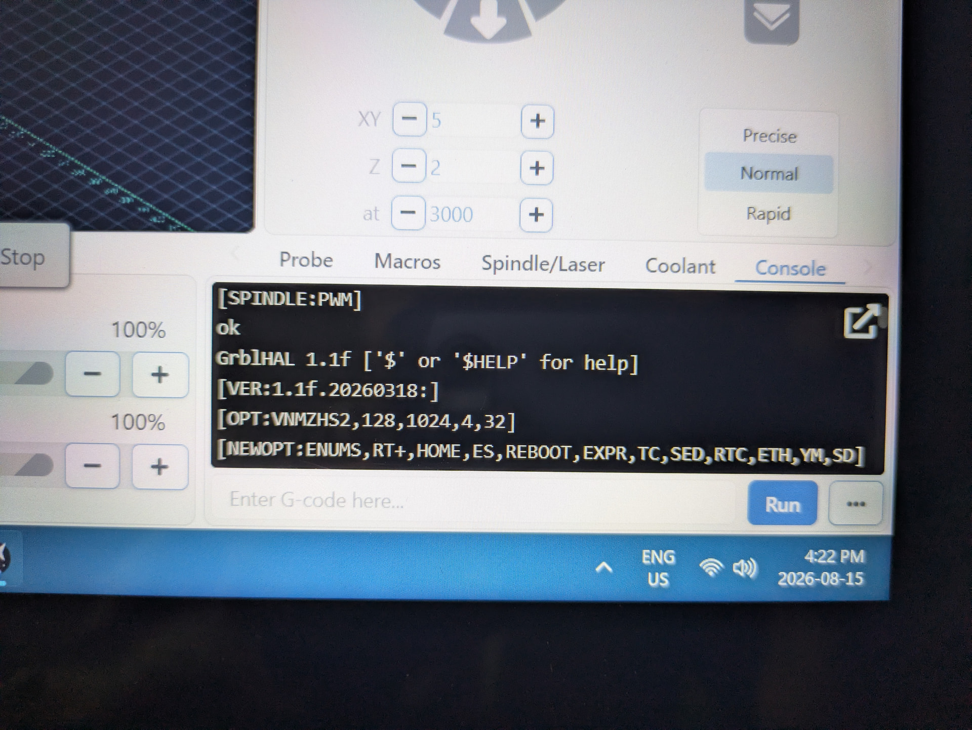

You also are running an older version of the firmware which may have contributed to that issue. Firmware & Flashing - SuperLongBoard
20260525 had some changes related to spindle selection.
